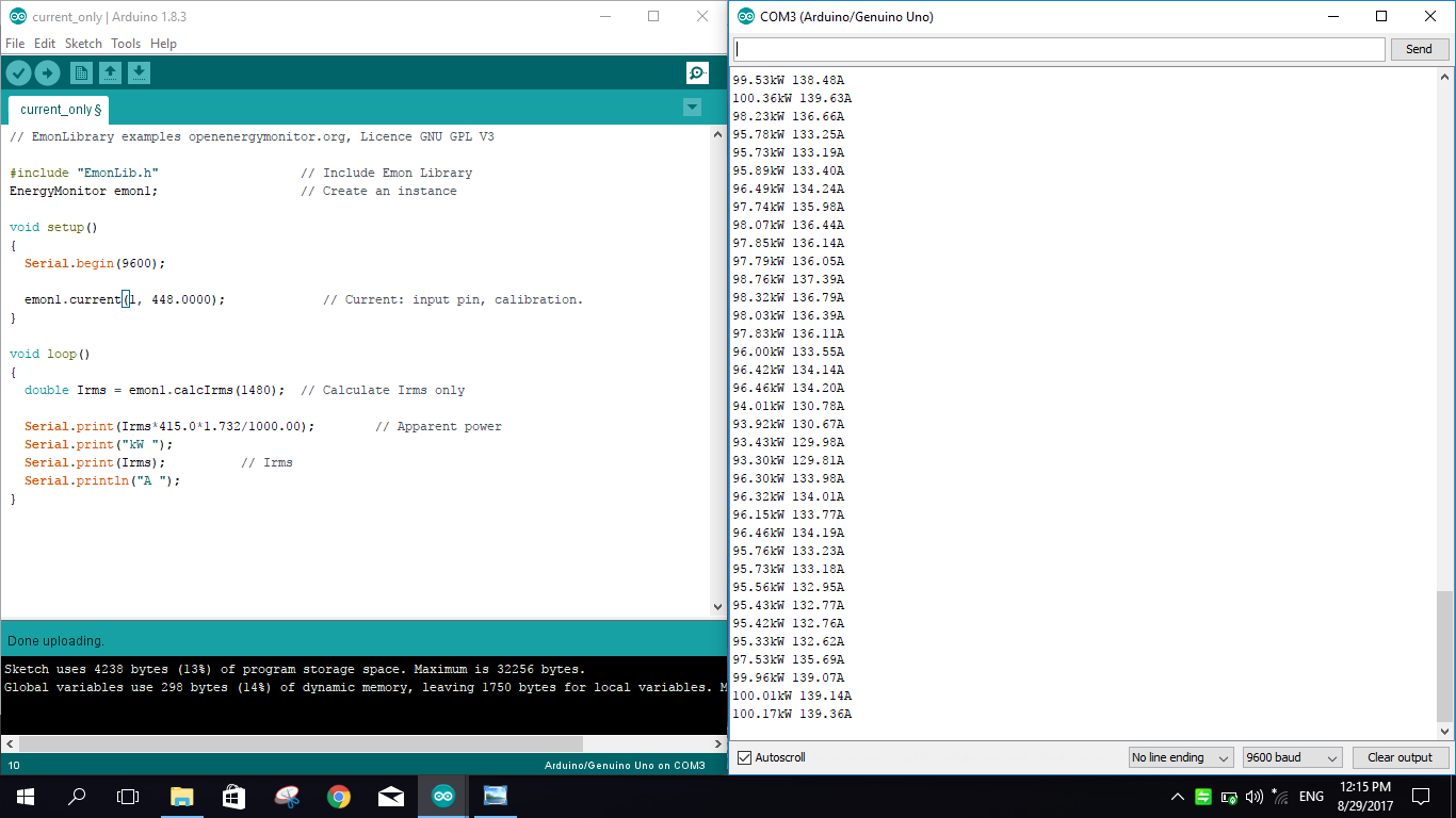

Dear Robert,
Today I went to two sites for verify my Emonlib energy meter.
The measuring current scale one is around 20A scale and another is 200A.
It is quite amazed that the problem of inaccuracy could be the Calibration Value.
Here is how i get the new calibration value…
I compared the realtime result from energy meter with my Arduino and adjust calibration value manually.
The final value I get is 448. Which the Arduino will give the best accuracy on both 20A and 200A scale.
Here is the comparison before and after change the calibration value. After using the new calibration value 448.00, the accuracy is quite high, ranging from 10 A to 200A.
This is some actual site picture show how I acquire the above data:
  1. The meter reading at Site B
  2. The Arduino reading at Site B in the same timing
So, the calibration value of 448 it just a value I created manually. This calibration value somehow show quite acceptable accuracy, therefore I think this is possible to be the correct value.
The next thing I should do is to find a bigger current rating switch board in order to verify the accuracy of this new calibration value at Higher current value say 500A to 800A something.
Any advise from your side?
Thank you very much!
Regards,
Wei
If 448 is the correct calibration constant, then that is what to use.
I would want to check everything that affects calibration, because something, or more likely some things, are not what we think they are. The error - 20% - is probably too big for it to be just one thing that is wrong. There is an article in “Learn” about the errors that can affect calibration, so I would suggest reading that, if you have not done so. The numbers quoted are (mostly) specifically for the emonTx, you might be able to find the appropriate values for your Arduino. You can of course measure very easily the 5 V supply.
