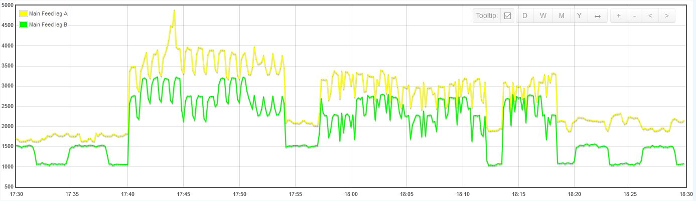

I’ve got everything moved over to the IoTWatt, and now that I have more than four CT ports, I added in the extra SCT013 that I’ve had laying around clipped on the leads for my A/C unit. Later on, I noticed that the A/C was showing some draw in the EmonCMS graphs - peaking at about 16 Watts, but the A/C was off. Looking at the other charts, it looks like that’s when the electric range was on, and the wires for the range are real close to the CT for the A/C, so I’m guessing that the CT was picking up some bleed from the ranges lines. Assuming that’s the case, is there a certain amount of distance needed between the CT and other lines to prevent this? Any other things that might help?

Basically, I noticed some power usage when my wife was cooking in the oven, so I looked closer and found a correlation.
Here is the whole house draw from last night:
Here is the A/C draw from the same time period:
Add in the same thing this morning (just a bit less) when I was cooking my breakfast:

You’ve convinced me that there is noise associated with the oven. I’d like to narrow that down. Looking at the graph, it looks like the oven draws around 2500 - 3000 watts. That seems to be the incremental change in whole house usage. I’d be curious if you have a CT on just the oven, because the sympathetic reading on the AC seems to go to zero when the oven is off, even though the rest of the house is still using a fair bit of power - like 3500 watts.
So, unless there is a CT bringing just that oven usage into the IoTaWatt, i’m thinking it’s not any kind of crosstalk inside the IoTaWatt, as it would probably wouldn’t go to zero while there is still half as much usage on the main.
That leaves the CT and it’s cable. Can you do anything to change the situation and see what happens? Usually in a US panel, the wires are stripped back to the point of entry, so they are accessible at various points. Some panels are neat and others are a ratsnest. Be CAREFUL. better to shut it down rather than have to gingerely nudge things around. REMEMBER, the mains are still live, even when the breaker is off!
So it looks like I got it sorted out. Both the A/C and range breakers are on the same side of the panel, so I did a little untangling and moving. I got the A/C lines untangled so that I was able to place the CT higher up in the panel and a bit cleaner than it was before, and I moved the breaker for the range down to a spot that I had a 240v breaker that is not doing anything (and in the process I made an interesting discovery - one of the lines for the range was loose and popped out of the breaker when I removed it! Looks like it had been that way for a while and had gotten a tad warm. Maybe that’s why the old stove would trip the breaker when we used the broiler!). After doing this and firing up the stove, not a peep from the A/C feed. So it must have been due to the way the CT was clipped over the lines for the A/C along with the proximity to the lines for the stove.
