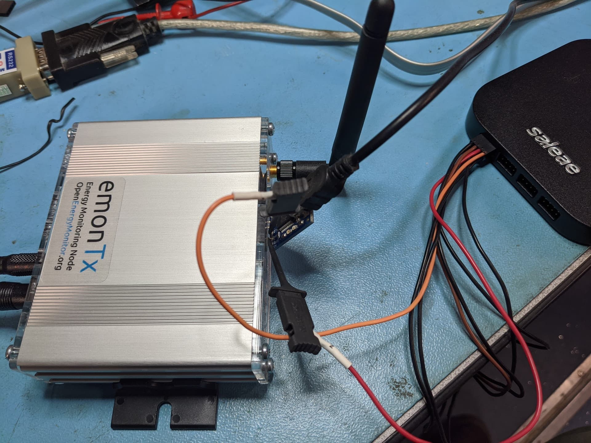

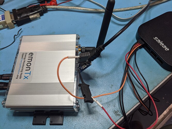

Ok. I moved my emontxv3 into the lab and connected my logic analyzer.
The code definitely does not respond to “\r\n”. It does however respond to “\n”:
You can see the bottom channel (3) are the keystrokes I’m sending to the emontxv3. The data listing on the right shows that I sent a 0x6c (‘l’) at 40.471s, and then a 0x0a (‘^J’) at 40.877 and you can subsequently see on channel 2 that I got a ‘blob’ of settings info just before 41s.
You can see I attempted l\r\n a number of times, as well as l\n\r. I also tried l\r which of course didn’t work.
Anyway, that’s the smoking gun right there.
Armed with that information, I was able to do “c1\n” and it’s now spewing more data:
