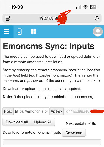

The second issue I need help with is how to get the data which is being captured with my local pi to go to emoncms.org so I can start contributing top open energy monitor. I have provided the r/w api key of my online account to my local emoncms, but when I go to inputs there is nothing showing.

For the syncing with online, on the emoncms installed on my pi, I log into it via the pi’s ip address, sync - sync inputs and have the r/w api key for my emoncms.org account.
It would be worth updating your emoncms install and getting the latest sync module, you can then authenticate with an emoncms.org username and password as well as the apikey and the functionality is better. You should be able to update from the Admin > Update page.
Perfect the update has worked. Just waiting for the information I’ve uploaded on heatpumpmonitor.org to be reviewed.
