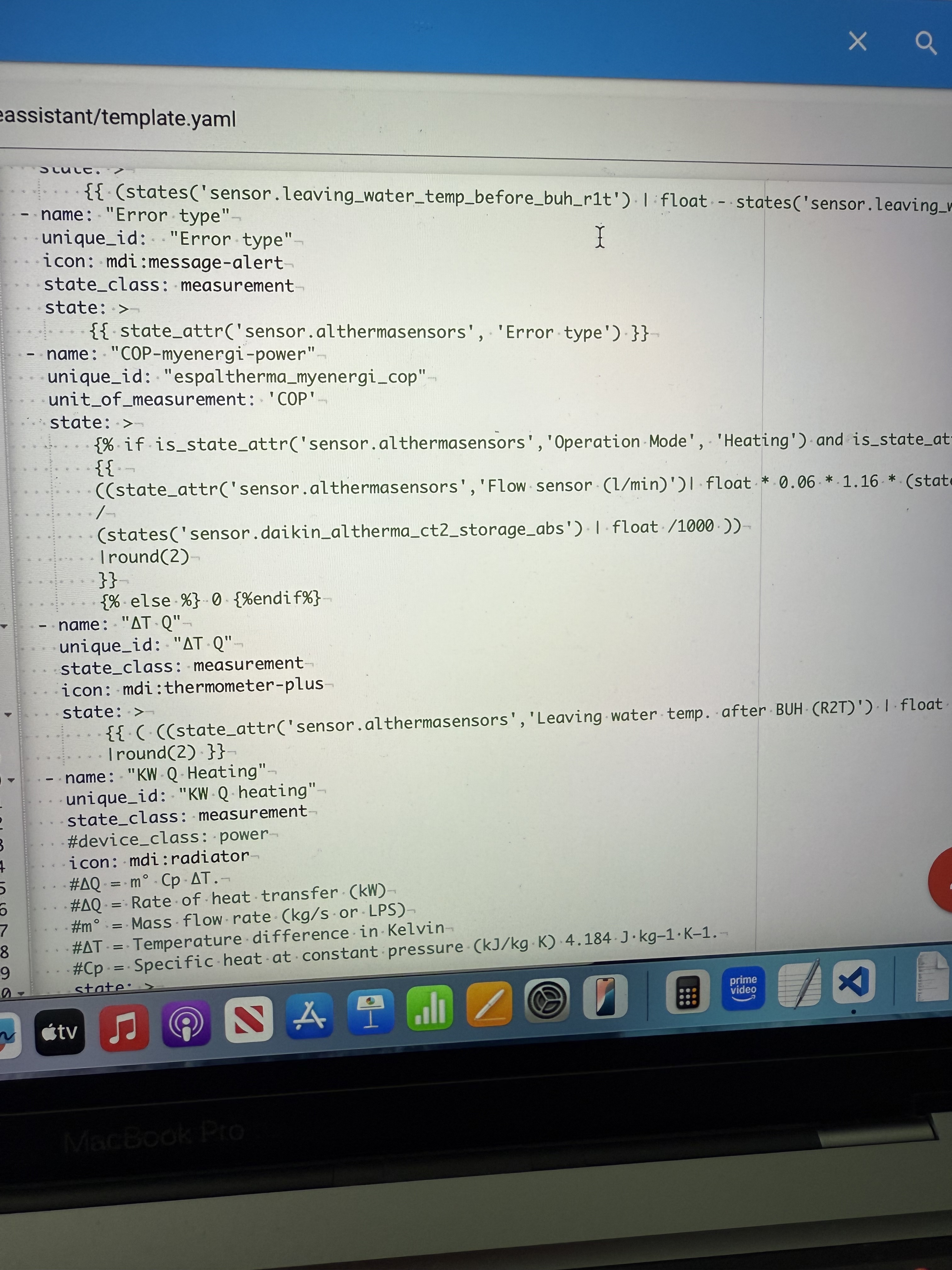

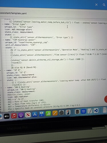

Hi I have recently set up esp altherma and all is working correctly except cop is always 0. Also pretty new to home assistant so I am still learning.
Have I done something wrong with programming of cop in the yaml file? See attached screen shots.

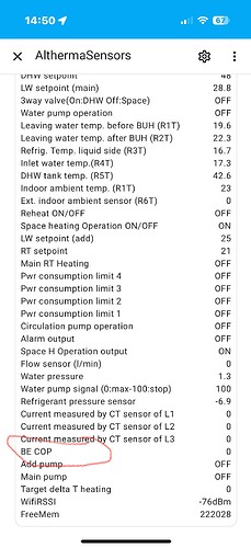

Hi it’s just the Be cop that I am trying to get working. I thought this is direct from heat pump but only when running, I remember in commenting it on python before loading esp32 with file.
Not familiar with BE_COP what does it indicate?
I see that. I hadn’t noticed it before. There isn’t any documentation about the source or relative accuracy of that data point. The only method I can see on the ESPAltherma Wiki is here, which provides the following YAML:
- name: "COP"
unique_id: "espaltherma_cop"
unit_of_measurement: 'COP'
state: "{% if is_state_attr('sensor.althermasensors','Operation Mode', 'Heating') and is_state_attr('sensor.althermasensors','Freeze Protection', 'OFF') %}
((state_attr('sensor.althermasensors','Flow sensor (l/min)')| float * 0.06 * 1.16 * (state_attr('sensor.althermasensors','Leaving water temp. before BUH (R1T)') | float - state_attr('sensor.althermasensors','Inlet water temp.(R4T)')|float) )
(state_attr('sensor.althermasensors','INV primary current (A)') | float * state_attr('sensor.althermasensors','Voltage (N-phase) (V)')|float / 1000))
|round(2)
{% else %} 0 {%endif%}"
which looks like the YAML you have in the photos. That should work and produce a sensor “COP”, which is quite different from the nominal “BE_COP” in the header file. The YAML says it only produces a value when running when “Operation Mode” is “Heating”, so if you’re not at the moment, it won’t have a value.
