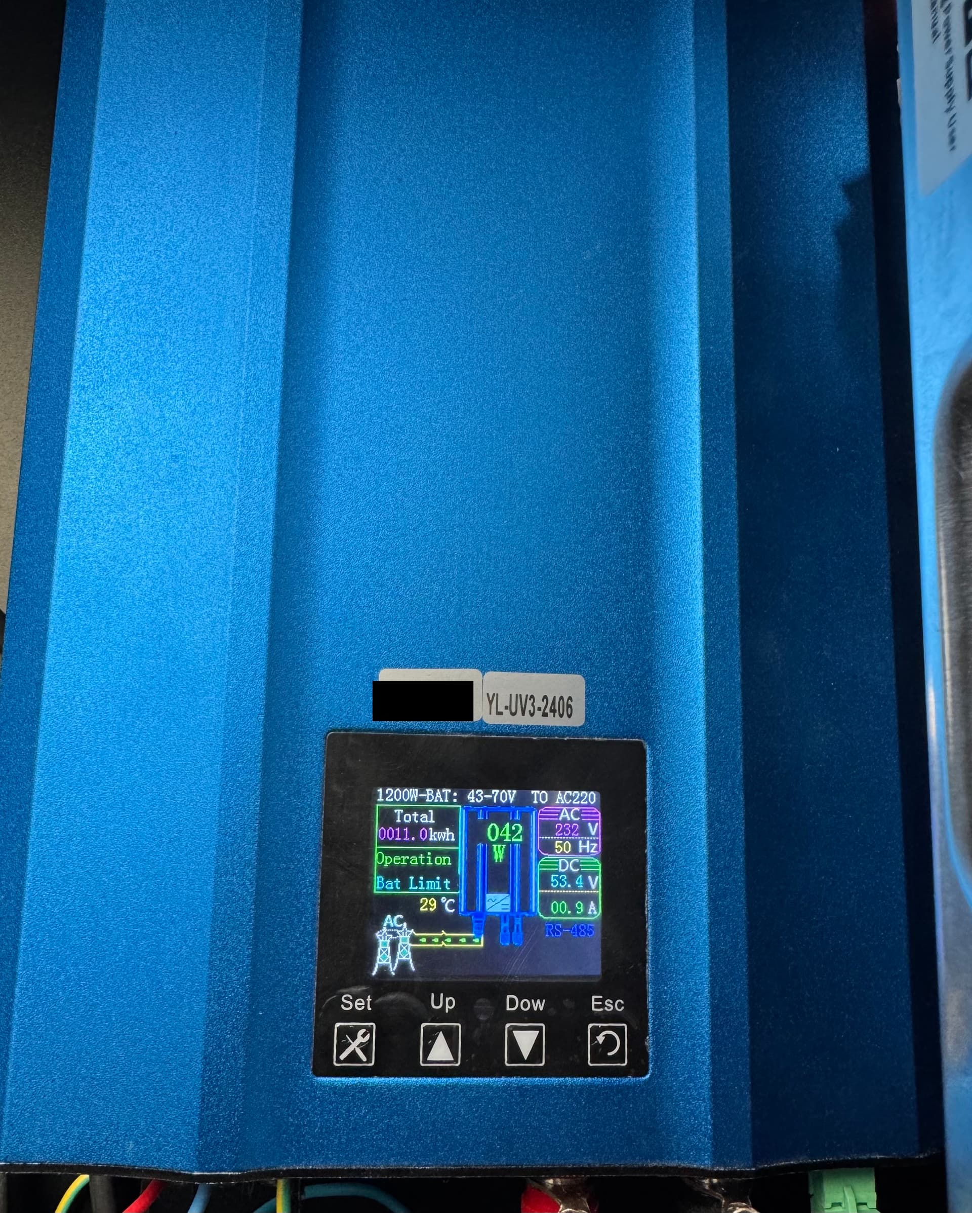

Hi—sorry for my English, and I’m not sure this is the right category.
I’ve been experimenting with controlling the YL-UV3-2406 inverter (with the limiter port) (lcd firmware: STC08-2403 / cpu ver-3.1-2403). the blue one from chinese famous website “TINGEN GTN”
Below is an Arduino/ESP32 sketch and notes for simulating the limiter over the RS485 port using an ESP32 + MAX485 transceiver.
Mods: please feel free to move or edit the post if needed.
In my tests the program works from 0 to ~900 W.
TECHNICAL NOTICE + CODE (ESP32 + MAX485)
Control a YL-UV3-2406 inverter via “Limiter” RS485 — 0..~900 W

4) FRAME FORMAT (8 bytes)
[0]  [1]  [2]  [3]  [4]  [5]  [6]  [7]
 24   56   00  CMD   G    X    M    CS
- Prefix: 24 56 00
- CMD: 0x22 → direct 0..255 W   |   0x21 → tiered >~255 W
- G:   tier/gain (depends on CMD)
- X:   value (depends on CMD/G)
- M:   0x80 (observed)
- CS:  checksum (see #5)
5) CHECKSUM RULE (MANDATORY)
Sum of all bytes modulo 256 must equal 0x23.
CS = (0x23 − ((byte0 + … + byte6) & 0xFF)) & 0xFF
Example (0x22, 100 W): 24 56 00 22 00 64 80 A3
6) COMMANDS & MAPPING (confirmed by measurements)
A) CMD 0x22 — direct 0..255 W
   24 56 00 22 00 [PW] 80 [CS]
   Examples: 0W→… 00 80 07 | 25W→… 19 80 EE | 50W→… 32 80 D5
             100W→… 64 80 A3 | 150W→… 96 80 71 | 200W→… C8 80 3F | 255W→… FF 80 08
B) CMD 0x21 — tiered ranges for >~255 W
   24 56 00 21 [G] [X] 80 [CS]
   Observed:
   - G=0x01 → ~256..~499 W, linear:      W ≈ 256 + 0.93 * X
   - G=0x02 → ~500..~640 W, base≈500,    slope≈1.00 W/step
   - G=0x03 → ~650..~850 W, base≈750,    slope≈1.20 W/step
   - G=0x04 → ~860..~900 W, base≈880,    slope≈1.00 W/step
   - G=0x05 → saturates ≈900 W
   Example (300 W): X≈(300−256)/0.93≈47 → 24 56 00 21 01 2C 80 DB
Notes: Display varies slightly with mains (e.g., 226–233 V). For 300–499 W keep G=0x01.
Above ~900 W a cap is observed.

A precision:
A is on the left when you are in front of the panel, B is on the right
