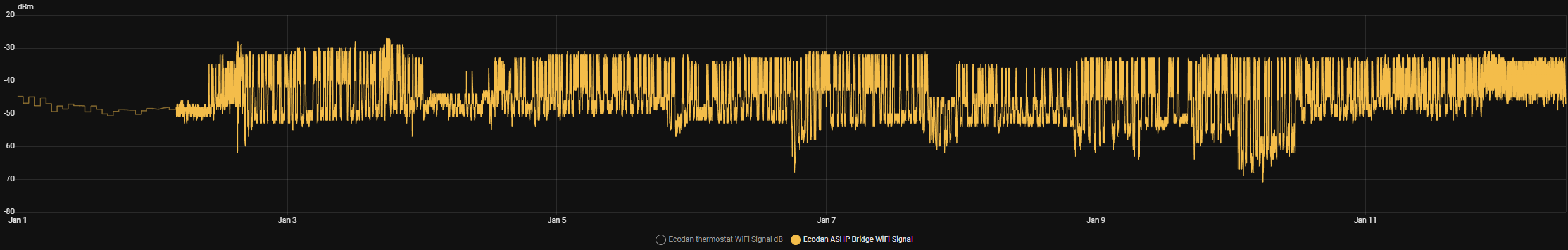

you cannot flash a factory over http. It needs to be done via usb. So your partition layout is still not correct, you need to do a factory flash once. The pin usage is set for the atom s3 lite, you need to wire the correct pins.
you can only adjust the wifi by changing yaml, WiFi Component - ESPHome - Smart Home Made Simple

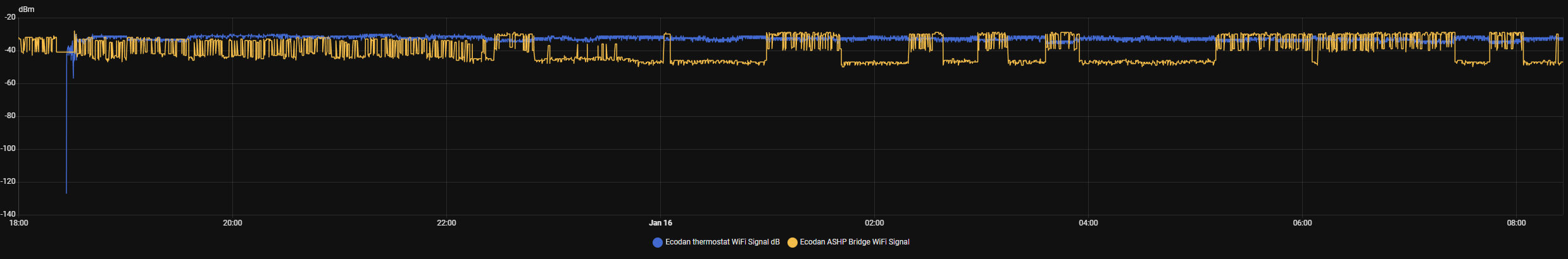

Are you running a board in the same batch (ordered at the same time?) as the cn105? You could have a bad one.
Your wifi strength plot was not really good tbh.
I know, did first over USB and next one OTA.
They are different boards, both ESP32-S3, had them laying around.
CNRF
CN105
Don’t think it’s bad.. Device is inside hydrobox also.
-30 dBm: This is the maximum signal strength. If you have this measurement, you are likely standing right next to the access point.
-50 dBm: This is considered an excellent signal strength.
-60 dBm: This is a good signal strength.
-67 dBm: This is a reliable signal strength. This is the minimum for any online services that require a reliable connection and Wi-Fi signal strength.
-70 dBm: This is not a strong signal strength. You may be able to check your email.
-80 dBm: This is an unreliable signal strength.
Can this be done only, when compiling or this can be changed in HA also somehow?

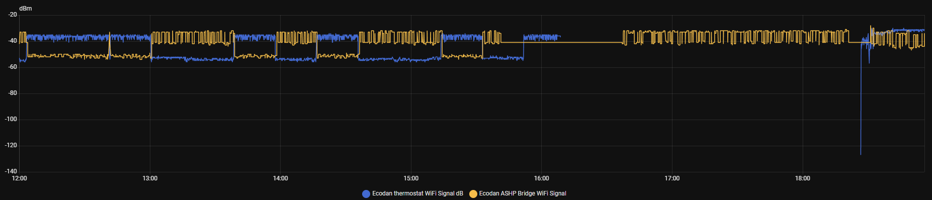

your graph clearly shows signal strength ranging from -80 to -55
Yeah, those are erratic situations when the connection fails I think, most of the days it’s stable around -60dB.

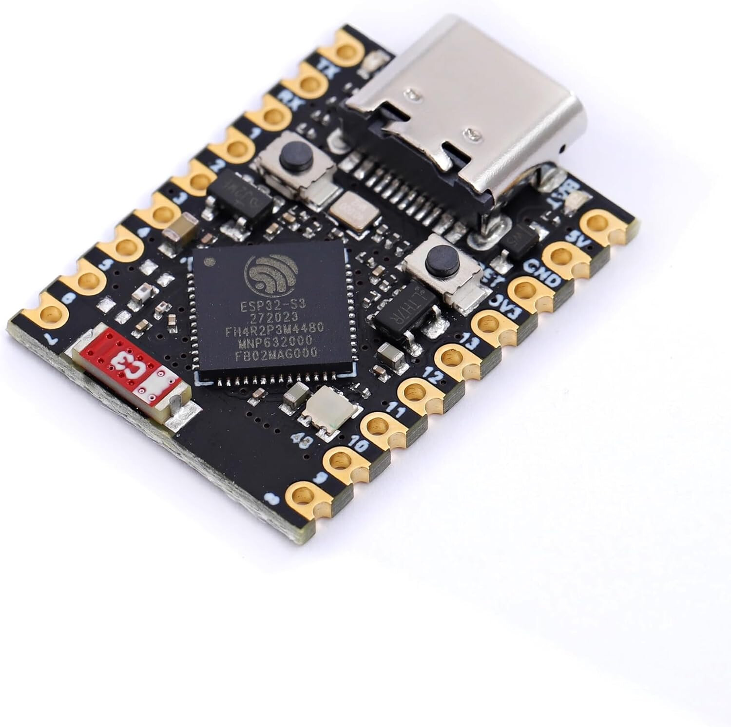

ESP TX power issues from bad/cheap devices. Chip might be legit but flawed antenna designs are mostly the issues for that and remedy is to lower TX power. Adding additional capacitor to power input of ESP didn’t help.

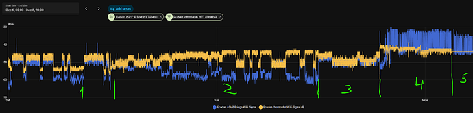

Found my wifi “jammer”. It is MySensors nRF24L01 PA LNA (low TX power enabled) gateway/module on rasperri Pi that was close to router.
  1. As it was from beginning
  2. Tried a antenna mod ESP32-S3-Zero Antenna Modification | Peter's electric trick and electronic blog . Interesing behaviour, guess it didn’t help overall, since router is close/2m.
  3. switched off nRF gateway service and wifi returned normal.
  4. switched nRF service back on and in about an hour later moved wifi router 0,5m from nRF.
  5. CNRF gateway offline at 3 am, that’s the time my wifi router auto restarts and after that CNRF can’t connect to it :slightly_frowning_face:

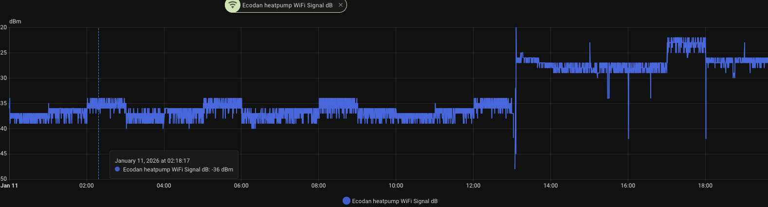

At least currently no disconnections:
Did you try putting the atom outside the unit ?
I was also testing the asgard board and wifi seems to improve a bit. But then again I never had any disconnect issues from the atom (mines came from digikey).
You can see when I installed the new board, but differences are small.
Both of the devices are right on top of the unit.
Haven’t had also in a few weeks time.
As I said before, the disconnection issue was related to the other ESP32-S3 module I bought from ALi:
Guess I spoke too soon…

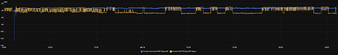

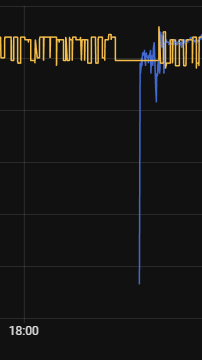

Wifi signals at that time
Anyways after resetting m5 from side button, it came back online. What’s odd is that CN105 device lost connection to wifi about that time the m5 got online. That’s first time that has happened.

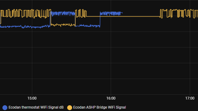

Had devices side by side, now I’ve moved them away from each other about half a meter. Will check wifi log later.
E: So overnight it was all good on m5, guess the one to blame is that s3 dev board on CN105, gonna replace it also with m5.

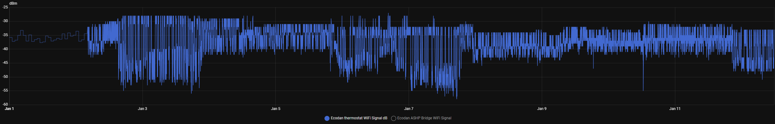

Finally changed on 17th around 21-22 the CN105 esp32-s3 dev to atom m5 and switched off my nrf24 devices. On 18th around 10 I’ve turned back on NRF24 devices and slight interference started. Both atoms are on top of HP. Can’t find the reason for this occasional higher/lower signal fluxuations over night. Signals won’t match with compressor and can’t think of anything else disturbing it. But for now it’s a lot better than it was at first.
“ESPHome 2026.1.0 delivers one of the most requested features: automatic WiFi roaming. Devices now switch to better access points after connecting, solving the problem of devices getting stuck on distant APs after power outages or AP reboots.”
Try upgrading to 2026 and see if it improves.
