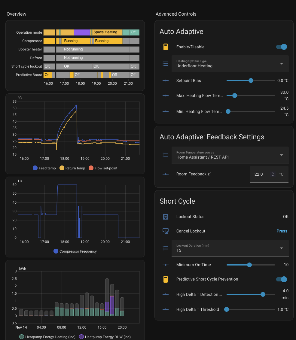

Use the simulator to see how the engine works and what flow it will select. Also keep in mind that it also takes the outside temp into account. If its colder ā it will use a higher flow temp.
Let me know if you have any questions, and I will be happy to answer them (here or on my github)
I have been using AA for the last 3 weeks and for me it has great. I also support complex setups with mixing tanks, multi zones, has anti-cycling handling, defrost handling, ā¦
Read more into the setpoint bias, it allows you to optimize for cost very elegantly.
Use the example dashboard to control/monitor all options

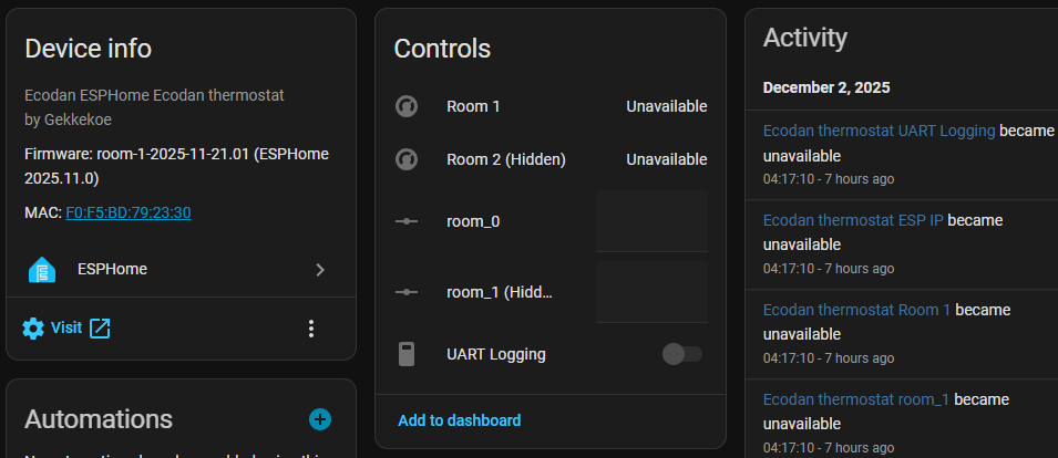

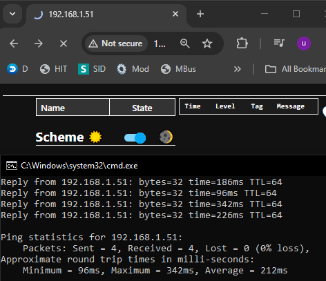

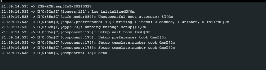

Having intermittent connectivity issues, device suddenly stops responding to curl posting and web UI isnāt accessible. Last evening I connected to device using usb serial and thatās all it printed out. Last time it did that was about 4 days ago.
After power cycle it started up without issue and all was accessible, but now itās yet again unavailable:
Responds to ping, but UI isnāt loading
Using only zone 1, Firmware: room-1-2025-11-21.01 (ESPHome 2025.11.0)
Itās seems to receive the posted curl, but not always, since iāve got a script made in domoticz that checks response and if thereās no response 3 times, it switches to compensation curve mode.

Maybe itās the device itself that might act up?
Iām using this device with low-level converter from Ali. Uploaded via esphome.io web interface if I remember correctly.

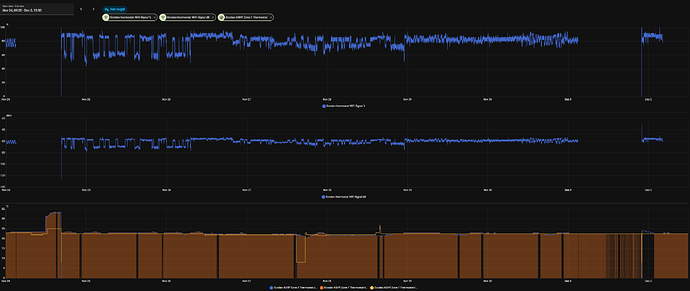

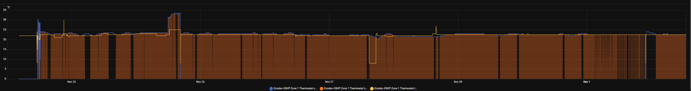

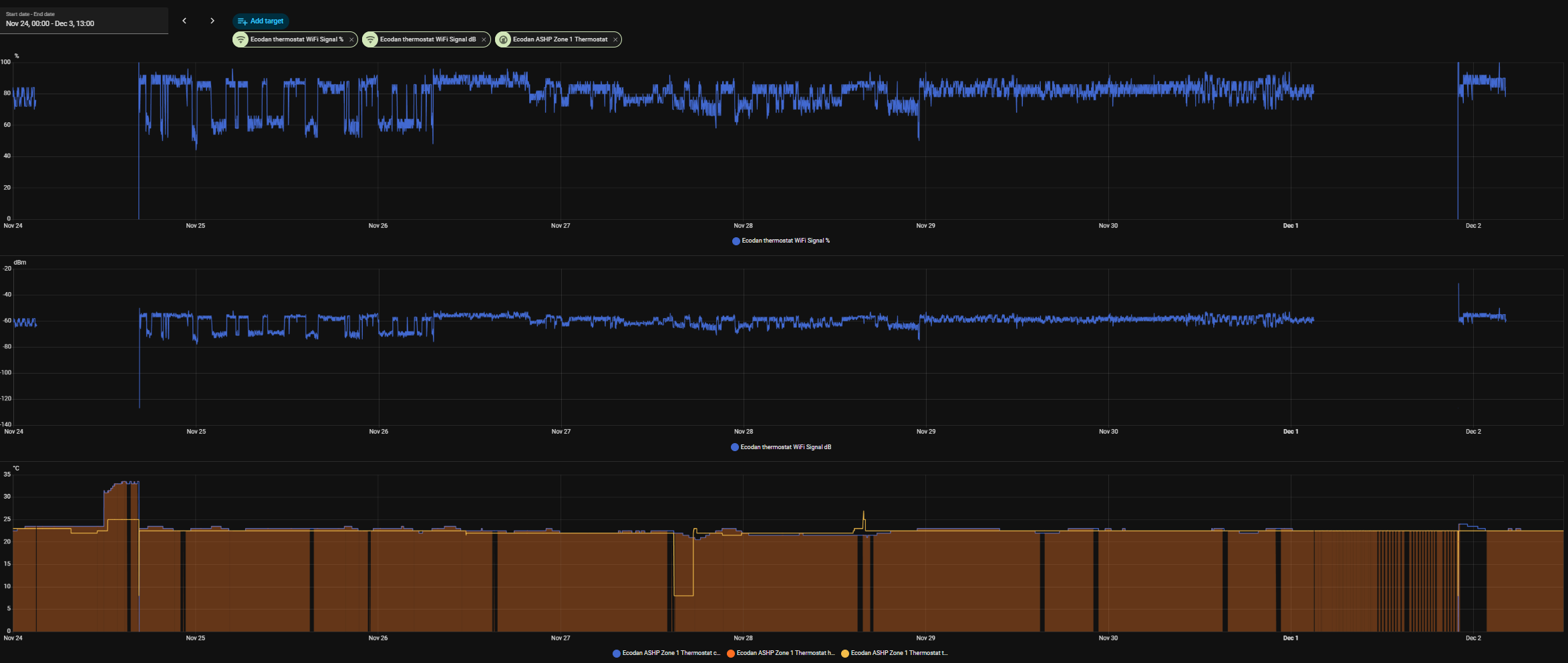

Wifi signal is ok, sharp yellow dip is where the setpoint goes to 8C
this did hot happen with previous firmware?
I did not limit current temp when sync, so that might need to be added and maybe reboot button. But I did run this for a while with an atom s3 lite, and never had connectivity issues.
When did it started after upgrading to latest esphome ?
This is the only release iāve tried. Gonna try previous (room-1-2025-11-16.01) release in the evening and let you know if anything happens over the days.
Iāve set it up on 22.nov and since then it has happened 3 times.
the min I know, but you can easily fix it in the sync code, do max(current_temp, 10) before sending it to the cnrf. I will put it in cnrf later,
I just pushed a new build which will remember previous value on boot, so that would avoid the 8c drop after the first time. But you should really fix the network connectivity.
When I got home the WebUI was reachable again, uploaded previous build.
My home network doesnāt have any connection issues, CN105 is with F1P v6.3.5 with this board from ali and works flawlessly. After googling a bit I think itās the S3/C3 super-mini board issue, weāll see over time. Some solution was for that to reduce wifi transmission power.

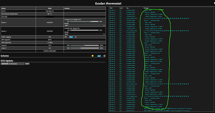

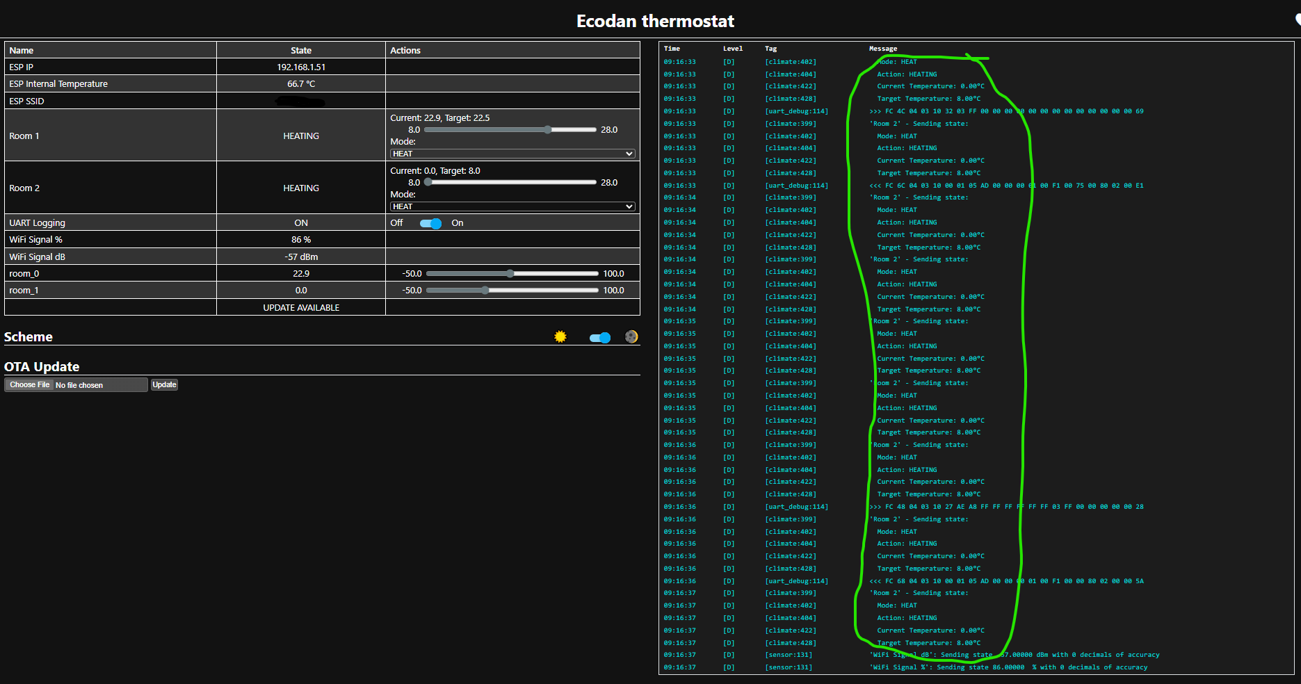

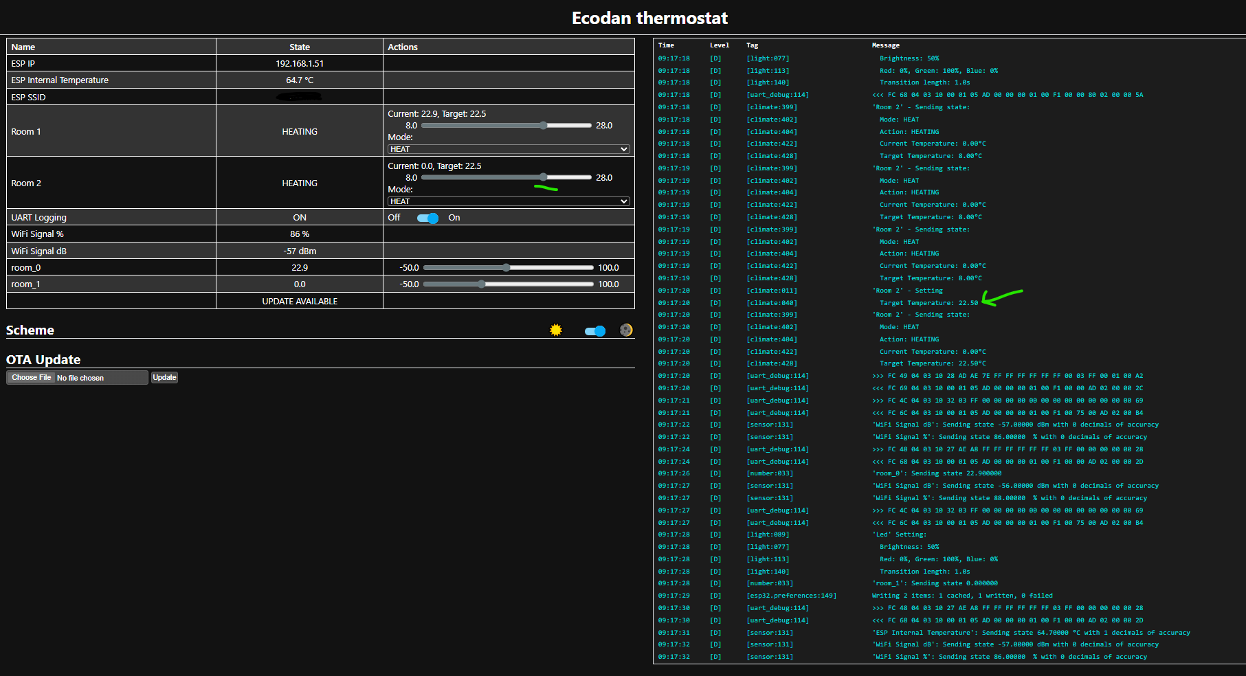

Also what Iāve noticed, that if the second room setpoint isnāt set, it spams nonstop on room2
When setpoint is set, it runs normal
Maybe Itās the 8C issue where heatpump min is actually 10.
E: just did a test and spamming stops as soon as the setpoint 2 changes, even to 8.5.

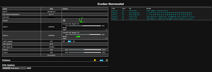

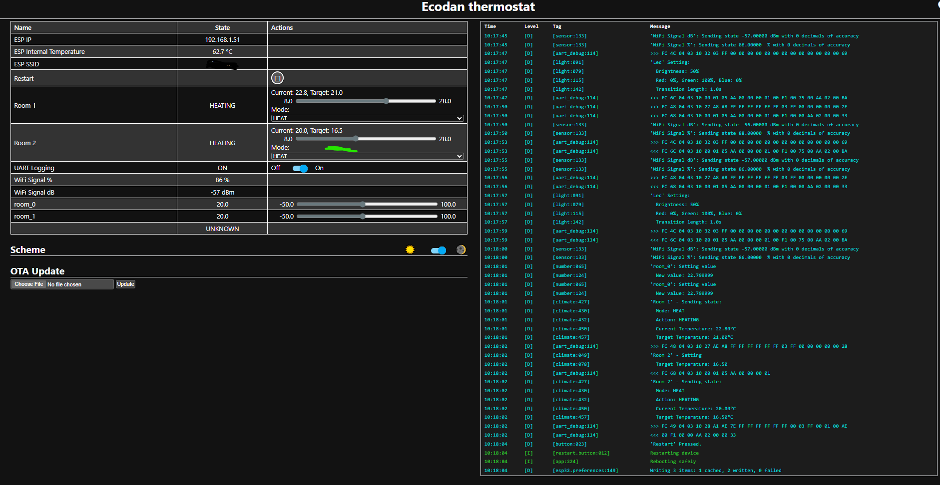

E2: tested latest release and spamming is gone, although there is some mixup in remembering setpoint.
At first:
Setpoints are changing positions after reboot:
if you donāt have 2 rooms, just donāt enable room 2 via yaml? I mean it is disabled by default, and you had to turn it on.
Regarding memory for previous current temp, it restores the last saved to prevent starting with 0 (8c). It only saves 0.5 values (what is actually sent over CNRF), so if you are setting current value of 19.2, then 19.0 is sent over CNRF and remembered.
your trigger should sync the correct value when it notice it has been changed.
As for setpoint, my setpoint are restored properly. Did you set it up correctly ? This can only happen when you messed up the identifiers. It should look like this:

But your issue seems to be connectivity that is causing this, I suggest using an atom s3 lite

the binaries are only for the atom s3 lite boards. If you run a different board it will for sure not work. Now I also understand the reboot issue. You probably used an OTA binary and it did not create the partitions correctly to store values.
Iām surprised it did something. If you run your own hardware, you need to compile yourself.
If you want mqtt in esphome, then you need to configure it
and disable the HA api.
