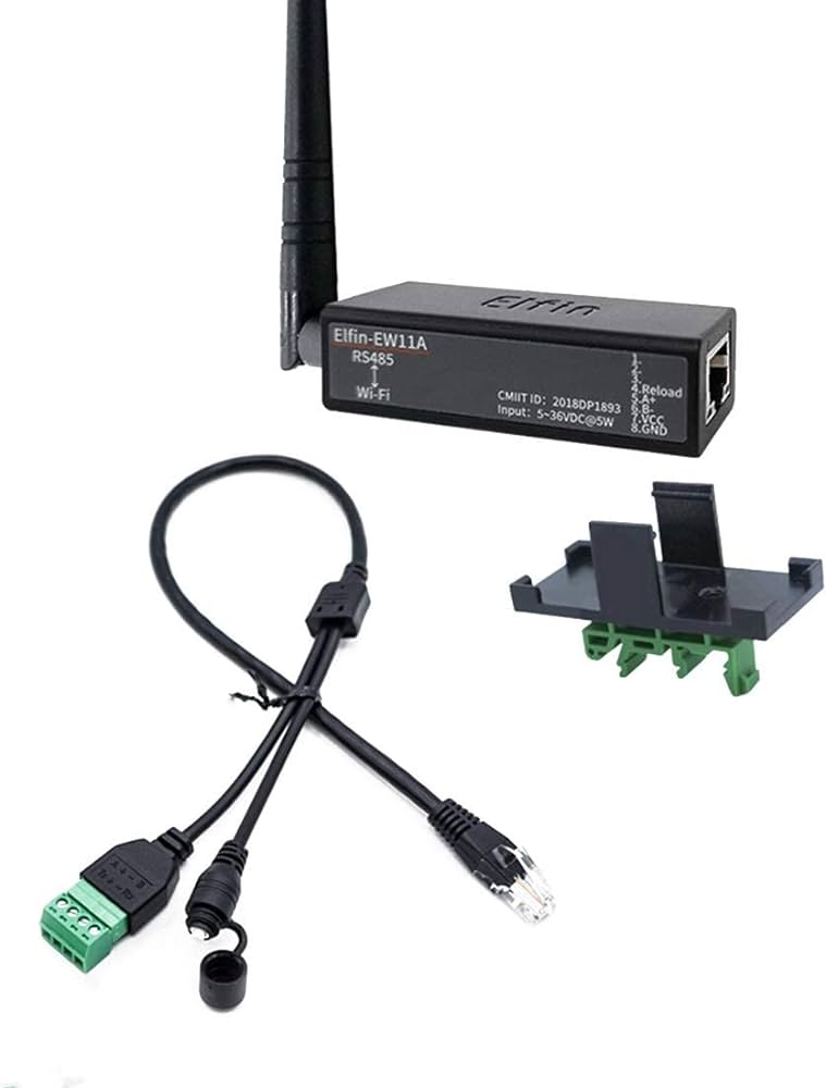

Connect another HP over MQTT with Elfin-EW11-WiFi to RS485
I’m working on a project to integrate a new heat pump model with Open Energy Monitor for data logging and analysis using MQTT.
Does anyone know in which file (if any) I can typically find settings related to the Modbus registry for different heat pump model?
Has anyone integrated a heat pump using MQTT with Open Energy Monitor? Are there any specific guides or resources I should be aware of for this approach?
Any advice on efficiently mapping the Modbus data points to corresponding data fields in Open Energy Monitor?
