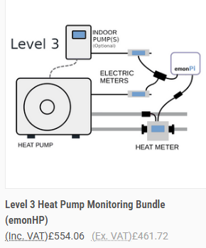

I can see in the shop at least 2 kits, but because there are no electric clamps needed I’m a bit confused.

Do you mean current transformers?
Why do you need them? You are already measuring your electricity consumption, you do not have an air-to-water heat pump so you are not interested in the ratio of heat out to electricity consumed by this. And in any case, you cannot easily measure the performance of your air-to-air heat pumps.
All you need to measure is the flow of hot water and the temperature difference between the water coming into your part of the building and the temperature of the water leaving.
Their problem. The landlord agreed for us to pay what we consume, if we can measure.
If they aren’t happy, they can pay one heat meter also :smiley:
I don’t need the current transformers, but the kits I see have them, that’s why I’m confused.
You can unselect the electricity meter in the options. And yes easy to use from HA.
As I wrote, the kit is designed for an air-to-water heat pump, and to be able to compute the efficiency, and hence be able to adjust the settings for optimum comfort, or cost (or both?) you need to know the electricity consumed, both by the heat pump itself and any circulating pumps.

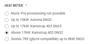

Now that I looked at them :slight_smile: I see different options for heat meters.
I imagine I will need the bigger one, no? my tubes are DN50 :grin:
You probably need to find what the rating of the boiler is, either in kW or litres/minute (or both), then estimate what you need from knowing this.

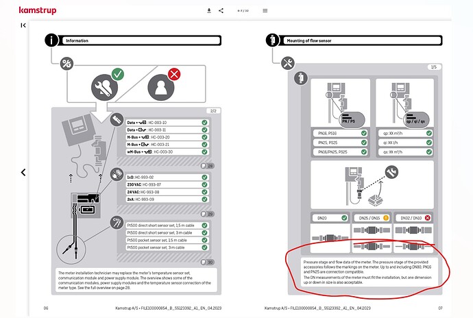

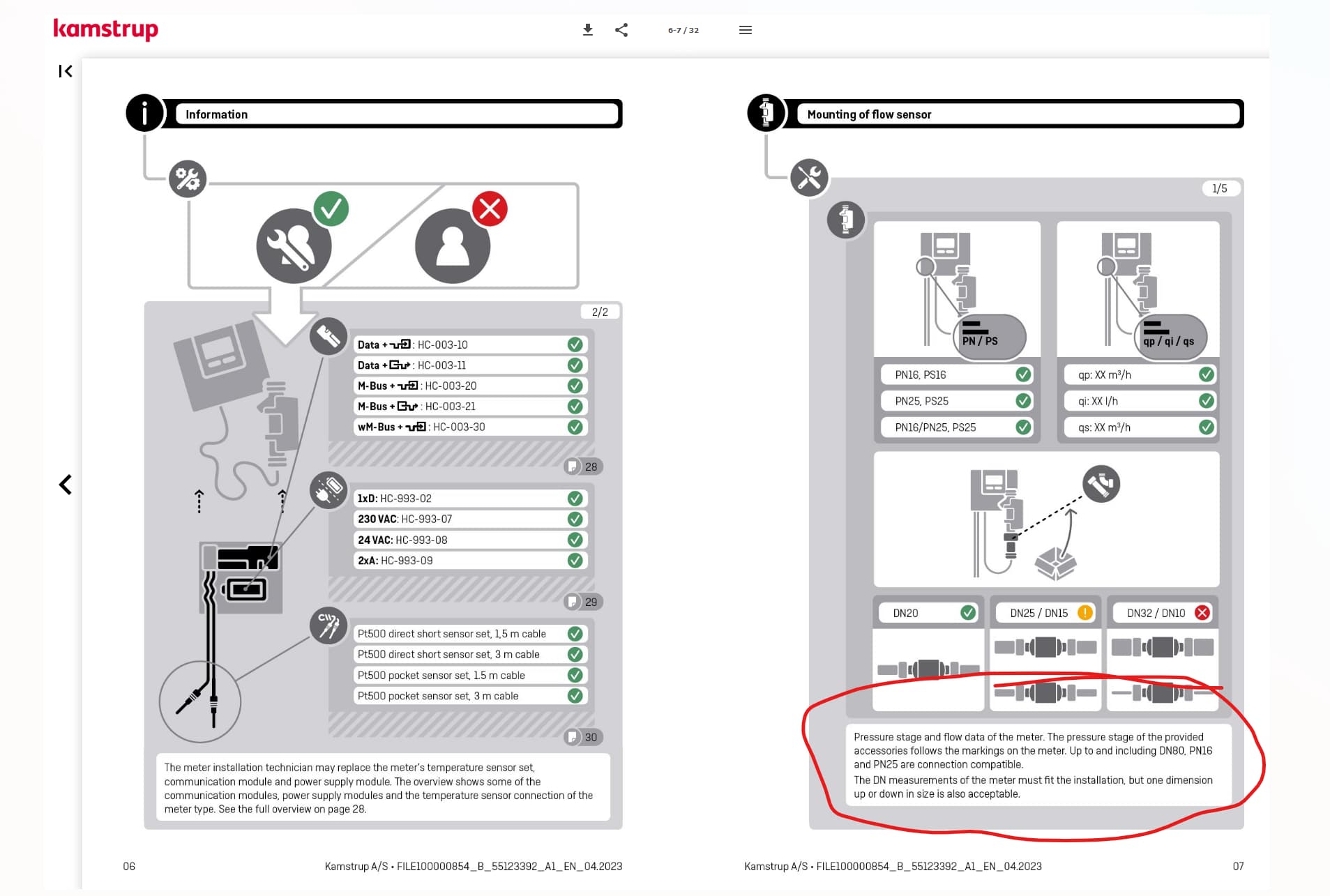

But the largest heat meter in the OEM Shop has DN20 or DN32 fittings (only 16% or 41% of the area, depending on which part of the page you look at!) so I think the pressure drop across this heat meter would be too high. However, downloading the Kamstrup data sheet shows a version with DN50 fittings is available, so you should investigate this. Meanwhile, @TrystanLea, will our heat meter work with to DN50 option of the Kamstrup Multical 403? I assume connections and data format will be the same, what about numerical overflow etc? And if @Oinq needs to order it directly, which options?

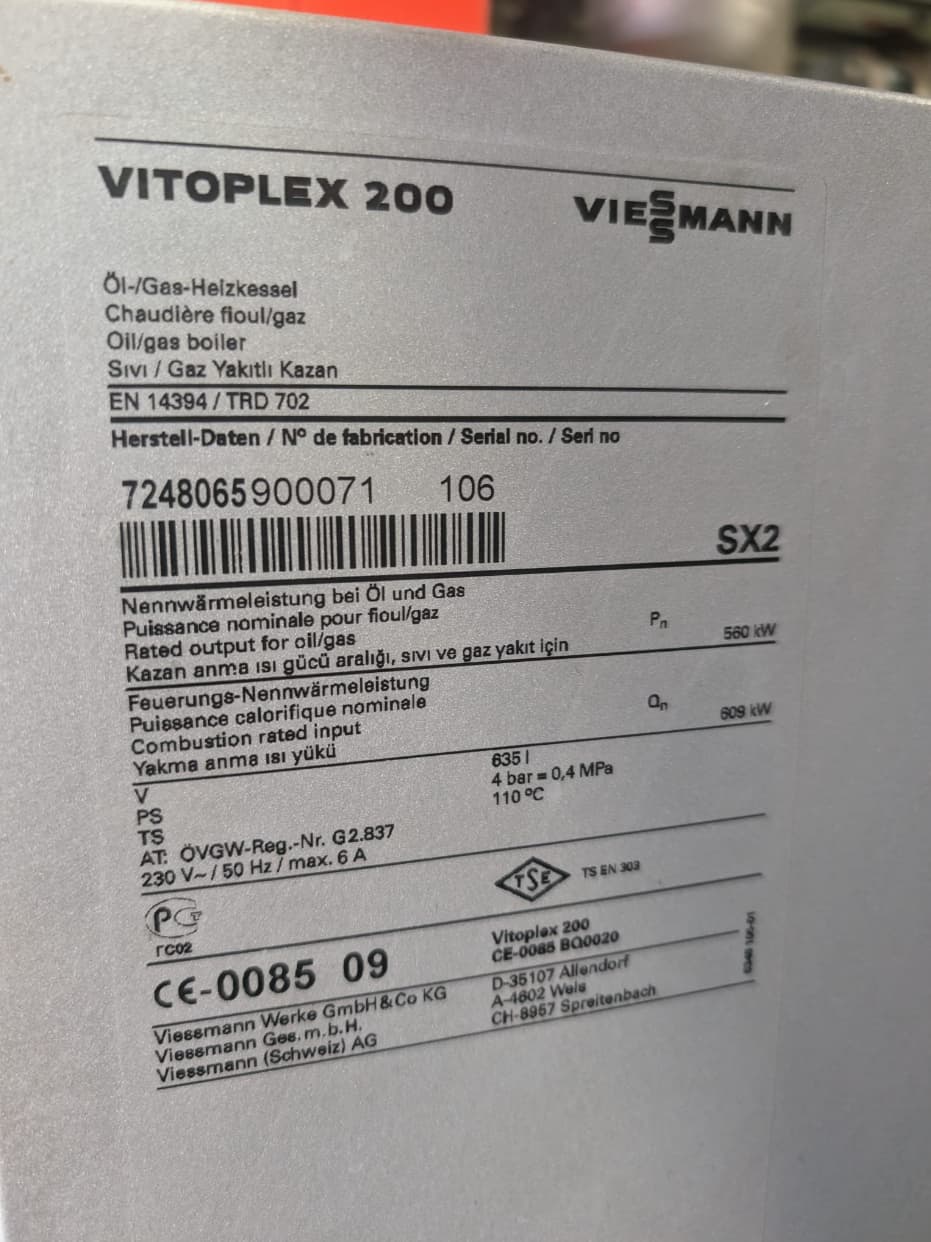

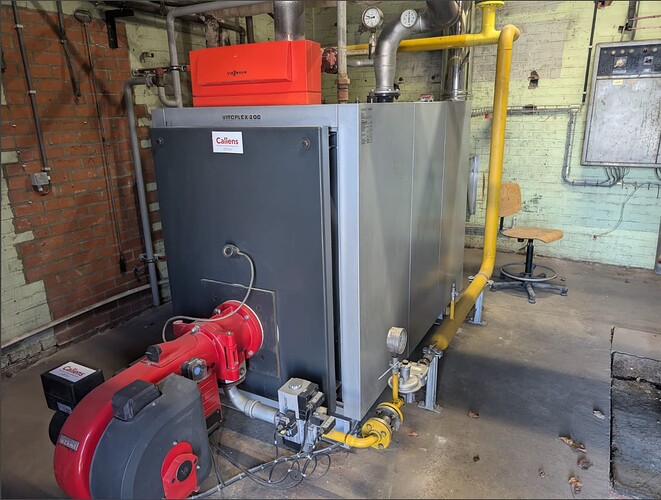

Here is the big boy
560kW if I see correctly? This used to warm a full factory, now it warms 30 radiators in offices…
It’s definitely in our favour, push that (in)efficiency to their side :innocent:
There are several outputs on this room, the majority of them closed because we don’t feed the big factory building anymore. The majority of the radiators in the factory was removed.
I see 3 pairs of tubes coming to the “newer” side of the building. One is probably the douches from the factory, the other 2 for the offices which were build in 2 phases. We are phase 2, the other company is phase 1. Much probably, reducing it will only impact our radiators, which we almost no use anyway

If a DN50 heat meter exists, it’s better to use it. Now, software wise this also needs to work. I don’t believe this will be a problem?
