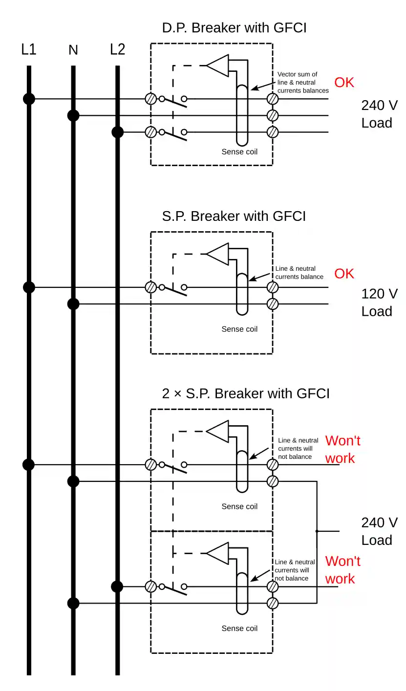

(North America?) I was installing the emonVs wired directly to the panel. I needed two breakers and happened to have two GFCI breakers. I wired it correctly. When I turned on the second breaker, it tripped. I didn’t try various combinations of which break I turned on first because I’m not a big fan of being around breakers that are tripping (or people, for that matter :wink: ) I replaced them with two standard breakers and all appears well.
Does this make senses? Are the E and N tied together on the emonVs?

Now, is your replacement a proper double-pole linked breaker incorporating a GFCI?
How does a GFCI work? Usually, the line and neutral conductors pass through a current transformer. Normally, we don’t do that because we want to measure the current in one wire. When you pass two through belonging to the same circuit, you should read nothing. When you don’t, you see the imbalance and there’s a fault to ground. If you’ve got a split supply, you can quite properly have an imbalance between line and neutral currents because the imbalance is coming from the line current of the second leg of your supply - so you’ll need to put all three conductors (two lines, one neutral) through the c.t of the GFCI for it to work properly.
Your problem is, with two separate GFCIs, you can’t split the neutral current in the proportion of the line currents between the two.
So what you need to do is get a proper 2-pole breaker incorporating the GFCI (we call a breaker incorporating an RCD an RCBO). Something like this.
The reality of the situation is, you almost certainly don’t need a GFCI on L2. There is a built-in non-replaceable fuse, and the only load is through the measuring chain of 6 × 10 kΩ resistors and the ZMPT101B in series. So take the neutral to the emonVs through the L1 GFCI only. At 2 mA of imbalance, the L2 one should never trip. You can get the circuit diagram for the emonVs in the Docs section.

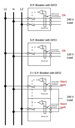

I have sketched out below what I deduce your GFCI is.
The top one is the double-pole breaker and in that, the current sensing coil must surround all three wires. The vector sum of the currents must be zero (else current is leaking - a fault) and so the total magnetic flux from the three currents must also sum to zero. Flux that corresponds with 30 mA of imbalance will trip the breaker.
The second is the single pole breaker, much easier to understand because the currents in line and neutral conductors must be equal and opposite, so again the vector sum of the currents must be zero (else current is leaking - a fault) and so the total magnetic flux from the two currents must also sum to zero.
In the third, I’ve drawn what I think you are describing: two single pole breakers with linked operators, so that either tripping due to a fault will mechanically open the other. In this case, the problem is, what do you do with the neutral? In general terms, the neutral current can be any amplitude up to the higher of the two line currents, and in the direction of either. Splitting the current onto two conductors as I’ve drawn will never work, because you can’t enforce it to split such that the current through the sensing coil matches in amplitude and opposes in direction the current in the corresponding line conductor. Therefore the prospect of NOT getting enough flux to trip either breaker is small - the largest current must be less than 60 mA – and that’s assuming the neutral current splits equally between the two breakers.
