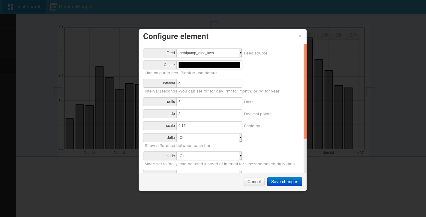

Hello @Lui some of the widgets include a ‘scale’ field, you may be able to use that to convert say kWh/d to cost/day e.g:
Thank you @TrystanLea. I appreciate. Any idea on how to work around this challenge?
