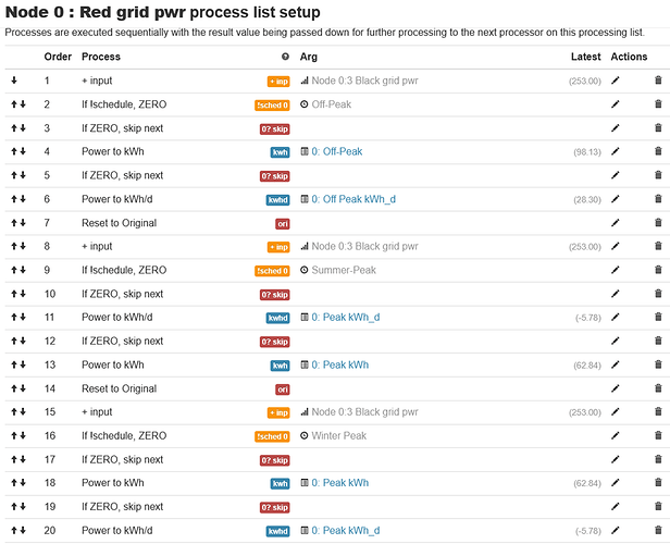

I think my system was working fairly well - accuracy was off but a good enough indicator of whether my solar was feeding back to the power company. At some point though over the winter something I expect I did, seems to have broken things and I seem to have made it worse. In short the kWh/day feeds are not logging anything for some reason. There may be other issues too that would be good to clean up.
To complicate things:
  • This is a US system with two split 120V legs
  • I have a PV system that can feed the grid
  • My billing tariff has three different rates, over four periods

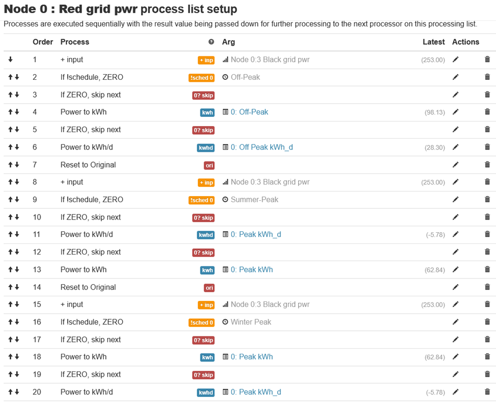

I have schedules working and that seems fine. I took the screen shots at about 3:10pm, so the super-peak rate is in effect. The main processing is shown on what I call the red input. The logic I have is:
  • List item Add black power - this will give me net power from or to grid
  • If not off peak schedule, zero out the input
  • if zero (input) skip next - should be true
  • convert power to kwh and log it to off-peak
  • convert power to kwh/d and log it to off-peak kWh_d
  • reset input to original
  • add black power input

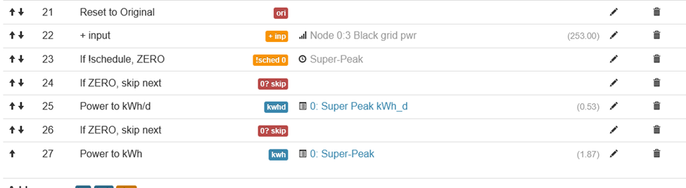

  • … repeat this for Summer-peak, Winter Peak, and Super Peak (line 23)
  • line 23, should return false and therefore not zero out the input
  • line 24 input is not zero so should not skip next
  • line 25 convert power to kWh/d and log to Super Peak kWh_d
  • line 26 input is not zero so should not skip next
  • line 27 convert power to kWh and log to Super-Peak

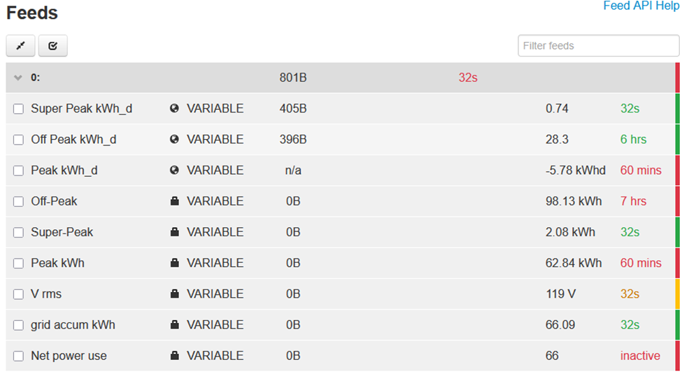

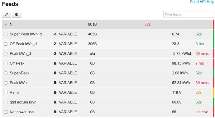

    The feeds, appear to show this as working - except when I try to view them

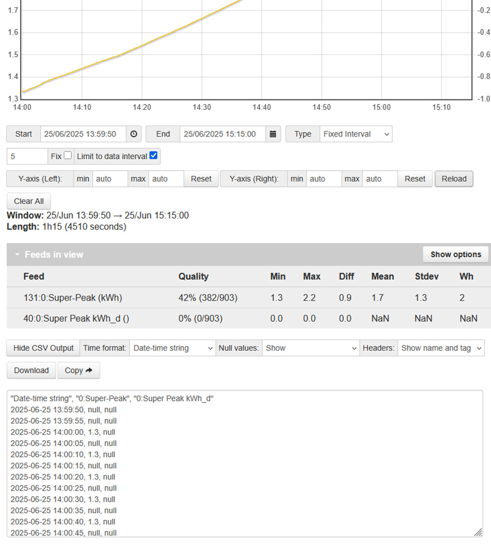

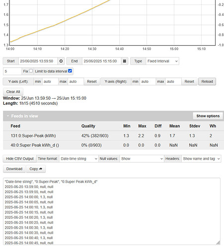

    It seems that kWh is logging but not kWh_d - I have tried deleting the feeds and creating new feeds but it still does not appear to be saving. Hopefully it is something simple that I have messed up.
Emoncms log shows a combination of these, I’m not sure what feeds these id’s relate to. The timestamp is also from about 35 minutes ago:
2025-06-25 18:52:17.234|WARN|feed_model.php|Feed model: Requested feed does not exist feedid=59
2025-06-25 18:52:17.235|ERROR|feed_model.php|get_timevalue() Feed '59' does not exist.
2025-06-25 18:52:35.277|WARN|PHPFina.php|get_meta() meta file does not exist '/var/opt/emoncms/phpfina/54.meta'
