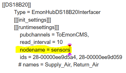

One thing I have noticed with emonPi2 is it creates a separate node for the Temperature Sensors (see screenshot below), whereas, in my emonBase and TX4, it was all part of the same node. Therefore, each emonPi2 will now have two nodes, which reduces the number of locations I can have in the same account, from 32 to 16.
I just experimented with changing the nodename = sensors to be the same as the nodename for my emonPi2 and it then placed the temperature sensors into the emonPi2 node, which is good as my node limit is no longer halved.

So, this begs the question. If nodes are limited in a given account, why create new nodes unnecessarily for temperature probes?
