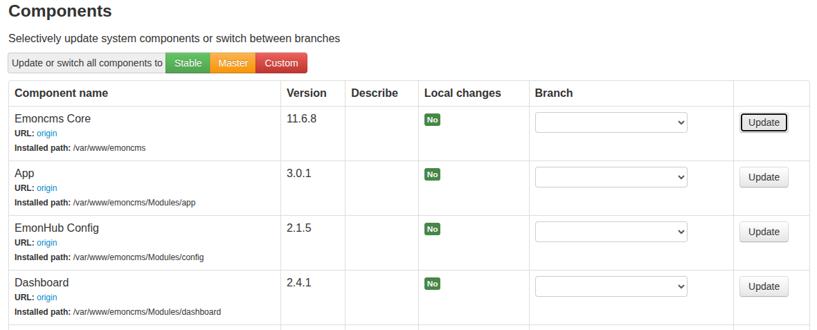

I tried the ‘full update’ option, this duly created the shell window at the bottom of the page,.. but then nothing. ( no text not nothing )
switched to the components page,.. and tried several options here,.. other than update box hi-lighting,.. nothing appears to be happening.

this may be the same issue I had. @TrystanLea said this was the fix for me
On Oct the 8th 2024 I made a commit that inadvertently broke the update mechanism here harden getServiceStatus and setService · emoncms/emoncms@cc8d526 · GitHub then @reedy fixed it on Nov 7th here admin_model.php: Make runService public again · emoncms/emoncms@ef0299f · GitHub.
Systems updated between these date will unfortunately get stuck and need to be fixed via a luckily relatively simple SSH update of emoncms core:
cd /var/www/emoncms
git pull origin master
Then try running the full update again from the UI so that the rest of the system is updated.
Hi John,.. Thanks for your help,.. Yes that was the solution.
cd /var/www/emoncmsgit pull origin master   // Initially this failed.. due to changed files plus extra file ( as I kept a copy of original prior to edit)
git stash list      // Check if I already had anything stored
cd /var/www/emoncms/Modules/feed/engine // Not sure if required, but did a cd into changed folder
git stash       //create stash
cd ../../..git pull origin master
cd /var/www/emoncms/Modules/feed/engine // ran no problem all files seem to update
git stash apply     // applied edit from stash.. yes seems to work.
did ‘full update’ from admin… now we have some ‘action’ and files have up dated, and show as latest revision
