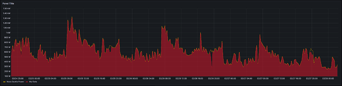

this change seems to have really dialed me in to my utilities equipment. More than pleased with the results
I do still see the odd point where I read a bit low… .seems like once a day so I’m thinking some kind of timer or something. Going to log for a few days then check what’s going on when the dip happens.
I suspect this means that you have a small residual “power” coming from noise pickup. What you’ve done is totally legitimate.
You might need to increase the reporting frequency to see exactly when and for how long it happens, in order to identify it.
yeah, I’m going to lock the code down and let it run for 4 or 5 solid days without interruption and see if I can spot the issue. I’m pretty sure I could dial up reporting from 1s to 500ms and not really have any downside aside from some extra disk usage on my influxdb server

Apologies! wasn’t trying to make you squint! I get a regular ‘dip’ in my data daily around 19:00 +/-
maybe easier to see like this?
Much better :+1:
You’ll have to go hunting. Make a list of when, what you and anyone else was doing around the time, what it it dipped from and to; and start looking for a pattern.
Don’t be too surprised if your hunt turns into a wild goose chase.
It’s hard to imagine half your load has been missed for two reports - unless you’ve lost a reading on one leg of your 120 V; and why about the same time each day (if indeed it is).
One more point to remember when looking at the data - if you’re using something like our emonLibCM library (I can’t remember if you are), those “points” are the average over the preceding period, so you need to be thinking more in terms of a rectangular block of load that doesn’t fit neatly to the points, but which when averaged will give the value you see.
So, if you lost a block of power 300 W deep starting half-way between the 19:00 and 19:15 points, and ended exactly at 19:30, it would give you the points you have.
