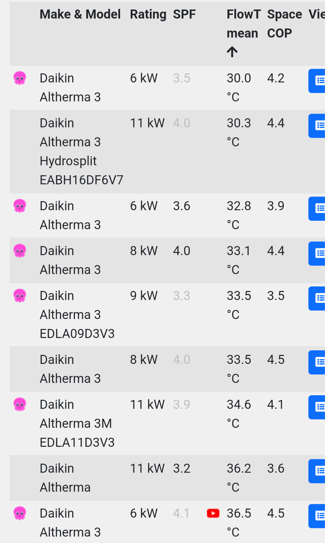

I guess you could expect better SPF from the average flow temps than what the daikins generally achieve:

I am thinking a 4 port buffer with UFH mixer could improve COP of a Diakin with high thermalmass UFH given the low COP people with very low flow temperatures are getting compared to people with normal flow temperatures!
tbh i dont think any octopus installs on here are running anywhere near the design temps , if you look at them most are less than 35 degrees when its below 0
