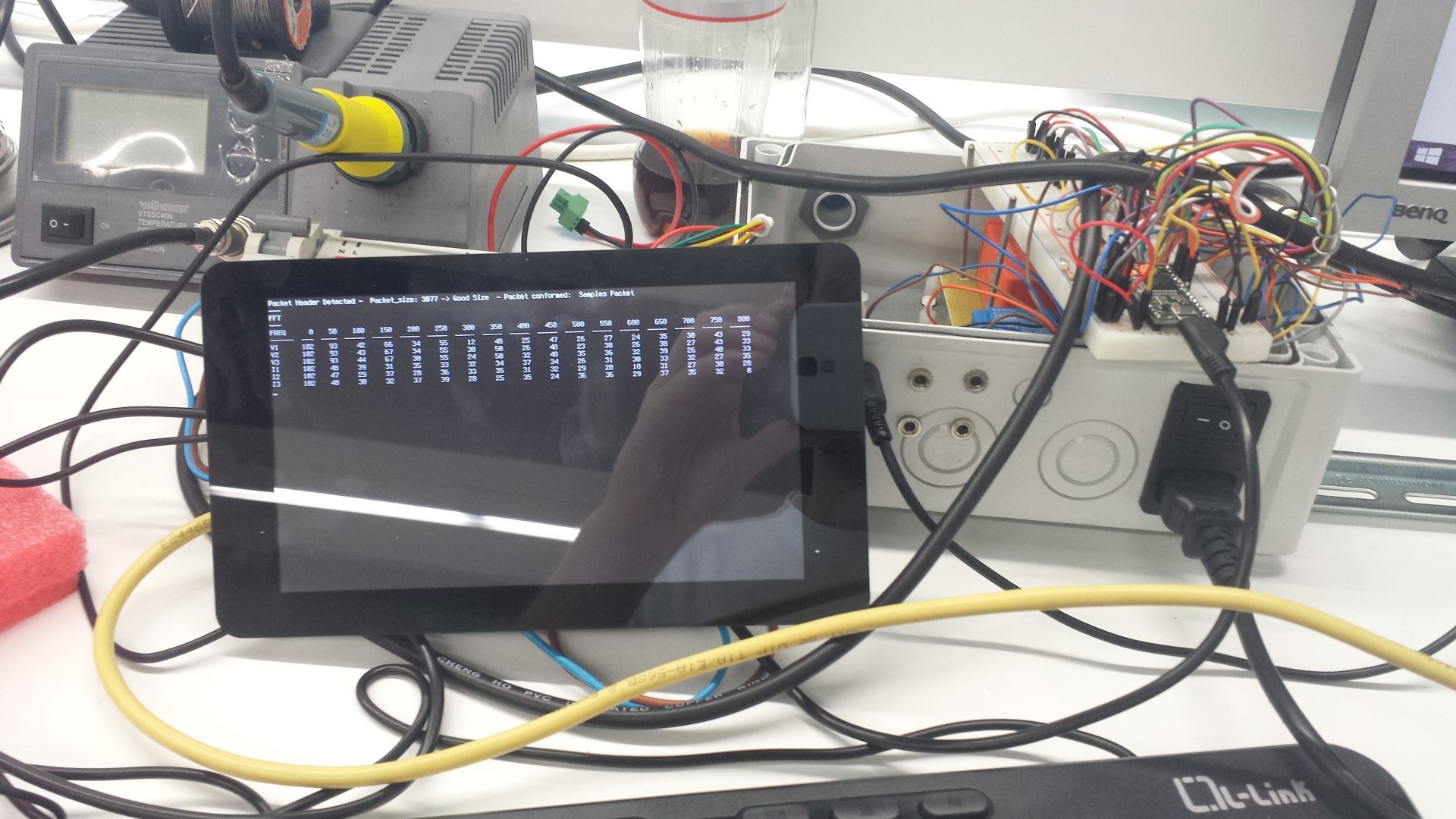

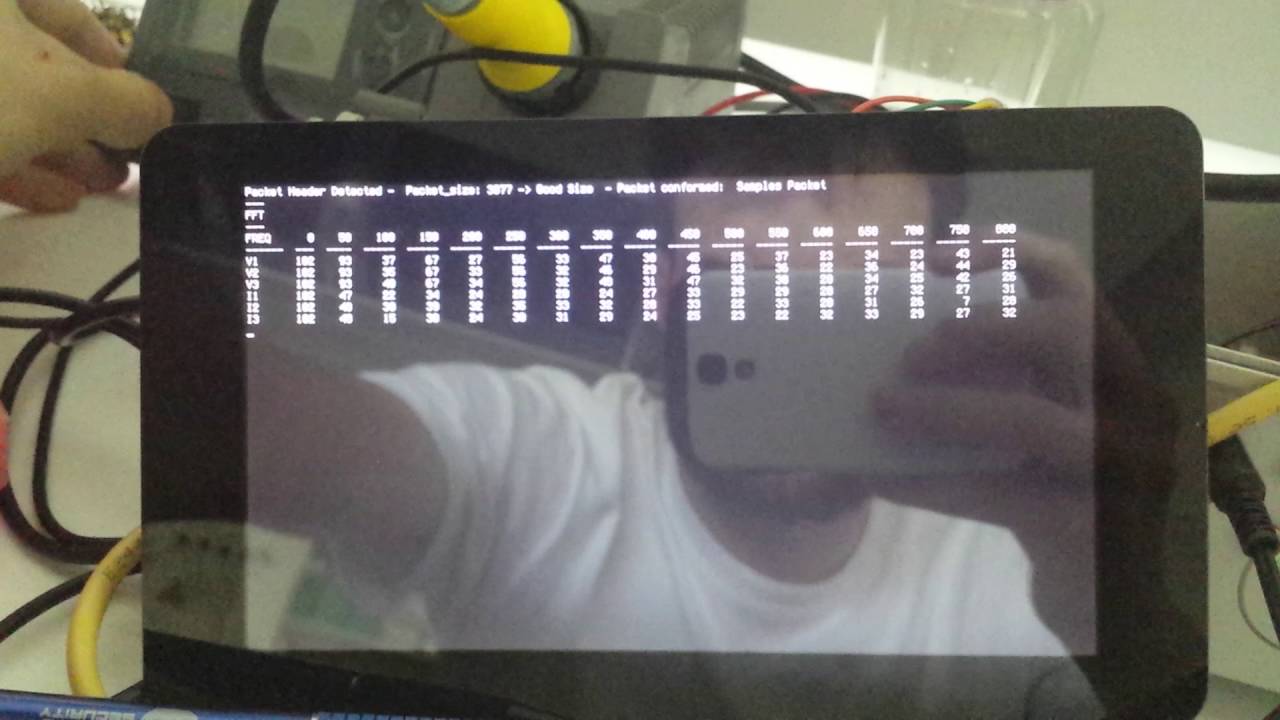

Hi all!!
I have decided to do all the math in the Raspberry Pi.
Here I attach a video of the setup doing FFT in 6 channels, and some photos of the setup. It is doing FFT up to 1600 Hz, but I truncated it to be able to show it on the RPi display. I have the same V connected to all V inputs and the same I clamp to all I inputs.
The next step is to do all the conventional math that EmonLib does, but in Python.
The hardware, RPi3 + Official Display, 5 Volt power supply, the Teensy 3.2 in the protoboard and the Voltage transformers under it.:
Photo of the display:
Have a nice day.

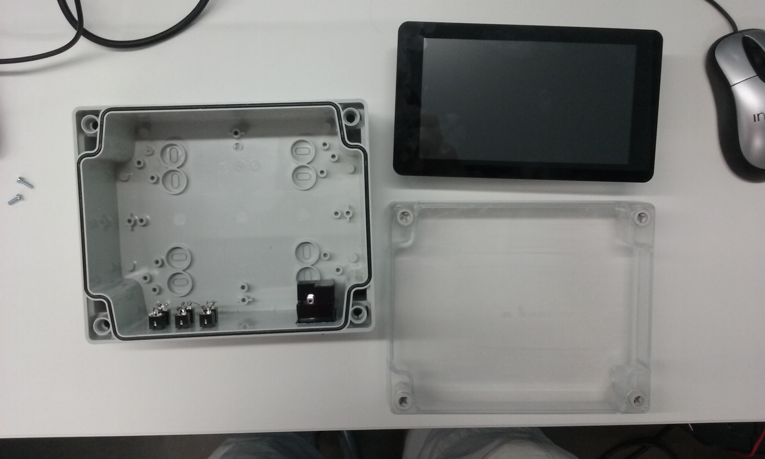

Hi again, I’m making progresses with the project.
I have mounted it in a permanent enclosure, and now I’ll improving the math, the event detector (when voltage is inconsistent, too much harmonics…) and the waveform recording if there is a event. After that I’ll do the GUI.
Photos, and video:
The box I’ll be using:
Cut for the RPi and the Display:
Display and RPi mounted:
Top of the Teensy Part:
Bottom of the Teensy part:
Top of the power part:
Bottom of the power part:
Closing the case:
Completed:
The system running:

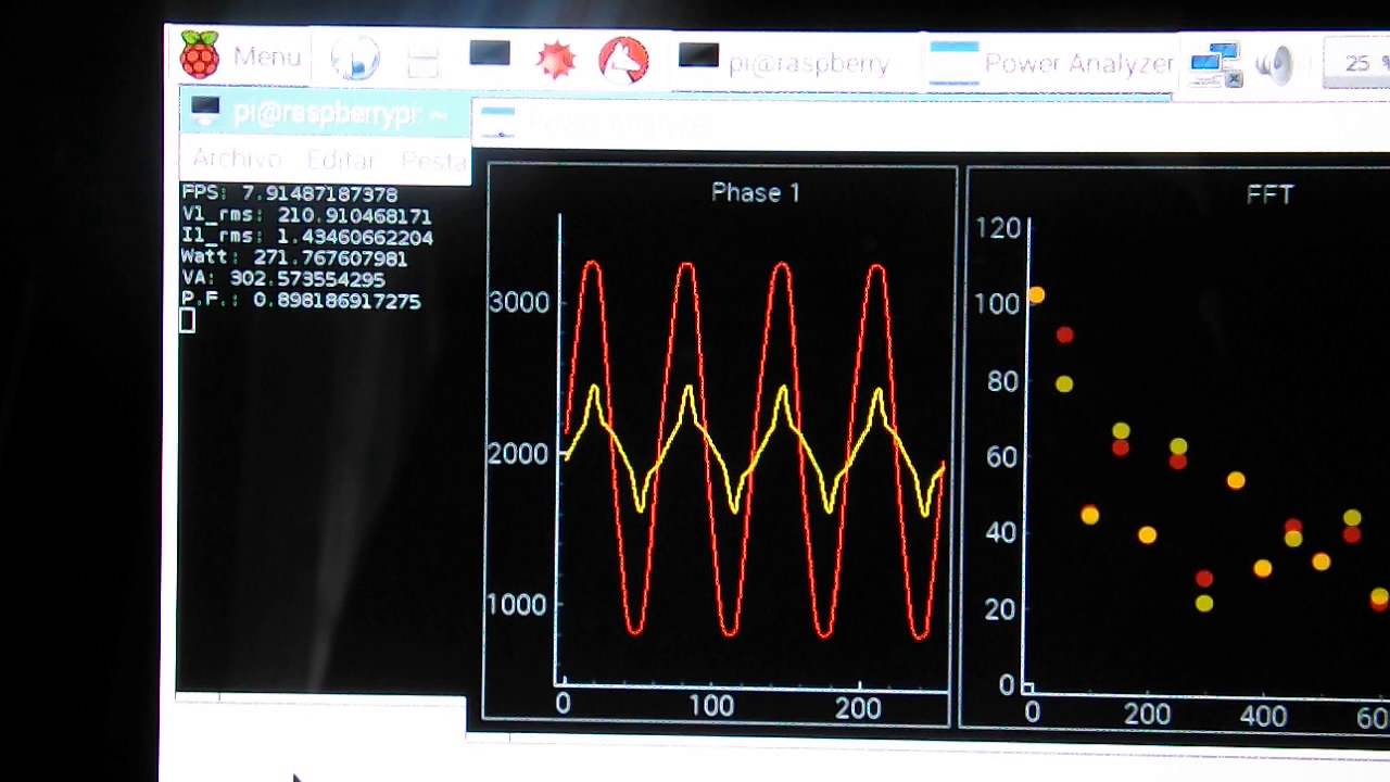

Hi!!
I’m triying to build the GUI, here a photo and a video :slight_smile:
Video:
Have a nice sunday afternoon :smiley:
Great Job!!
Thank you for sharing your code. It seems to work good!:raised_hands:
Is the Voltage FFT correct? Your Voltage signal looks pretty pure in the time domain, but in the frequency domain it looks almost as distorted as your Current signal. In my monitor I don’t bother with a voltage FFT because it’s so predictable as you can see below. That pic is actually an FFT of the Current in the lights circuit with about 820W of incandescent bulbs on, which should be a pretty good approximation of the Voltage FFT. Even with a bit of flat-topping not much shows up in the FFT.
Hi dBC,
I’m calculating the spectrum in a logarithmic scale, I’m applying a log_10(x) formula. The units doesn’t have any sense, but the sacale is logarithmic in base 10. You can note that although the harmonics are greater after 3rd harmonic (4th point in the graph, the first is DC, sencond 50Hz, third 100Hz…), the 50 Hz component is much greater. Maybe I should change units and remove the log scale…
Thanks for the ideas :smiley:
A logarithmic scale explains it. Don’t remove it on my account, it’s a good way to bring out the detail.
