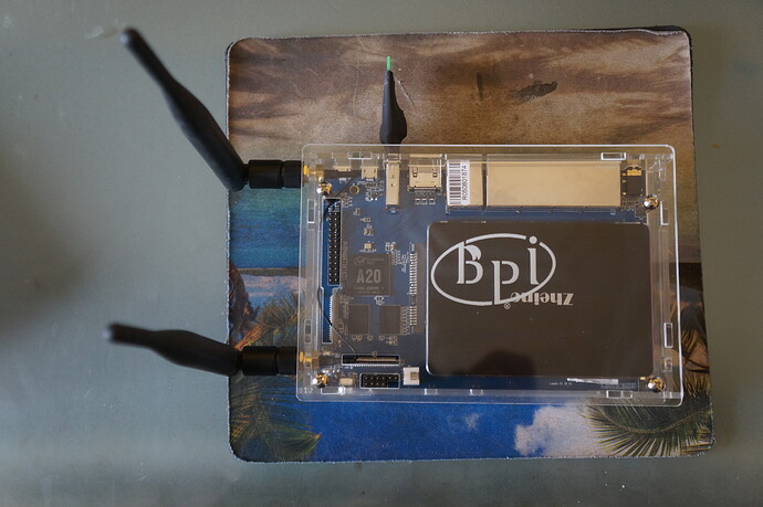

Firmware update for BPi-R1- the new firmware is geared towards espEasy firmware. it has domoticz installed and zidbee2mqtt. plus my normal platform of openwrt/collectd base- for IOT data collection
it is fully automatic for Iot data collection if MQTT topic is in the correct format, the data will be saved to Influx database and you can visualize with chonograf and send alerts with kapacitor. or you can use domoticz to save the data( or send to emoncms or multitudes of other controllers available in espeasy) Also Zigbee device connection is fully automatic as well and entries are added to domoticz..
the device can replaces all your nework devices in the household- Router,NAS, DLNA-media server. Database server, Iot Monitor , and home automation ( plus more) and in < 10 watt device
it is fully configure all you need to do is install your SSD in the device and a mount it

of all the Pi devices I used this Bpi-R1 is still my most favorite.. it the best bang for your buck..
end device with zigbee2mqtt dongle
