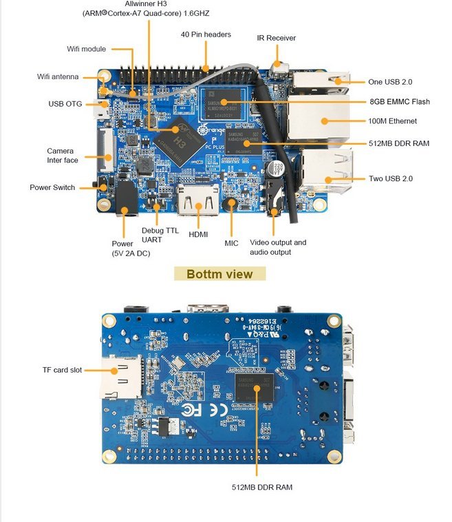

you can always try orange pi pc plus from aliepress.com i paid $10 (on sale) normally about $15-20 has pretty much the same specs one less usb. but I do not use raspberry but armbian as an OS i got no complains… runs my IOT at 2% - 10% depending on the load cpu usage. mine has 1 gig on memory but you can get them with 512- 2 gigs memory

If you are looking for pure speed, then BANANA PI MC with its 8 core CPU or the ODROID C2 or XU4 with its 4 core cpu - each have 2 Ghz cpu and 2 Gigs of memory and Gigabit LAN. Pricewise the same as Raspberry Pi 3. But also runs on Armbian or Ubuntu Mate. I believe the rating is ~40% faster for the ODROID AND +100% FASTER for the BANANA PI M3 than Raspberry Pi3. The Orange Pi PC Plus is about the same as the Raspberry Pi3, but then again, costs only 15 bucks normally on Aliexpress.
