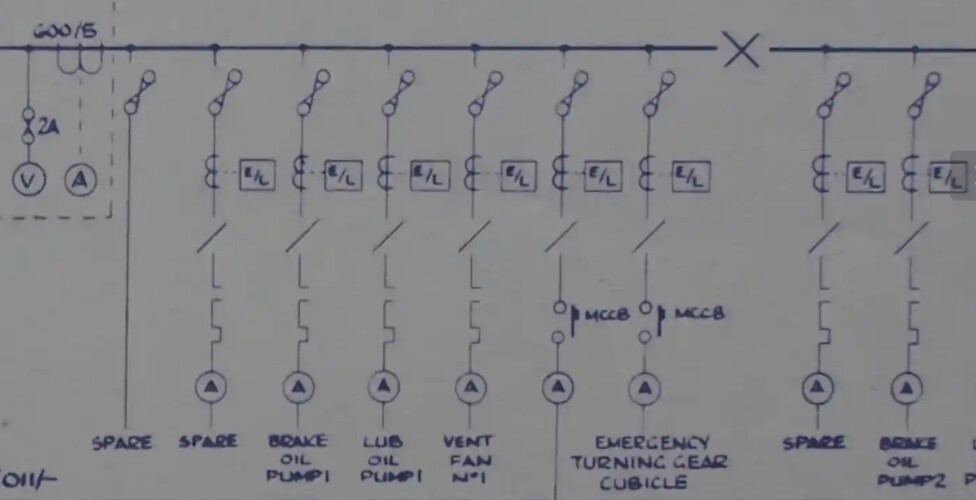

It’s an all-electric passive house with PV, Battery, Heat Pump, EV Charger, Diverter to HW. A rough schematic is attached. My first requirement is displaying energy flow information in the kitchen. After that, control of the battery and import/export. Equipment is SolarEdge, Fronius, BYD, MyEnergy (Zappi+Eddie). The house was single phase but I introduced three phase which feeds the Zappi, battery, Fronius, and provides a single phase supply to the house. I use 20k kWh/annum including self-generation and import.
Schematic 2025.xlsx (11.9 KB)

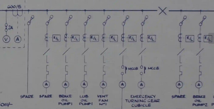

I strongly second that - I looked at your “schematic” expecting what we call a “single line diagram of connections”. If you’re not familiar with the idea, this will use a single line to show the power flow (i.e. ignore neutrals and earths), but do have 3 lines where you have the 3 phases, include meters, consumer units, with their switches and circuit breakers/fuses (with their ratings) and of course all the sources and sinks of power.
This might give you some idea of what one looks like (part of an industrial switchboard - the main supply is off the picture on the left hand side, there is a backup supply feeding in from the right-hand side):
