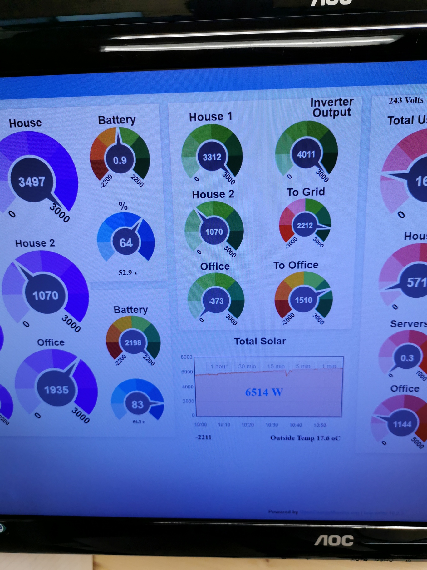

Battery appears not to be charging
I am not sure if this is a bug.
we have 2 inverters with batteries on a single phase. we have a target of of 50% for battery charge. once 1 reaches this level and solar production exceeds the usage it sends the excess to the grid.
House 2 is just a standalone inverter.
Total solar production is 4222w
House battery is 51% and not charging. The inverter is outputting 2966w
Office battery is 41% and charging at 909w. The inverter is outputting 0W
Total house usage is 1249w
Sending to the grid 1915w
the 1915w should be going into the batteries.

Here is another screenshot

This is intentional. The grace capacity is for the following situation:
The SK-SU5000E can take in 5kW, but only outputs 4.5kW. The rest of the energy is lost if the battery is full.
Configuring a grace capacity reserves some capacity to allow energy to be diverted to it once the grace-power-threshold is reached, thus maximising the energy recovered from the panels.

I have changed to config to only have 1 time period no grace. today we have had it where 1 battery is charging and the other is not, but we are exporting 2272 watts to the grid. if i watched it for a few min it would start to charge the battery for 1 second then stop
resarting the powerscraper services fixed it
