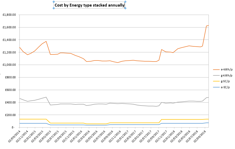

I’ve recorded monthly meter readings since 2013 so have a pretty good idea what I use! Some of the house is heated by electric so I’m not typical but I’ve used about 8,000kWh over the last year (in a very, very well insulated and air-tight house). Since we stopped heating, it has been an average of 16kWh per day (on meter readings).
Key difference I suggest is background. Here you see Kettle and Dishwasher and a chunk of the background is my MVHR system (needed as the house is basically air-tight).
You have got to keep up with the comparisons for fuel. I could easily be paying £300 per year more. I don’t trust the actual figure given so always calculate the projected cost using a spreadsheet.
It is interesting, but despite the headline that energy has gone up, actually my cost per kWh (on an annualised basis of dual fuel) is about the same as 2015 (going up though).
Key difference is the standing charge - this has risen from 6p (low point) to 16p in that time! Before that it was 20p. It is a stupid charge and impact low users more than high use. In fact, the more you use the less you pay per kWh.
[edit2]
Last chart - this is my use last 12 months * what I am paying now going forward… Not pretty.
