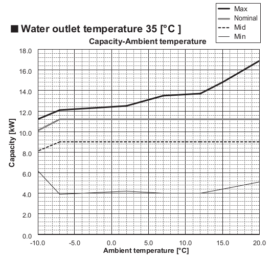

Can anyone explain what is happening to the minimum graph in @Timbones set of graphs above? How can the minimum at -10c be 6kw and yet it is only 4kw at plus 15c???
It is odd, I have no idea why. Maybe it just needs to work harder at those temperatures?
I double-checked the databook again incase I copied it wrong… (11.2 kW)
Similar can be seen on the 14 kW unit…
…but not so much on the 8.5 kW:
I also noticed these plots that show the COP is best when (this) heat pump is working in the middle of its power range, so aiming to be running at the minimum all the time (as I do) isn’t necessarily the best for performance.
The sweet spot certainly fits my heat pump experience - it runs very sweetly between 7c and 12c putting out around 5kw for it’s minimum input of 910w. Makes sense that they optimised it as this point as the SCOP figure depends a lot on the performance in this band - it represents 57% of the heating year in my area.
It’s be interested to see the compressor frequency at those minimums - looks like a software minimum limit that gets set higher at lower ambient conditions.
It will be related to avoiding something nasty happening on the refrigerant suffer no doubt.
