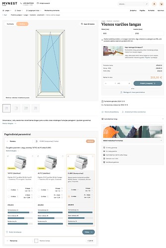

RRP for say 900 x 2100 mm tilt/turn with warm edge triple glaze 373 vs 462€ - very little - with actual price say €220. Not. Worth. Skimping. When you can have passive house certified windows for very little.
I would also spluge €30 nominal (€16? after discount) and go with a hidden tilt/turn hinge for (a) keeping it INSIDE the air seal and (b) giving more clearance between the window and the window reveal when it opens.
You may also want to learn how to measure / fit windows yourself. The markups applied by people who are doing door to door sales; to cover their backsides when they order the wrong sizes etc; are pretty damn huge. Possibly the largest you can make in a retrofit and even if you mess up…half the windows…you’ll still save overall and will have an amazing set of windows for the garden shed later lol
