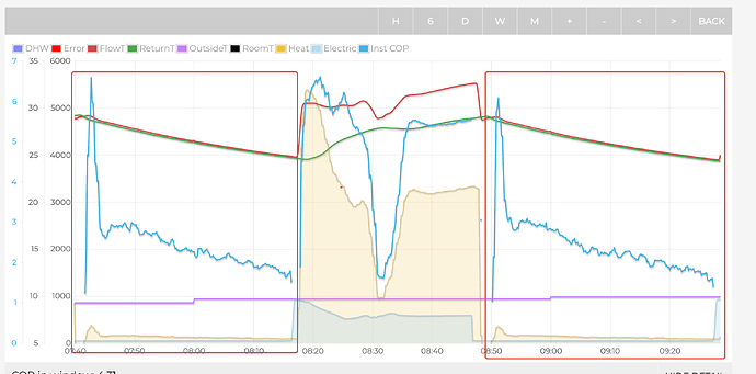

Hi all,
I have an AroTherm Plus 7kW heat pump and am trying to understand its behaviour during warmer weather.

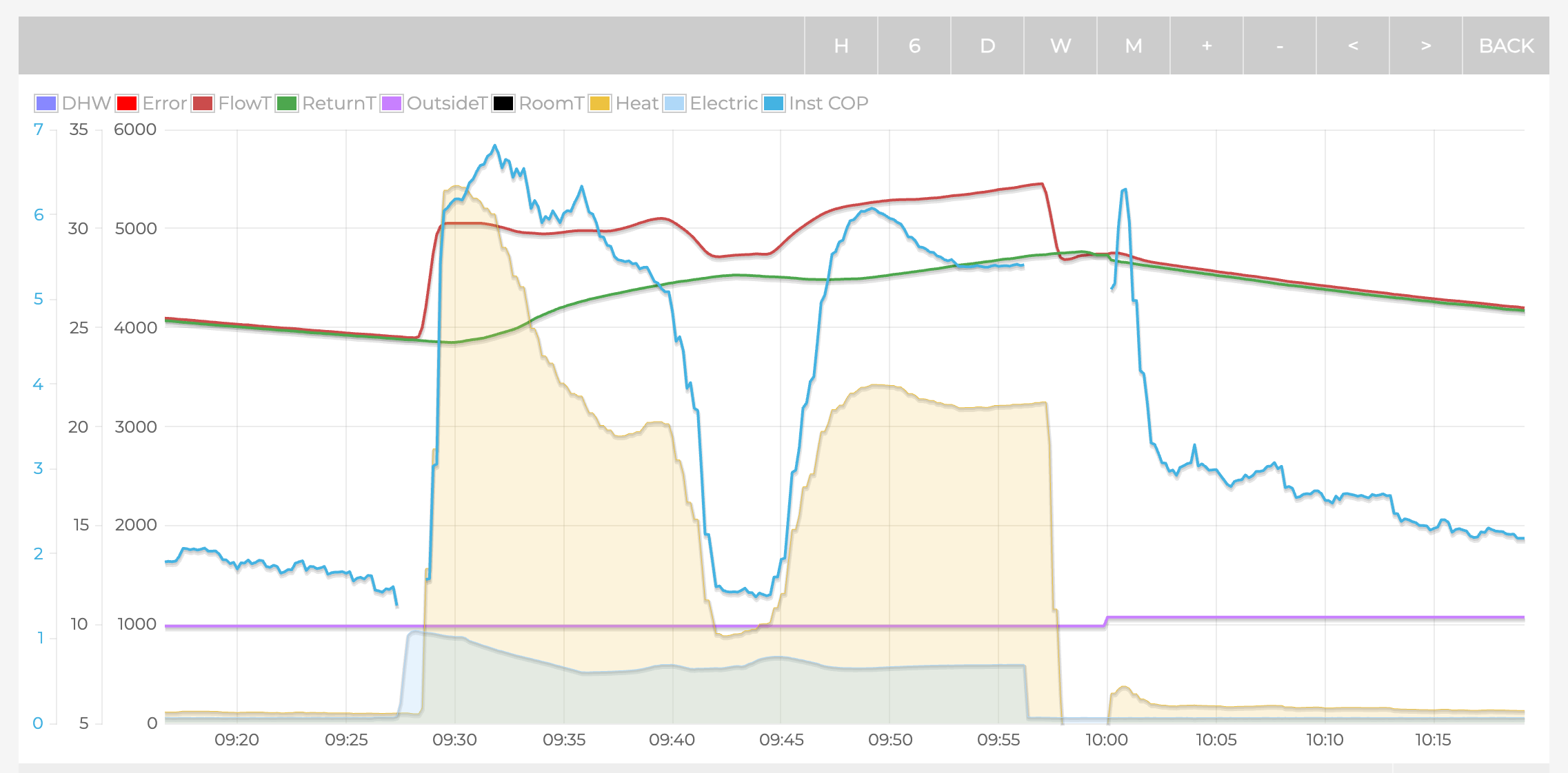

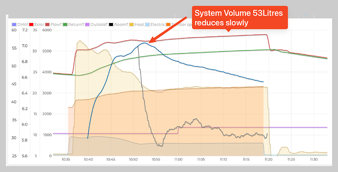

Does anyone know what might be causing the significant drop in COP during each cycle in this video? This effect seems most noticeable when it’s warm outside (like today in the South of England). Its worth noting my system volume is quite low (my installer told me its about 53litres)
Here’s the video: https://imgur.com/a/rrZ89jc
Feel free to check out my OpenEnergyMonitor data here: Emoncms - app view
Any insights would be greatly appreciated!

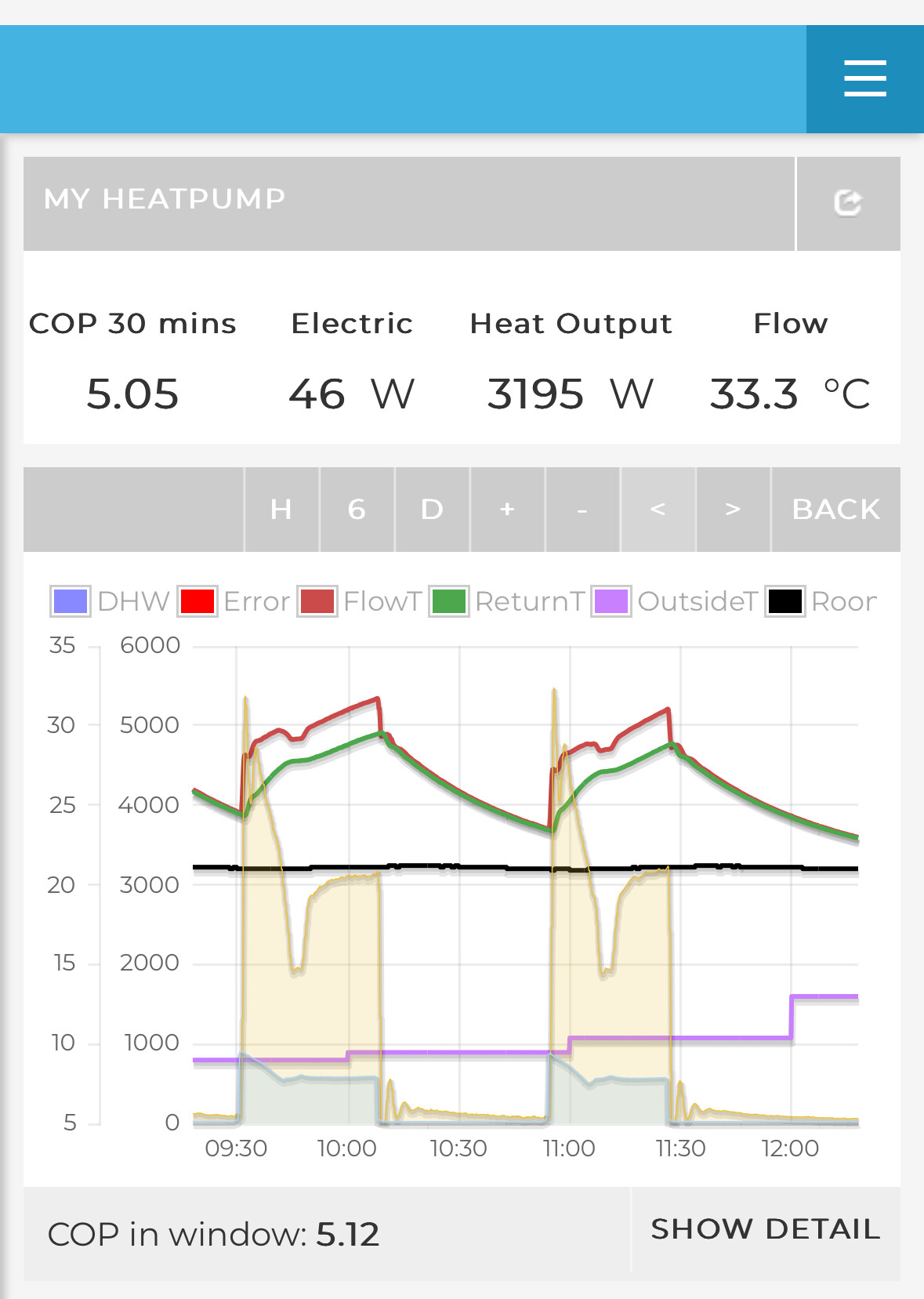

I don’t think that dip is unusual, it appears on a few other Vaillant systems I scanned. e.g,
I’d not be too concerned as the daily COP for heating is still very good. It’s likely part of the operation where is modulating right down at its lowest limit, can’t go that low and brings the output up again, that’s my uneducated guess, but hope it’s helpful.
I’d be more interested in the DHW performance and trying to get longer runs, less often. That would significantly improve the daily overall COP when heating demand is low.
The dip is normal and appears - to varying extent - when the heat pump transitions from the initial high-power ramp-up period to its lower power steady-state operation.
Very short cycles suffer a COP reduction due to this, but it cant really be helped. The only thing you can do is set the Comp. Start. Heat. setting to -100, this will result in longer cycles that are more spread out. The downside is that you might get more indoor temperature fluctuations, depending on what the thermal capacity of your house is.

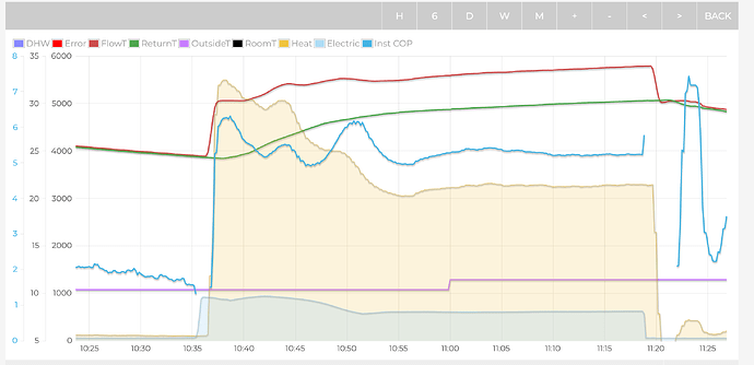

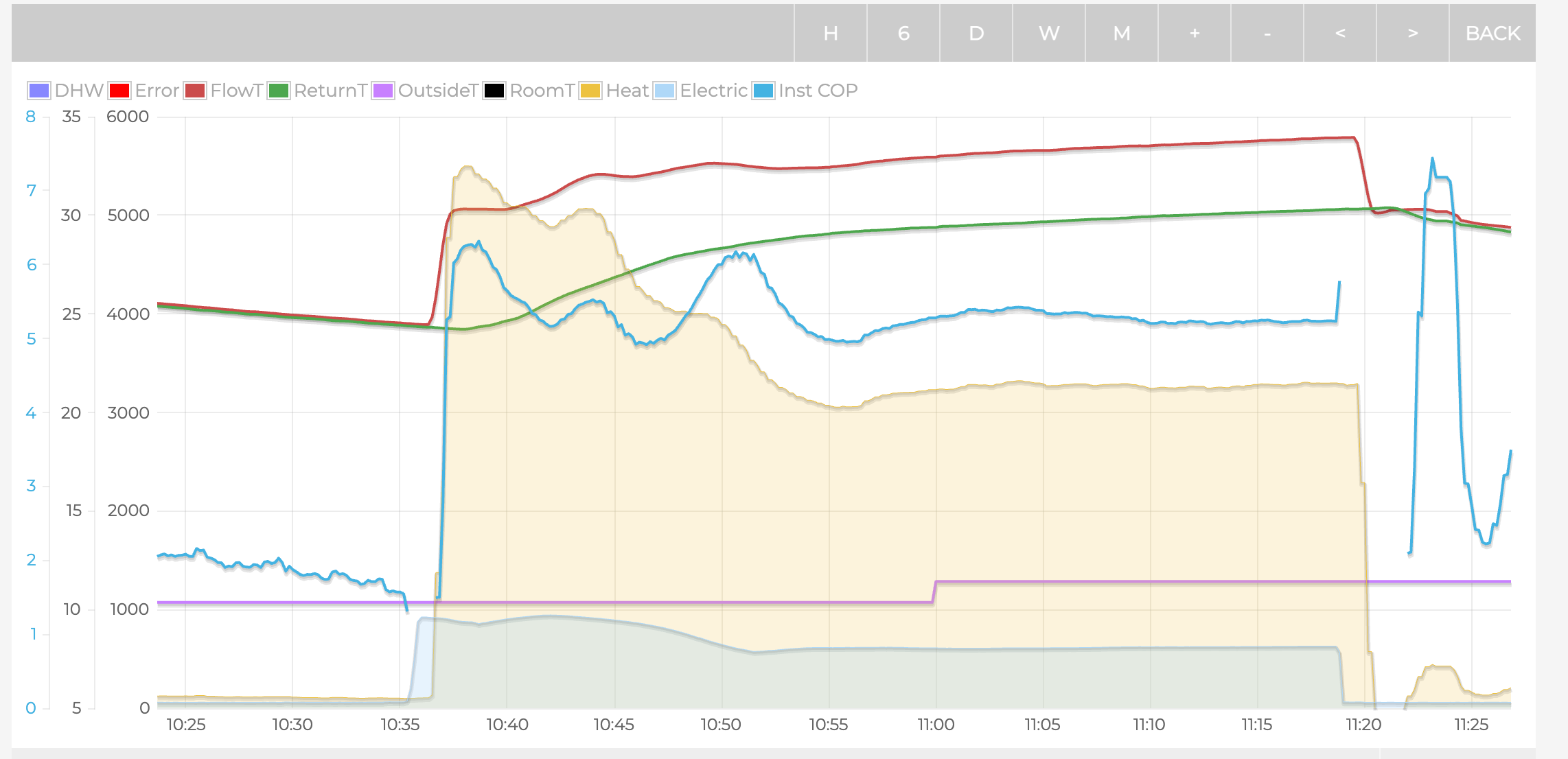

Also strangely looking at my OEM today - the 9.28 cycle shows the same drop in COP after the initial ramp up.
Whereas the 10.36 run has a tiny dip comparatively
I cant see a huge difference in the parameters between them - they both start at similar flow temperatures, the external temperature is only slightly higher in the second run.
We’ve seem similar dips with a couple Mitsubishi heat pumps:
Could be a hiccup in the refrigerant cycle, perhaps a sticky valve or something.

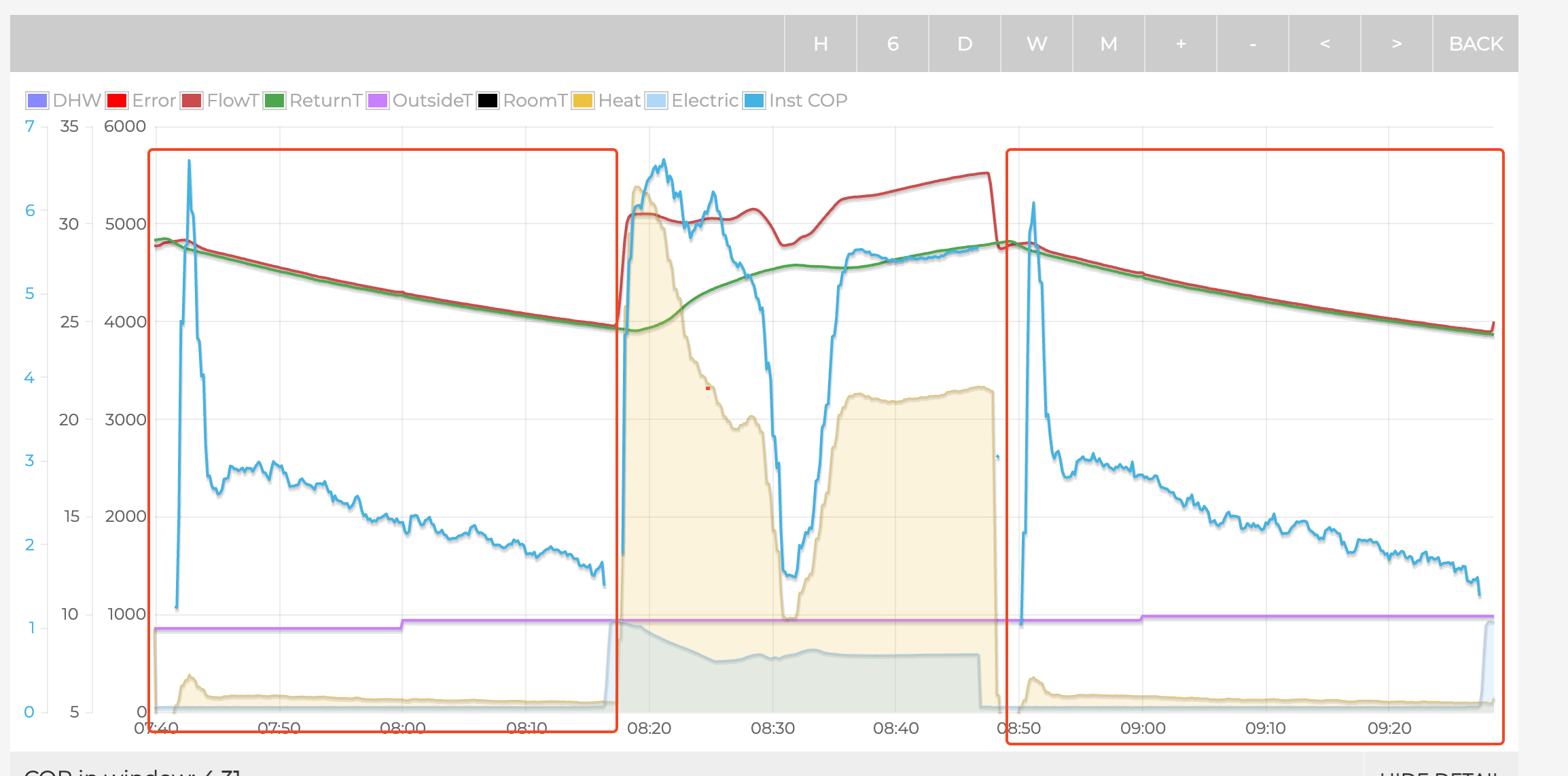

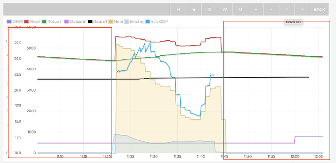

Also another separate question. Here is someone elses system. Between cycles their OEM is not calculating a COP - which is presumably not being counted towards their SCOP overall figure.
With mine below, it continues calculating a COP.
The dip is quite excessive, I agree. But you see that the cycle with the dip features some more dynamics on the electrical input (short rise and then fall). The second example just happily chigs along at the minimum power. I think that’s related and a hiccup occurring early in a cycle.
Do you have a heat meter in your system or where is the data coming from? What you’re seeing indicates an offset in the temperature probes, as flow measures a higher temperature than return when the compressor is off. It’s a well-known issue with Vaillant’s sensors, which you’d be using if you get the data off ebus into the heat pump app
So interestingly, when comparing the good and the bad run
Good run:
Bad run:

The System Volume is inferred from other data, so I wouldn’t read too much into that.
I’m using this.
Ok got it, is there anything I can do to accurately model the system volume at any given time. I know I have 2 zones, perhaps the second zone is closed during this dive in COP.
Also what do you think about the 53litre system volume (confirmed by my installer) do you think thats limiting my system performance?

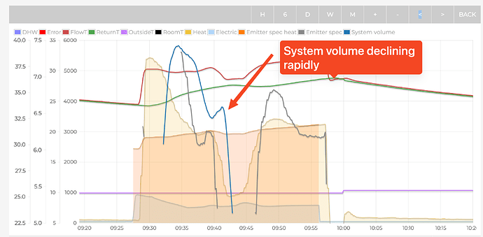

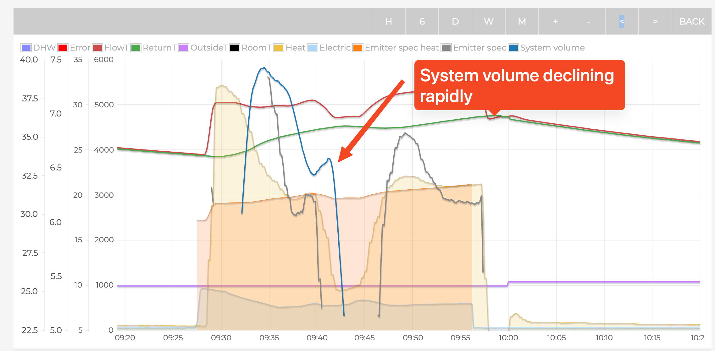

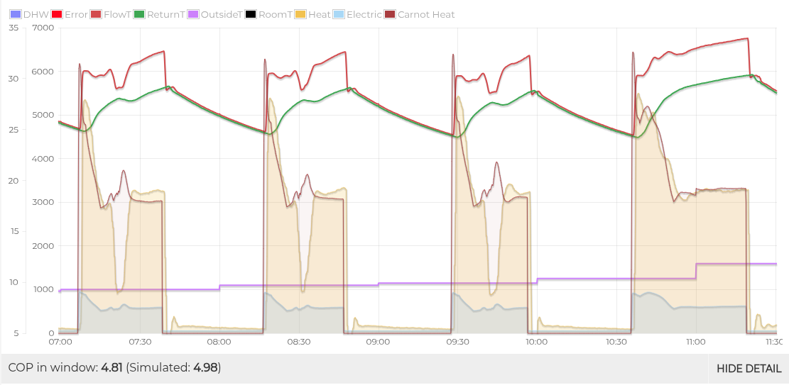

Plotting the “simulated carnot heat output” shows that the heat pump is failing to produce the expected power output during those dips - link to chart
I believe this is most likely due to stuff happening within the outside unit, and isn’t affected by zones or volume.
It might be worth enabling “quiet mode” (or whatever Vaillant call it) to see if reducing those startup peaks helps at all.
