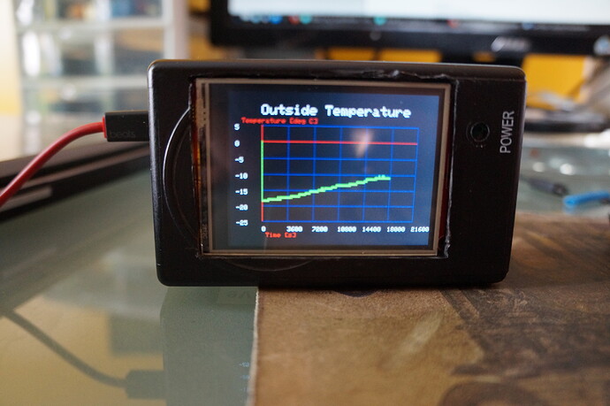

Hi @stephen, what is the case you have it in? I’ve done something similar for a Pi Zero but built an interface PCB to connect the 2 together. Just not found a case yet!
just from scrap . i have a ton of dead waverider poe (from my isp operation) their case is the perfect size for the mega/uno arduino form factor all the preexisting holes match up to the power and usb ports. just pretty much open them up toss the insides . and drop in the ardiuno and close them up again

should end up looking like this
and finished product like that:
if you want small form factor just use a wemos mini and mount it directly to the PCB and power it through the usb cable
in the TFT ESPi libarary you will have to modify the pin out to match yours if you follow the above mentioned then you will edit it to look like this User_setup.h :
