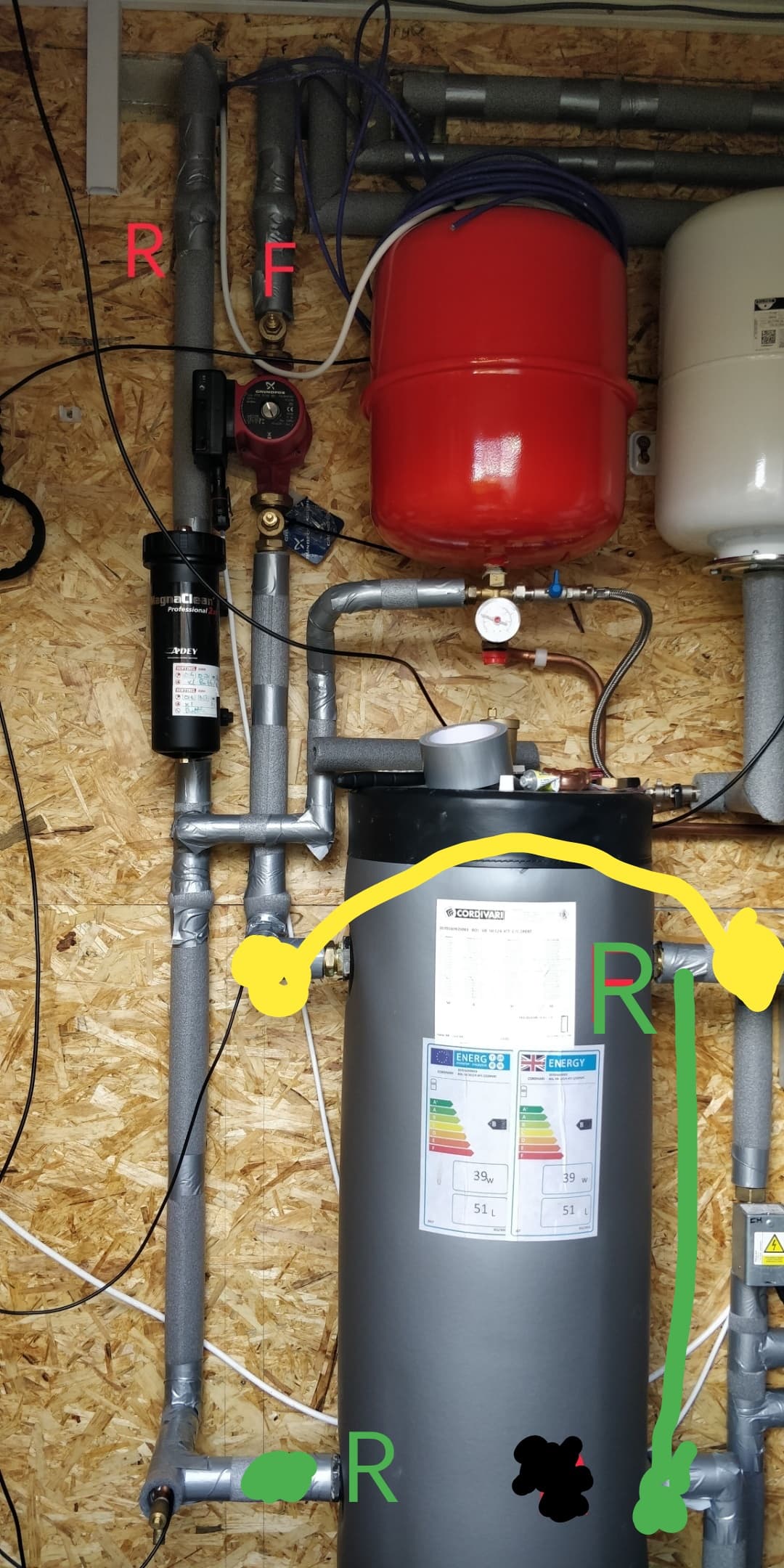

I know Grant now specify a LLH for their installs but at the time a buffer was an option. Knowing my radiators were undersized I wanted the buffer to minimise cycling of the heat pump and to give the hp something to draw off for defrost rather than cooling the radiators.

Change the buffer to a 2 pipe volumiser,.ditch the post buffer pump, the Grant has a fixed 3 speed pump,(change setting on dip switches if needed)

Forgive my ignorance but do I achieve the same outcome by removing the 2x return connections to the current buffer (capping them off on the tank) and joining the pipes together?

I would pipe it like the screenshot I’ve sent you, but on the return from the heating going back to the Grant.

So like this…
Take return from bottom right port (& cap it) to top right port
Disconnect & cap top left port
Connect heating flow directly to heat pump flow
Remove 2nd pump
That’s it, but put heating return to top left, bottom right return leave as is. So your green line move to the left.
