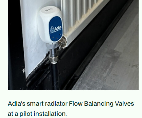

Anyone with experience of Adia Thermal Heat Pump control system - especially their radiator balancing valves
I recently found out about Adia Thermal, who appear to be a relatively new company marketing a HP control system/smart radiator balancing valves/circulating pumps combo. I am thinking of using their system in a house we rent out, but I would also like to retrofit their smart radiator balancing valves in our own house.
The RBVs appear to be exactly what I would like. ie. rather than being fully open or fully closed, they adjust the flow continuously so that the temperature in each room matches the target for that room at that time.
Unfortunately they are not keen to sell the RBVs except as part of their whole system. Does anyone know if the RBVs are their own product, or whether they are rebranding another company’s hardware? Or are there other RBVs on the market (as distinct from traditional TRVs)?
Do they monitor flow and return temperature for each radiator?

I would just go for the FRVs from Firepower. The Adia system (while very clever), is just a way for installers to avoid doing calculations and reduce call backs. For any enthusiastic homeowner, the FRVs accomplish pretty much the same thing.
I installed them last year and have been extremely happy with them. The distribution of heat around the house is now perfect, and balancing the system now takes 5-10 minutes, and not hours/days like with traditional balancing.

We trialled Adia at an existing heat pump installation in Devon - the original system wasn’t great - oversize heat pump, fixed flow temp (albeit 45), and undersized primaries.
We did that nearly two years ago. The running cost almost instantly halved, not only bringing the temp down, but also less cycling as would be expected from a balanced system.
The ability for the homeowner to define different room temps, whilst still having an open zone system, is a real bonus, and they find the app easy to use. Adia were very supportive throughout. One rad got upgraded a few months after, and next up is replacing the heat pump with one more suitably sized.
FYI the one installed was a 12kW, my calc said 7kW, Adia’s measured heat loss said more like 4kW!
As it replaces the diverter, controller/optimiser, and constantly balances it replaces a fair bit of kit and cuts a fair bit of labour.
We now stock Adia as standard for the heating engineers that we supply. It has a definite place in an installer’s arsenal of solutions. It’s particularly suited to a phased approach - initial install at close to the BUS grant, then let it test and verify, before following on with targeted rad and pipe upgrades.
