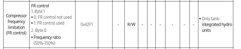

Finally, details on 42F1 encoding. From “Installation manual Modbus Interface Module MIM-B19N / MIM-B19NT”
hence 2 bytes: struct.pack(“>BB”, enabled, limitvalue), with enabled is 0 or 1, and limit value in [50;150] range.
Hope that helps
Edit: the 42F1 is only accepted once fsv #5051 is set to 1. else, the value is discarded.

@Topaz one question, are you able to set values like 55% or 73% ? Seems when I try to set e.g. 311 in decimal which corresponds to 55% I can’t to it and always lower value is set in this case 50% - 306 decimal. I don’t know why but I don’t like it. So I can set either 22Hz or 27Hz but I can’t set e.g. 25Hz. So between 50% and 60% it makes 5Hz difference in compressor speed what is maybe 1kW of heat more. For some better regulation I would like to limit it more finer. Any idea ? :slight_smile:
I have different experience. I thought as well but the I’ve found that 42F1 always reset after one hour to 0. This gave me an idea that maybe if this register is written then #5051 is ignored for the time being until 42F1 > 0. Indeed. I’ve disabled @5051 back and wrote 42F1 and it uses FRC as requested.
Note: Once 42F1 is reset to 0 FRC still is enabled at 50% while #5051 is active.
This is actually a good behavior because I don’t need rely to home assistant working. In case there is some issue and FRC can’t be set automatically every 1h then it resets to 0 and the pump works like FRC is not enabled.

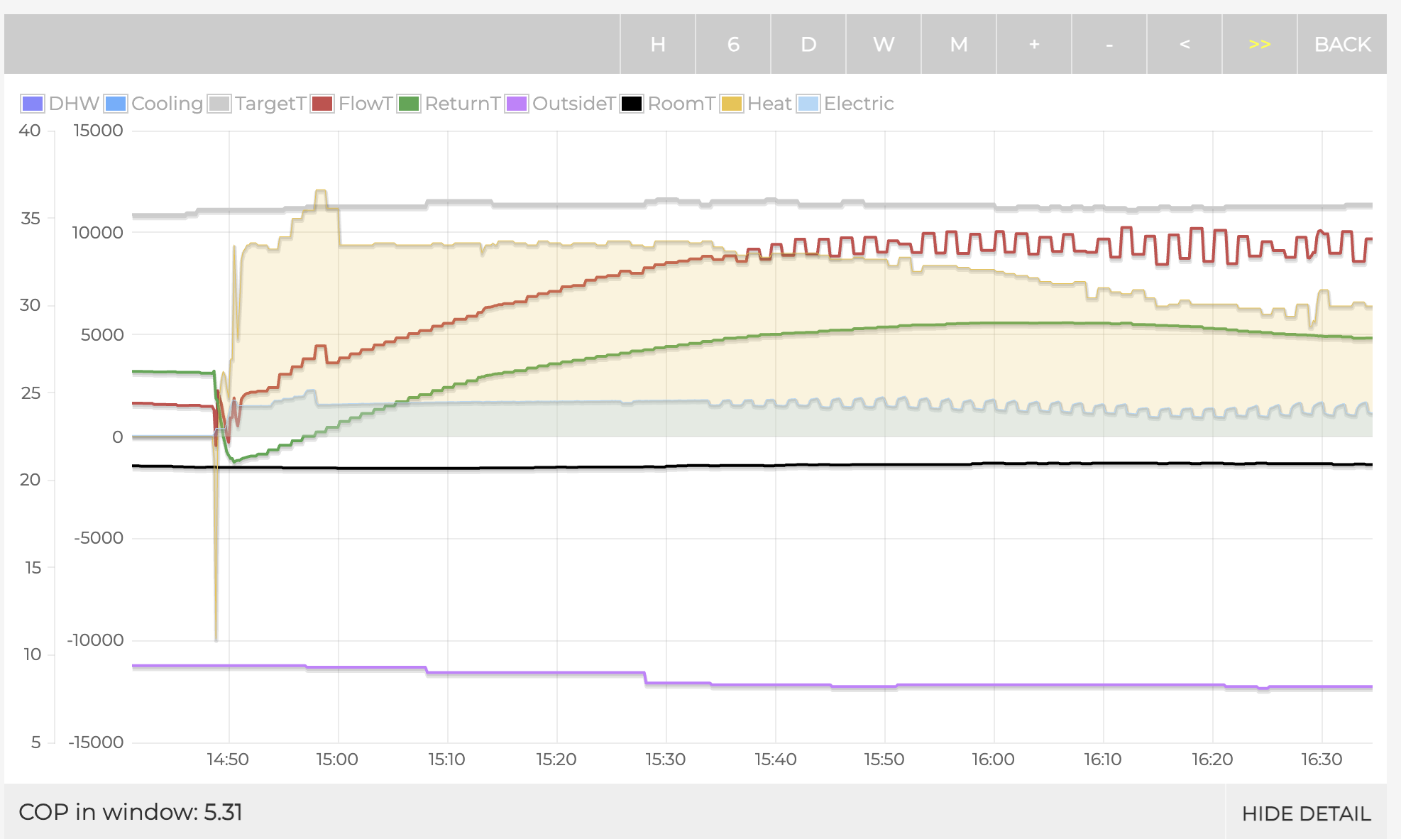

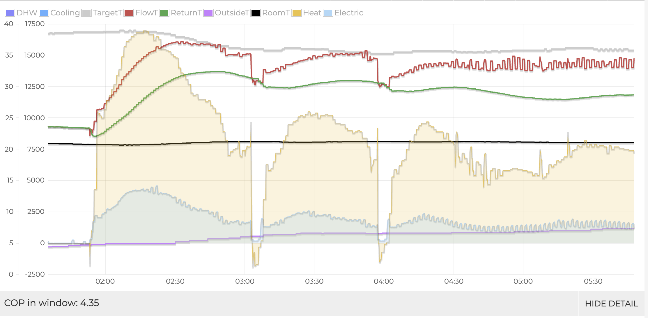

So I have writen an automation to help with cylcing when starting, I have found when starting the heat pump, it would ramp up to full power very quickly to get the LWT to target. Sometimes this would cause a few start stops before we got to a steady state. I am unsure why, maybe the fact the PWM pump won’t even attempt to ramp down for 20 minutes. Insights welcomed.
Fixed (ish)
I have built automation around the FR control to limit the compressor to an estimated 1.2x the heat loss of the house.
When we are doing DHW we limit to 50% (unless the water is really low and someone is trying to have a shower) and when we are doing CH we limit to what the heat loss is.
I am hoping this will help reduce the defrosts too
