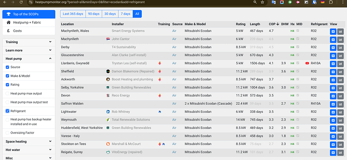

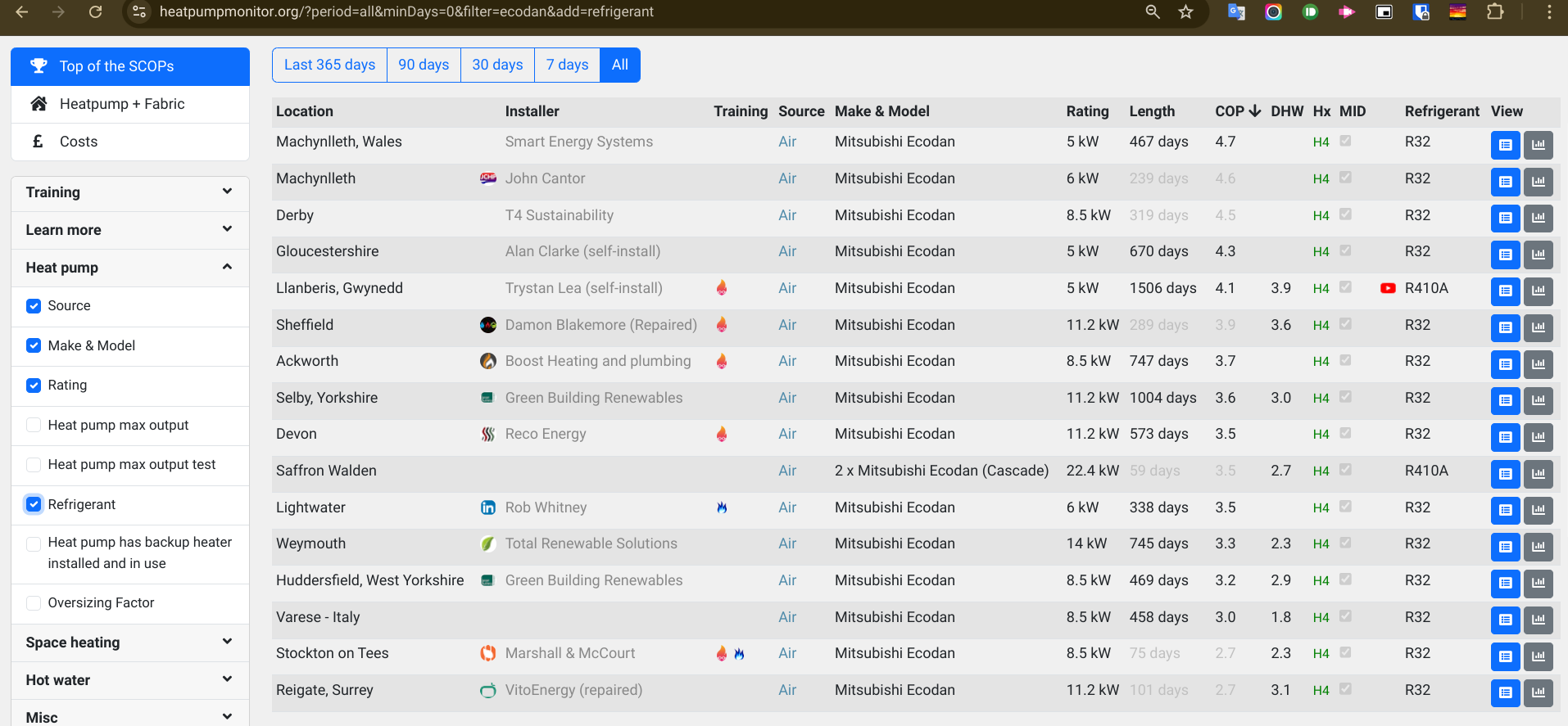

Interesting, I’ve not seen any data on an R290 Ecodan, all the systems on HPM are R32 or R410A.
See: https://heatpumpmonitor.org/?period=all&minDays=0&filter=ecodan&add=refrigerant
A R290 heat pump should never use the immersion, R290 can deliver a flow temperature of 75C. It’s debatable if legionella cycles are required at all, but 55C-60C tank temperature is plenty hot enough to kill legionella
