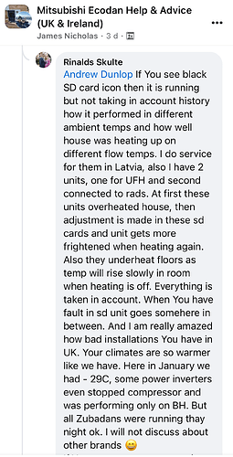

From the ‘Mitsubishi Ecodan Help & Advice (UK & Ireland)’ Facebook group:
I’ve always had the black SD card icon with white letters, indicating abnormal behaviour, rather than the white one with black letters indicating normal behaviour.
I replaced my SD card on Wednesday and the icon has gone white. Will see if AA gets better at adapting using a longer history.

Does anyone know if after any significant change to the hearing system whether it is worth resetting the FTC so it ‘relearns’ for Auto Adapt mode? How would I even do this.
It probably depends what we think Auto Adapt is actually learning.
The change I’ve made is to add a 50L volumiser. This might mean that auto adapt should expect warming up of the system to take a bit longer (System Volume).
I don’t think the auto adapt is as clever as some people make out. I don’t think resetting would help. Not certain though
