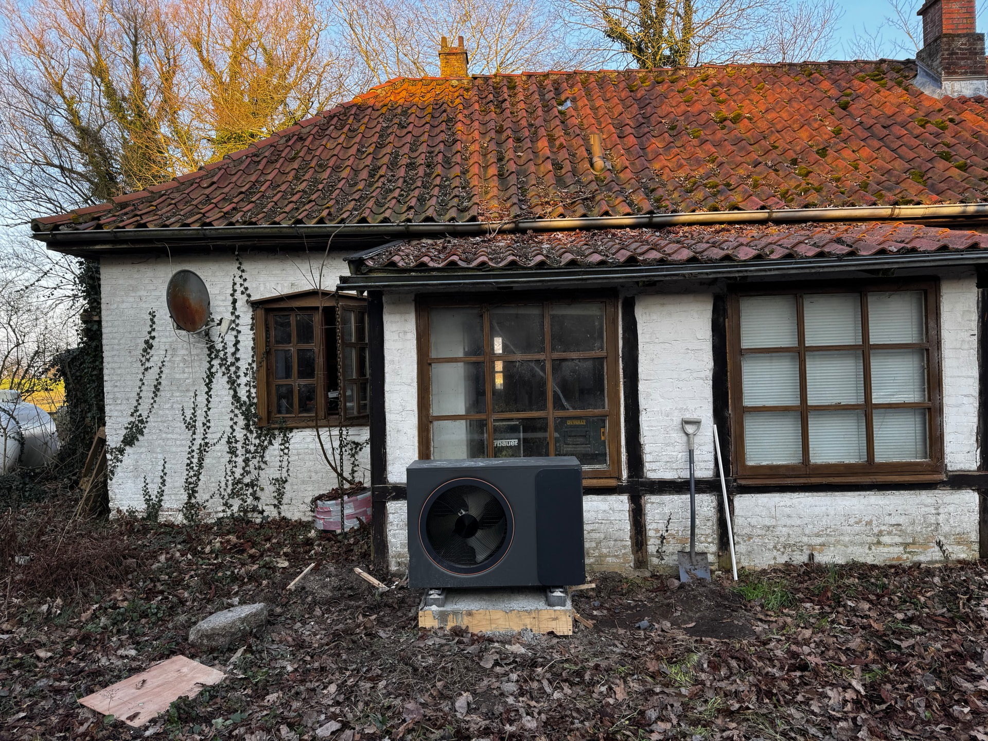

I’ve bought a refurbished one of these, for £550 to install in my father’s house.
It’s mostly vacant at the moment and connected to a 40 year old oil boiler that was burning thousands per year until I switched it off. As this house is in Germany an install by a plumber would cost about £30000, minus 70% grant, so still close to £10000. As this seems crazy and not worth it, I’ve devised this KISS system:
Refurbished Heatpump £550

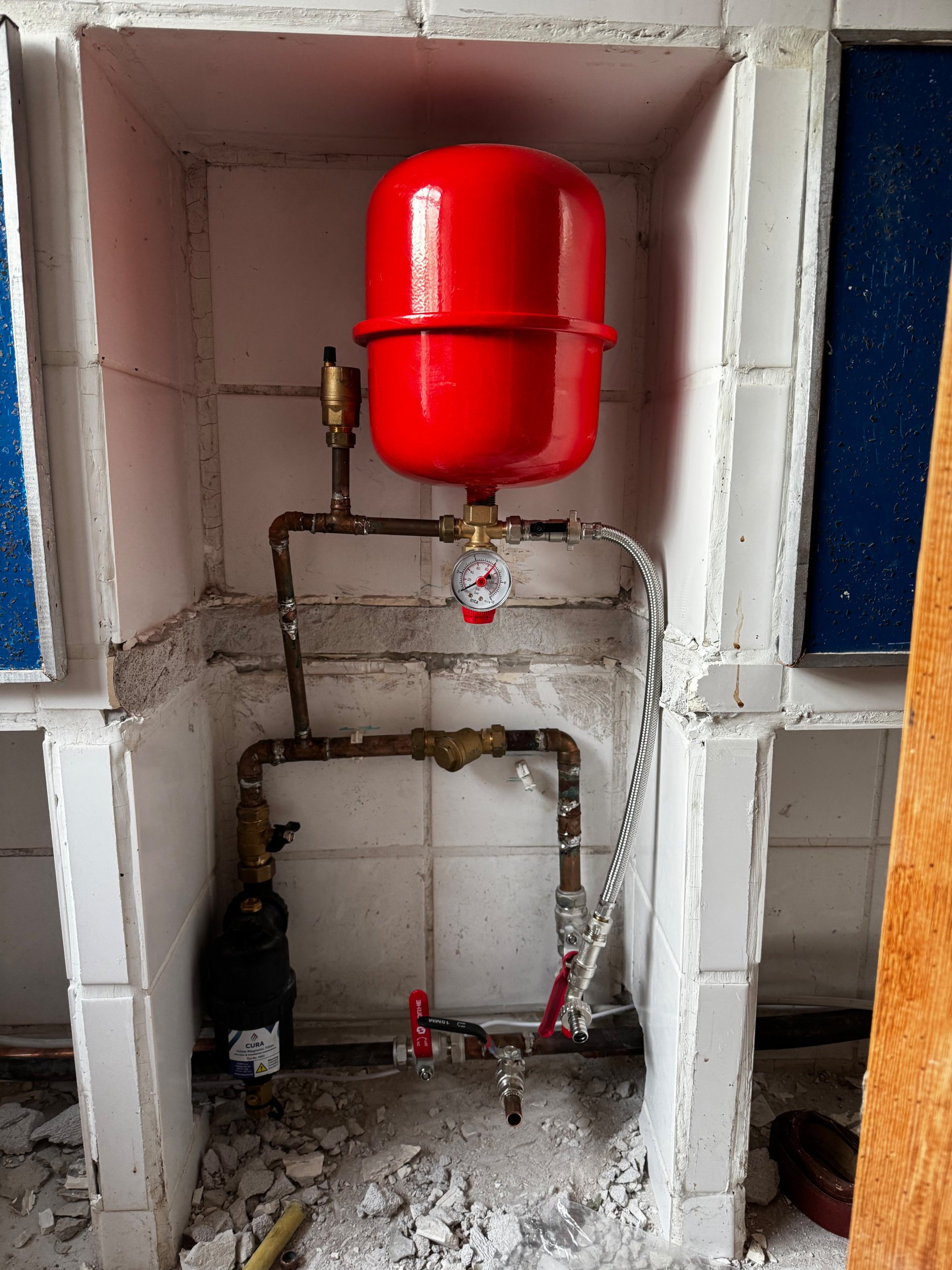

Bits from bes.co.uk (1 anti freeze valve, magnetic filter, y-strainer, expansion vessel, insulator, air vent, ball valves, flex hoses, pipe insulation): £350
Pipes etc I forgot: £200
So I should get by with not far past £1000. Am I missing something? Anybody got experience with this cheap as chips model? Hot water is supplied by an electric instantaneous heater. Thanks.

To answer my own question, in case somebody else wants to try this cheap approach:
Overall the cost ended up higher of course, having ignored all those little extras and the high price of copper pipes. All in it was £1400, without dhw support, just heating. Also my dad had been very generous in the number of radiators and used 18mm pipes throughout, so I didn’t change anything in the house, just connected the heatpump, plus expansion vessel and magnetic filter and y strainer, plus one anti freeze valve and removed all the thermostats. The house has only one kitchen/living room, plus two bedrooms, so as long as the living room is the right temperature I’m happy.
The heatpump itself seems fine, a little small maybe, which is going to lead to less then ideal efficiency. In the £551 that I payed for the refurbished heatpump, you get the Heat Pump and a tiny controller. The controller doesn’t include an indoor thermometer, so weather compensation or flow temperature control are the only control strategies.
