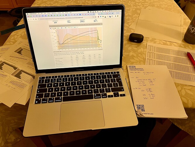

What else should we be doing on Saturday night than try and work out why your DHW runs are still no good compared to others.
So from those Vaillant technical charts I created these tables in excel that show expected COP at various flow temps as well as different outside temps. For both Eco (50 rps) and Normal (110 rps) for both the 5kW and 7kW Arotherm models.
I ‘filled in the gaps’ between the COP provided with a simple bit of spreadsheet jiggery pokery.
Using the new “instantaneous COP” feature i’m able to see where things seem to be going wrong.
If we look at Adam Heat Geek cylinder attached to his 7kW Arotherm you can see this steady decline of the COP inline with the increasing flow temp. See my purple addition there.
You can a very similar looking graph on @glyn.hudson parents 5kW Arotherm
Compare this to my Mixergy then.
I constantly see this terrible start. I’m getting COP 2 to 3 when the heating 30C water.
Glyn and Adam are getting COP 5 at this stage.
This must be where things are going wrong and where i’m missing out on early high COP?
When the flow gets to 50C things are on track and i’m getting around the COP that should be achievable.
So now I can see what’s going wrong… how to fix it!!!
Note: Neither Adam or Glyn hit the exact COP output, there are always a little down on “expected output”, but assume there’s something about DHW that stops this.
UPDATE1: Interestingly, here’s an Eco mode run from August I did. It looks better. It’s still 1.0 COP lower where it should be for 35 flow, but much better than in the 2.0 range.
Is “Normal” mode just trying to throw too much heat into the situation from the off?
