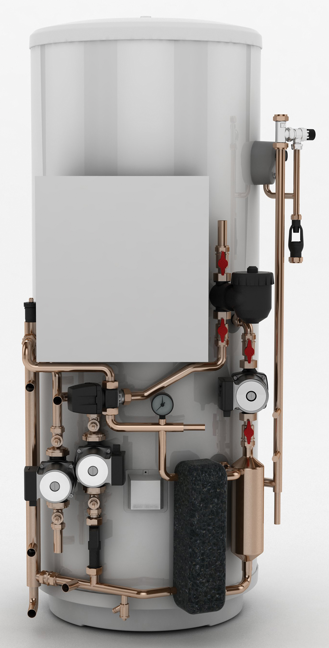

Grey rectangle with 4 pipes is the HEX, in the bottom half of this 250L cylinder. Hot flow from HP enters top left, return is bottom left. I therefore assume that top right takes cold from the bottom of the tank, and bottom right is the hot water that goes up through shiny descaler and pump, and re-enters the cylinder about half-way up. Full picture here.
I can only guess what the flow pattern is like within the cylinder: if the returning water isn’t as hot as what’s already in the middle, then it will sink to the bottom and go round the HEX again. When it gets warmer than what’s in there, it will convect upwards, pushing the cooler water downwards?
I’ve just noticed that the circulation pump between the cylinder and the HEX has 3 speed settings, and is currently set to “2”. Is this worth messing with, or should I leave it well alone?

To answer my own question, the manufacturer’s installation instructions explicitly says:
Ensure the DHW circulation pump is set to speed setting II to ensure optimum DHW heating performance. Failure to do so can result in excessive use of the back-up immersion heater or lower storage temperatures than required.
Purple = flow/return on the heat pump side into and out of the plate.
The red circles indicate entry/exit points on the cylinder.
