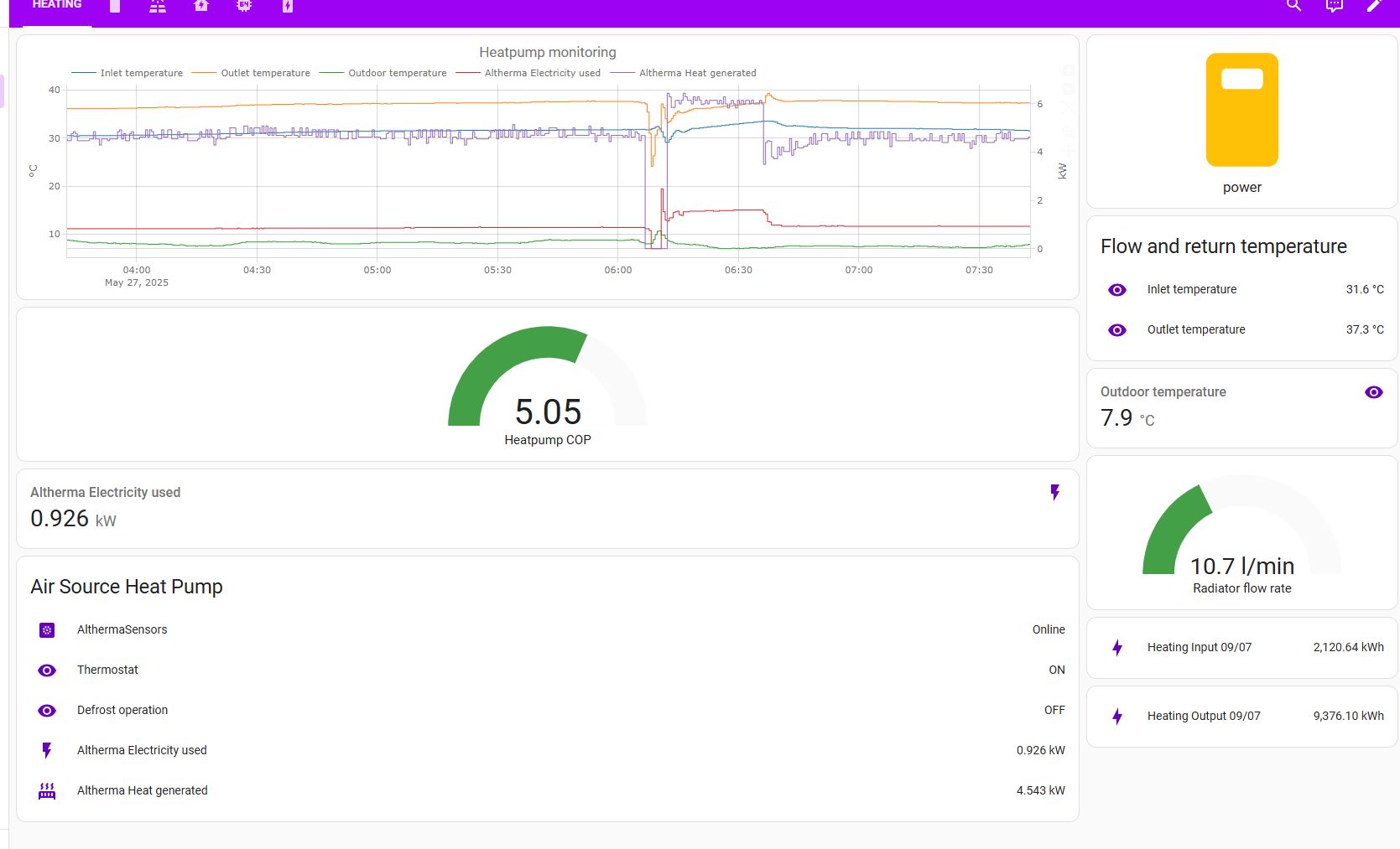

Interesting discussion. I went through on the same process in the last (my first) heating season. I have started an 11kW “noname” heat pump, and spent two months to try to set up all the PID values on the compressor and the circulating pump, to reduce the cycling frequency. In my case, I have a couple of fan coils, which made the process even more difficult. Finally I replaced the HP for an Altherma 3, 9kW unit. I have to admit the 7kW would be more adequate, so the HP is still oversized. Here is what I found during setting it up:
-flow rate needs to be reduced, to do not exceed 25l/min. (pump speed + valve)
-I’m using UF heating as emitter, to keep DT as low as possible.
-I set the overshoot to low(ish) 2 degrees
-took me quite long time to get the weather dependence right.
-my room thermostat is only work as a “timer” and a manual on/off switch. I cannot run the HP all day on our climate.
Status update after 18 months.
-I have reduced the fancoils to1 ( I cannot accommodate the equivalent static radiators to the room)
-Increased the water volume by upgrading some of the smallest radiators.
-Weather compensation works fine, 33@10 degrees to 45@0.
-Pure space heating, one zone and implemented Home Assistant external temperature control (more refined control than limiting by external temperature only on the HP interface).
-Still playing with delta T, increased to 5 from 4 Degrees but it feels even 6 can be achieved.
-Flow rate is around 10-11l/min while it is in equilibrium and the max is limited to 28.5l/min (pump speed limit only, no valve restriction).
-general COP is over 4.5 (between 0 and 8 degrees), below 0 it drops below 3.5. Doesn’t happening too often.
-Minimum sustainable power consumption is around 800W (775W was the lowest, mainly 826W)
Waiting for the winter to see how it performs, but it is pretty settled at the moment. I’m also thinking about to add DHW to the equation, but it is pretty difficult to connect to he HWC.
This is how an average morning looks like:
