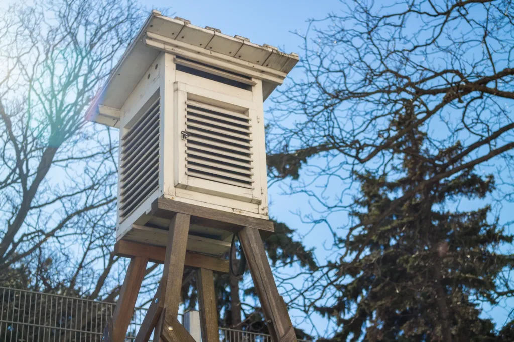

I might try something like the Weather station housing.
These are designed to give a true ambient temperature regardless of sun and shade.
Bolting the sensor to a cold north facing recessed outside brick wall, as the installers did, can’t be right..
Here’s a mini one that’s turnkey and cheap. Might not be big enough though
Aliexpress have very cheap ones..
Maybe of interest: Stevenson screen - Wikipedia

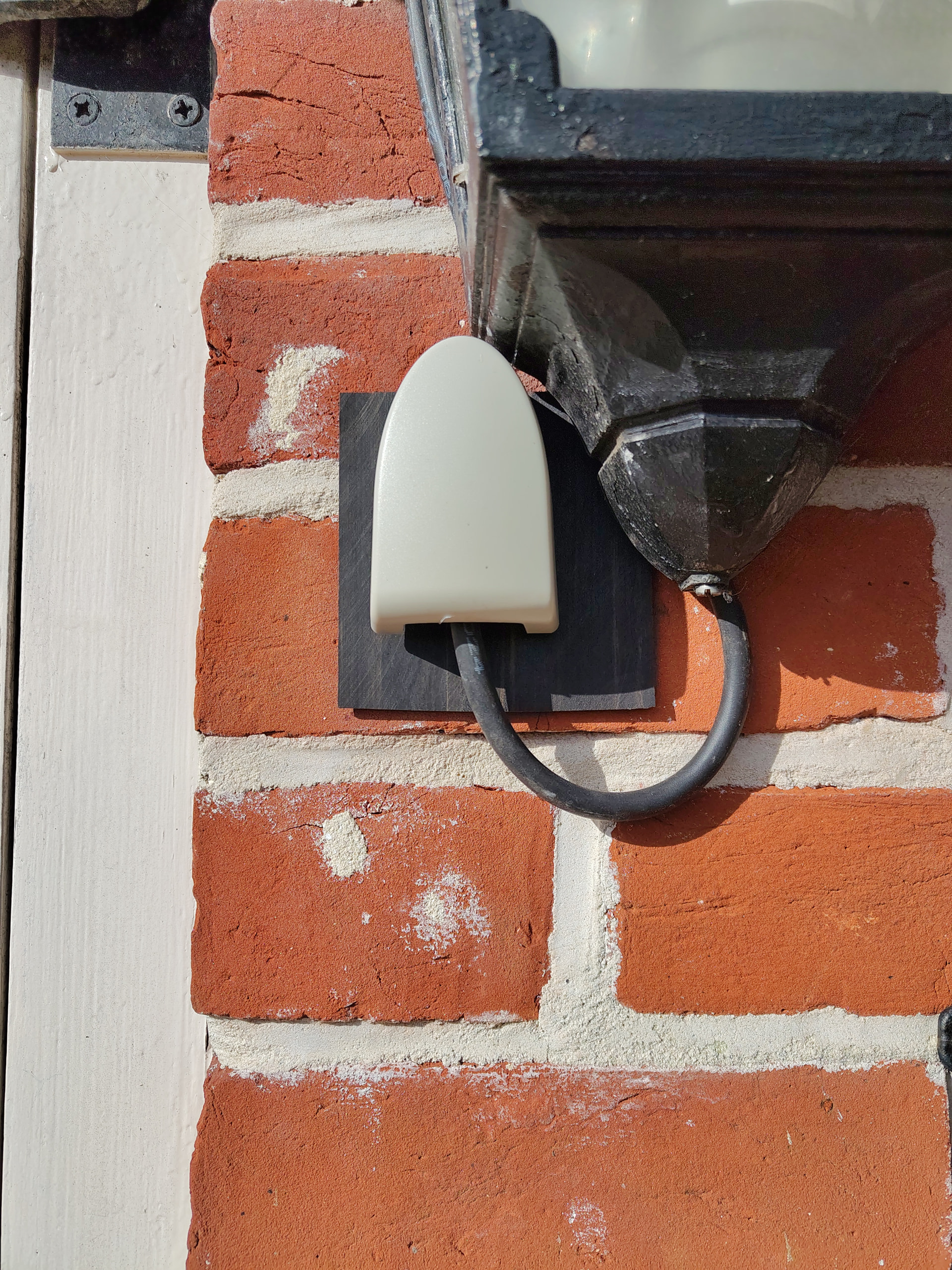

I’ve moved our external temperature sensor from a very sheltered north facing spot (I was in a cold sheltered spot with brick and tiled roof on 3 faces around it), to under a thick wooden soffit on the south / sunny side.
The sensor is never in direct sunlight though.
Now instead of the temp sensor being about 4 to 5°C lower than ambient and it entirely missing the amount of solar gain the house gets when sunny, it actual tracks what’s going on much better!
It’s still in the shade as it were, but it feels what the house feels.
When there’s no sun, it’s also showing the correct cooler temperature.

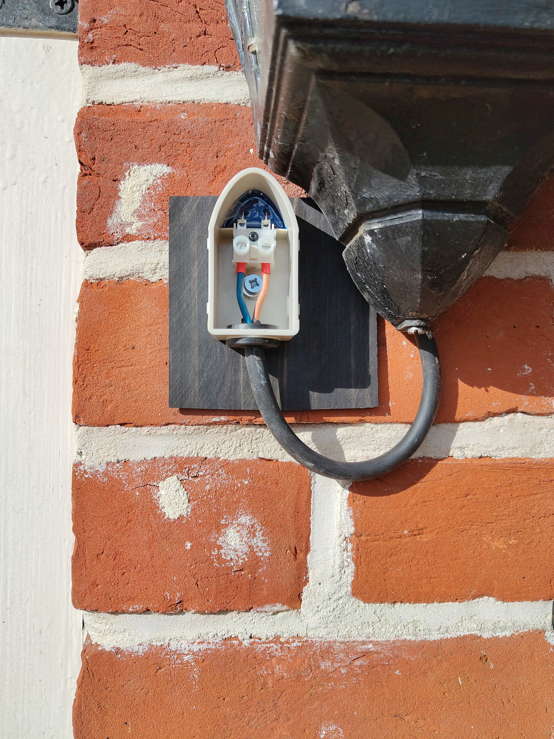

The sensors are a two-bit part.
Simply a two wire thermocouple / 4 screw connection block to the cable.
The cover just pops off. One central screw secures the base.
Really easy to replace / move.

A quick update on the solar gain and temperature sensor placement.
I tried various placements over the last couple of weeks.
We’ve had usual Feb/March weather.
Sunny warm days and cold cloudy days etc.
I don’t think the mid winter sun will have enough power to heat the sensor to throw it off.
The absolute best placement for the temperature sensor for our house is in full sun on the front side with a black background to capture even more of the sun’s heat to push the sensor temp sent to the controller higher.
This and only this throttles the Heatpump inline with the amount of solar gain our south facing house gets.
How it looks
Cover off, single mounting screw.
Cover clips on.
