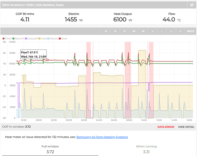

A new setup and feed, based on the eBUS Adapter Shield C6 and linking to emoncms on Home Assistant which then feeds to the public version with a Vaillant 12kW Aerotherm+ in a 1929 bungalow!
The emoncms says that I have air in the system, but it is happening each time the hot water heat kicks in after a few hours “off”. I have a “leaky 3 ways valve” so it loses heat faster than expected so I have hot water heating set for when I need it or electricity is better value.
And…
I can’t find a field from micro-ebusd that I can use to say the water is being heated as the Vaillant integration has limited translations.
So, when it gets a large increase in heating, the emoncms thinks it is a fault with air in the system.
Any suggestions on how I can resolve this?
Thanks in anticipation
Jan
Quick update
The error was caused by sampling rates being inconsistent. I had tried the Home Assistant MyVaillant integration, but it was cloud based and at the very best “variable”.
I have now implemented an ebus setup and learnt how to request data when it is needed.
