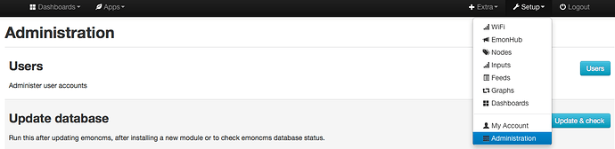

Hi,
I finish to update , however Administration item is not available in Setup.
I can access it directly with the URL only.
How can I solve this? Thanks.
I have:
Emoncms Version 9.7.9 | 2017.01.05
Modules admin app backup config dashboard device eventp feed graph input nodes openbem process schedule time user vis wifi

Could you post a screen shot?
What browser are you using?
I am using: MacOS X 10.12.3… Safari 10, Firefox 49, Chrome 55. All them the same problem.

Can you access the admin page if you browse to http://192.168.1.11/emoncms/admin/view ?
  • Was the admin menu visible previously?
  • Did it disappear after an update?
  • Have you made any changes to the standard emonSD?
Could you post the ‘emonpiupdate.log’ this can be downloaded from the admin page, you will need to access via the URL!
Not sure what’s going on with your power feed. Best also include 'emoncms.log and ‘emonhub.log’ so we can try and work out what’s happened.
  1. Yes, I can access admin page with direct url.
  2. Yes, menu were visible before update.
  3. No, I use standard emonSD.
  4. Yes, added update LOG file.

Ah, looking at your logfile it seems your running the older emonSD-17Jun2015 emonSD. This is probably why I can’t recreate the issue.
I would highly recommend updating to the latest Nov 16 emonSD… The backup module (http://192.168.1…11/emoncms/backup) can be used to migrate all your data.
However this is not the cause of the issue, the update should work ok on the older image. Looking at your screen grab it looks like you might have manually updated to emoncms V9? Is this true?
Looking at the update log I can see lots of files (emonhub & emoncms) which have been manually modified, these modifications will stop the system from pulling in any new updates.
I think the cause for the admin menu missing is the device module is installed. This is not a module that is installed by the standard on the emonSD, did you install this module? If your not using the device module could you try removing it by deleting the folder /var/www/emoncms/Module/device/. The device module has taken the place of the admin menu in the menu. The device module is an older unmaintained module and does not have the correct menu manifest config to work properly with Emoncms V9
Glyn,
SOLVED!! Just remove device module and Administration came back.
Thanx a lot.
