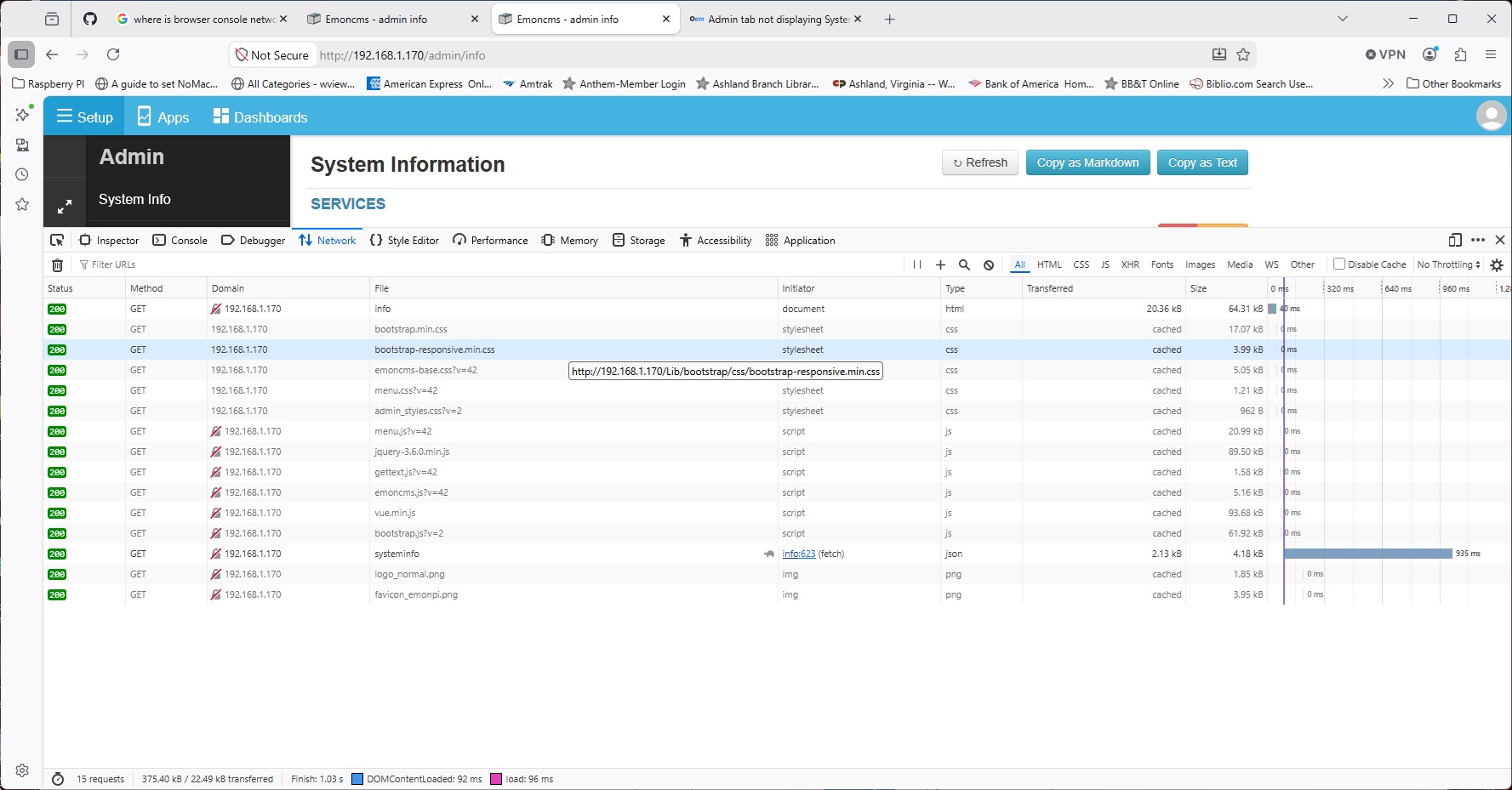

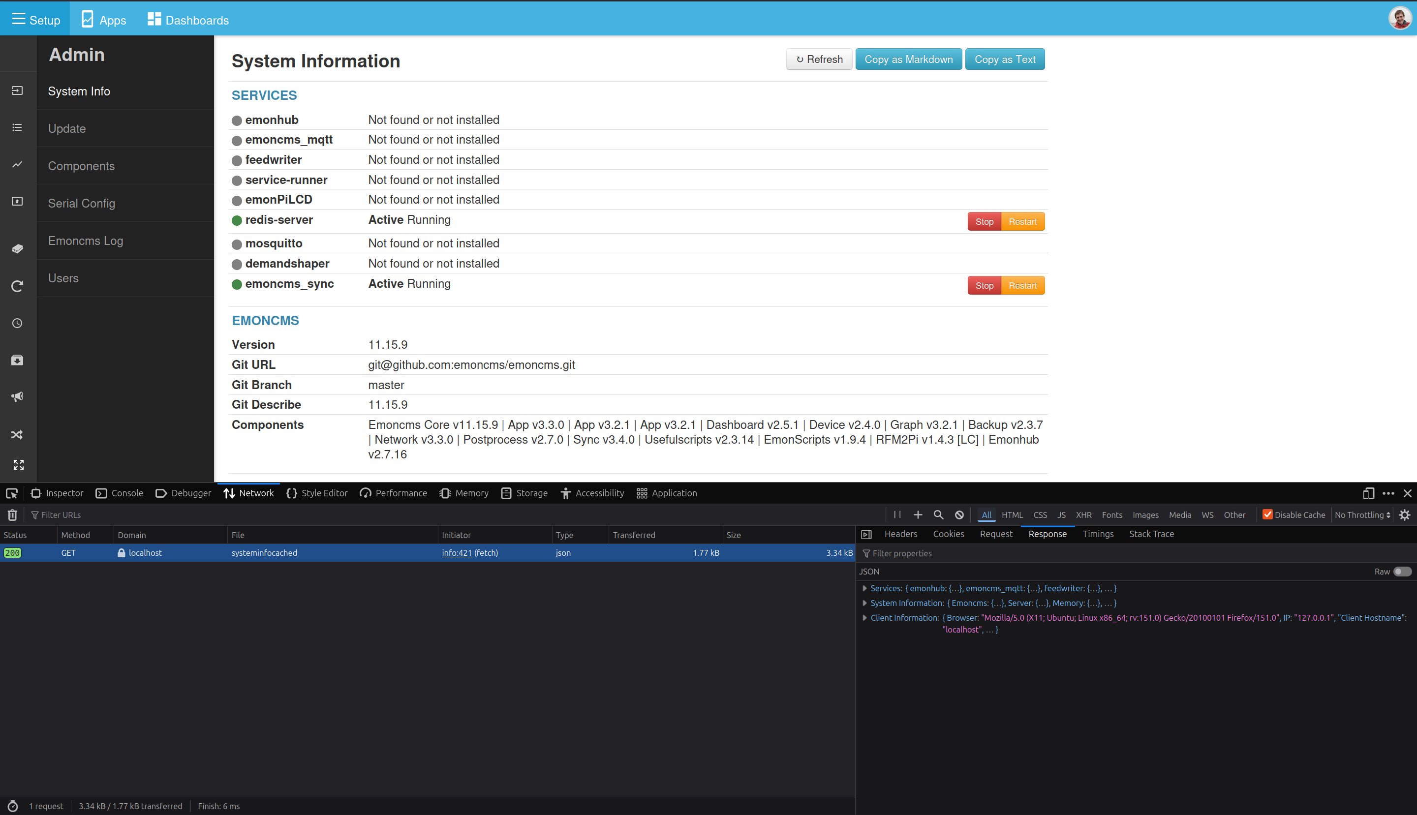

Hello @bgrattan this seems to be working fine for me. Could you check your browser console network tab to see if there are any errors in the system info api response, e.g:

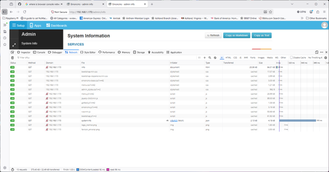

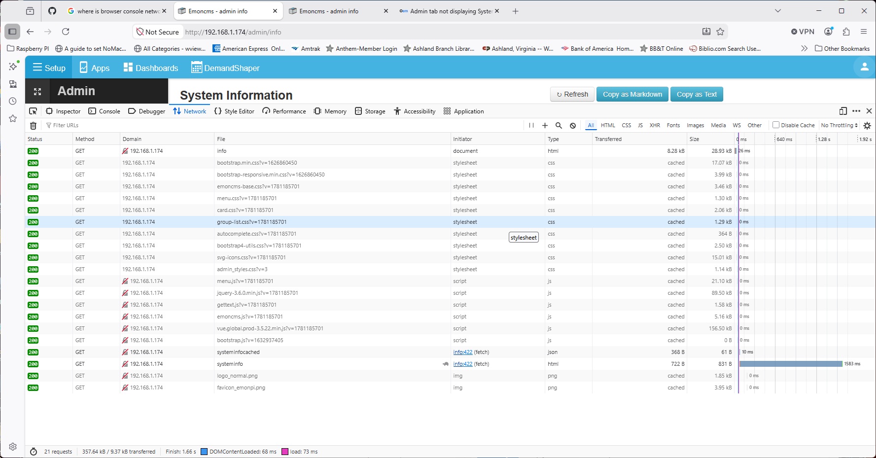

Thanks for the reply. I have a screen shot of the working system info page 192.168.1.170 (latest SD) and the non displaying one on the earlier SD 192.168.1.174. Both are RPI4 systems. I have tried various browsers on several computers (iPad, ubuntu, win11) and all have same problem.
I hope you can read these ok. Cheers, Bob

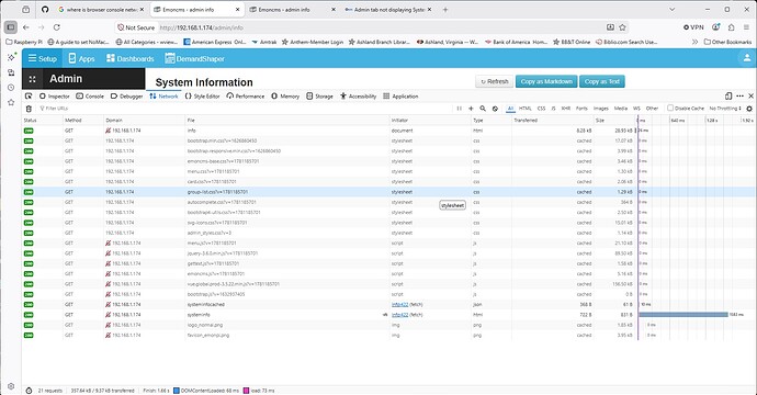

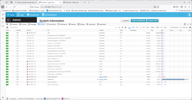

Sorry, here are better pictures:
Thanks @bgrattan can you click on the systeminfo result there to see what it returns. Or actually maybe easier just try this directly http://192.168.1.174/admin/systeminfo
http://192.168.1.174/admin/systeminfo:
Fatal error: Uncaught TypeError: Argument 1 passed to SystemInfoModel::formatBytes() must be of the type int, float given, called in /var/www/emoncms/Modules/admin/info/SystemInfoModel.php on line 270 and defined in /var/www/emoncms/Modules/admin/info/SystemInfoModel.php:237 Stack trace: #0 /var/www/emoncms/Modules/admin/info/SystemInfoModel.php(270): SystemInfoModel->formatBytes(8282427392) #1 /var/www/emoncms/Modules/admin/info/SystemInfoModel.php(814): SystemInfoModel->getMemoryInfo() #2 /var/www/emoncms/Modules/admin/admin_controller.php(133): SystemInfoModel->getSystemInfo() #3 /var/www/emoncms/core.php(111): admin_controller() #4 /var/www/emoncms/index.php(249): controller('admin') #5 {main} thrown in /var/www/emoncms/Modules/admin/info/SystemInfoModel.php on line 237
