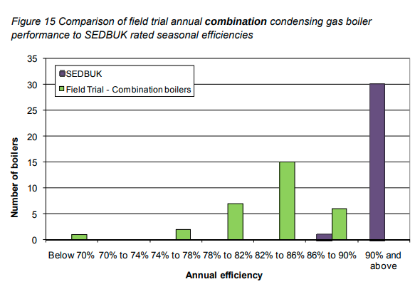

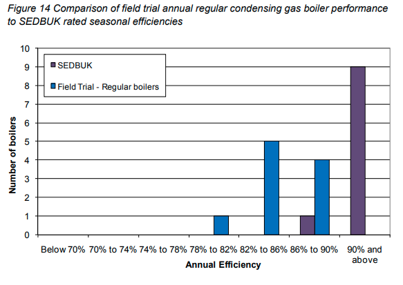

Gas boilers will be around for many years to come. However, at some point, the cost of running gas boilers might become much higher compared to heat pumps. Currently, well-installed heat pumps (+3.5 SCOP) might have overall advantage but for those who already have a gas boiler, it might not quite make economic sense to replace it with a heat pump just yet, especially if your gas boiler runs efficiently at over 90% on average.

The Costs tab shows Heat p/kWh for a selection of tariffs. This is an easy way to compare against gas costs (so long as reader appreciates that gas systems are typically only 85%* efficient).
(*This government field study [PDF] shows that few systems are getting above 90%)
