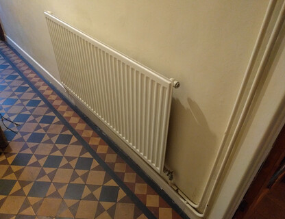

I changed all the radiators and pipework in my house as I believed at the time that my heat loss was much greater and that the low temp R410a heat pump would have been unable to supply the temperatures required (~67C flow temp). In reality at my measured heat loss that same single panel radiator system would have only actually needed a design flow temp of 47C which technically is within the operating range of a low temperature heat pump ..
One of the original radiators:
I actually thought my upgraded radiator system had a design flow temperature of 47C based on the original over-estimated heat loss (before I understood the issues with over-estimated heat loss calcs), in reality it only needs ~36C and hence the SPF of 4.2, which would be even higher with a newer heat pump.
