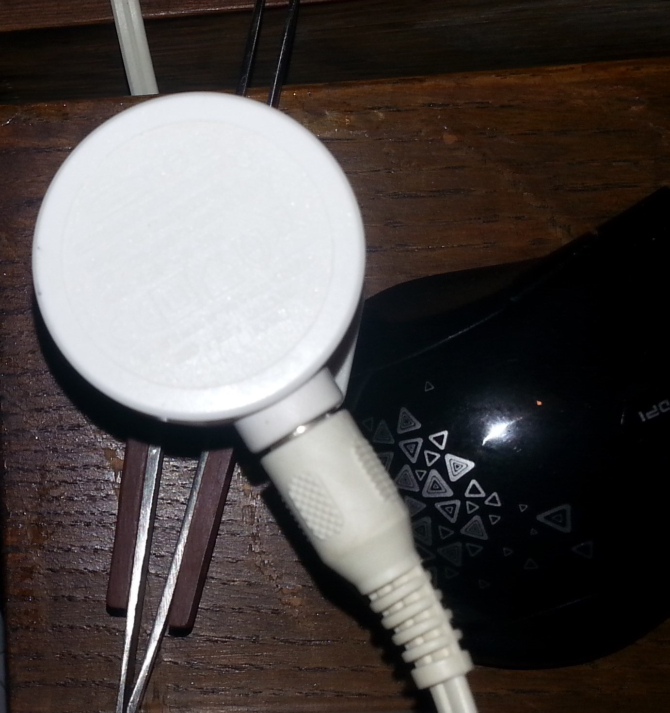

Ikea don’t use labels it’s stamped into the adaptor and almost invisible under a magnifying glass and LED.
Let me see if I can find the lamp on Ikea’s website.

I would say it’s an AC supply as confirmed by the embossing by Ikea.
Image below but you’ll probably not be able to read it.
Yes I have the 470K bias pair, I’ll drop in the 100 μF and see what it comes up with.
You’re right, I can’t read it. You needed a very low angled light to give bright edges and to throw shadows.
