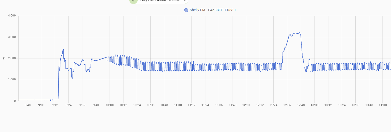

Good afternoon. Looking for information on the heat pump that I installed in my home, located in an internal area of ​​central Italy, I came across your site. My system consists of a Samsung AE120BXYDEG/EU + AE200RNWMEG/EU and the MWR-WW10N remote control. The heat pump heats a house of approximately 250 square meters (with aluminum radiator system) on two floors in the countryside. A damp and cold place in winter. The system seems to work quite well but I have some doubts that I think you can help me resolve. The settings for WL are “2011” -5°" and “2012 15°” while the water outlet temperature is “2031 45°” and “2032 35°” the ASHP is controlled by remote control with an internal temperature of 19.5°. The pump takes almost the whole day to reach the set temperature but I noticed that it continuously modulates with an absorption that varies depending on the outside temperature. This can be seen in the attached photo.
I also don’t know if the COP is reliable by detecting the data recorded by the MWR-WW10N regarding the electrical consumption and the energy generated. I think that the energy consumption is calculated including the production of hot water. You can see the peak of 3 KW for about 25 minutes relating to the production of hot water. Using the data from the remote control I have a COP that varies between 3.6 and 3.9.

Are you able to share a few more details of your installation? Do you have a volumiser/buffer tank? Do you have a fixed speed or PWM circulation pump? What is the typical circulation rate/LWT/RWT and do they show the 2-minute variation like your power consumption does?
On the face of it, your Water Law settings are reasonable (though maybe slightly high according to the CoP chasers on this forum) and your house heat loss (from 1.7kW consumed x 3.75CoP = 6.4kW) is believable for your house size if you live half way up the Apennines, at this time of year.
That your house takes a long time to reach roomstat setpoint is not unusual, especially if you reduce it overnight (“setback”) and your house is not well insulated and/or your radiators are too small.
Apart from the apparent compressor speed variation, which might be explained if your system volume and controller hysteresis are small, you seem to have a reasonably well-controlled arrangement.

You may want to consider slightly raising the WL curve by increasing #2031. This will make the heat pump heat the house faster, although COP will be reduced. You could also consider reducing the nighttime setback.

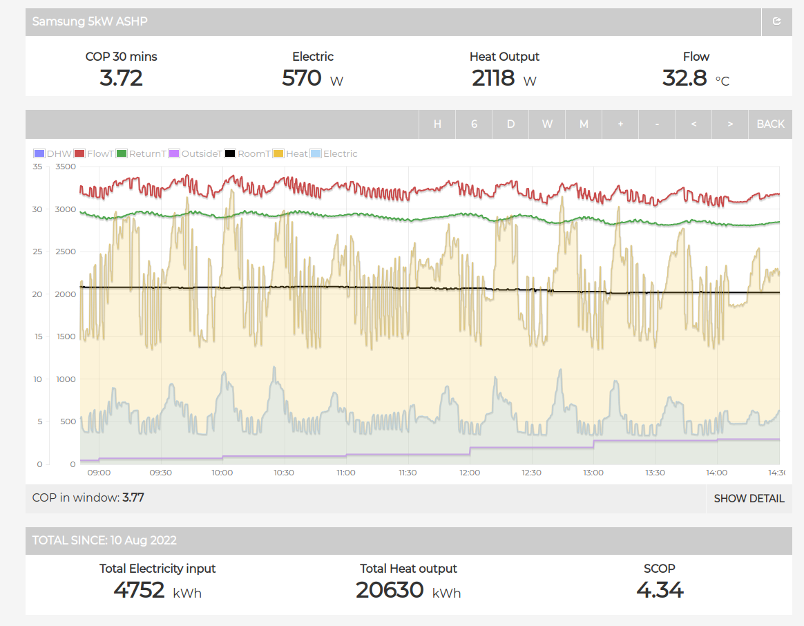

This modulating electrical input is quite normal for a Samsung, take a look at the other Samsung heat pumps on HPM: HeatpumpMonitor.org. It’s nothing to worry about. It looks like your heat pump has been setup well.
e.g

The system has a 25 liter buffer tank and is separated into two parts the heat pump sends hot water to a heat exchanger that has its own circulator that runs at a fixed speed and sends water to the radiators. The technician who made the system insisted on putting this heat exchanger. I didn’t agree much especially because in my opinion this way a loss of efficiency is generated. However the system seems to work, in this period it is only turned on from morning to evening for about 10 hours, so I can make the most of the photovoltaic production. The following morning the temperature is about 18.2 degrees Celsius with a night loss of about 0.7 - 0.8 degrees Celsius. The house has very thick walls of 80 cm on one side and 45 on the other the windows are very well insulated and the attic has a 12 cm rock wool coat. The temperature during this period also dropped to zero degrees and I was able to observe some heat pump cycles which I assume were for defrosting.

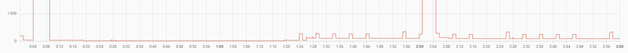

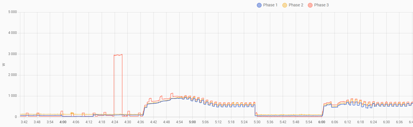

You may see some funny spikes every 5 - 10 minutes intervals starting 1:25. Don’t know what is it could be heater for dripping tray or pump running because at night the pump is turned off.
