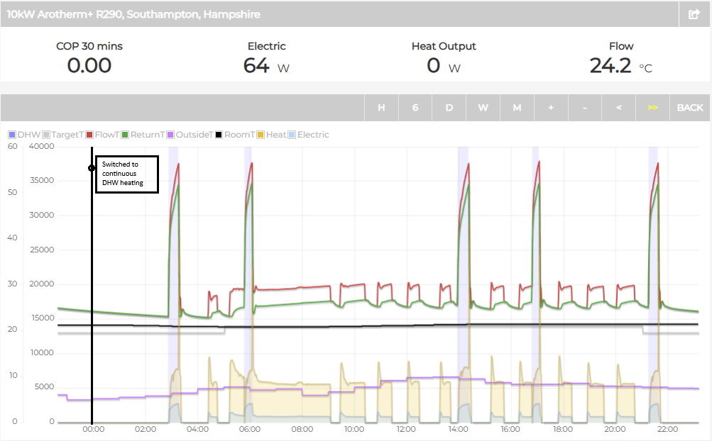

Ability to add date/time markers with notes that persist
Many timeseries based systems, particularly analysis tools like log aggregators, let you put markers in the timeline to donate when a specific change started. In the software company I worked in we would always add a marker into our logging system every time we pushed a new release to our cloud platform. This enabled us to identify changes in our logs as a result of our software release.
Looking at the community we’re always changing settings of our systems to improve efficiency, but its difficult to remember exactly when you made that change in order to analyse the impact maybe a month or 3 months later. I think the ability to add simple marker that would display a black vertical line at a specific time and date, plus a small note that would pop up when you hover over it would be a great addition. It could be implemented as its own timeseries. Something like this …
