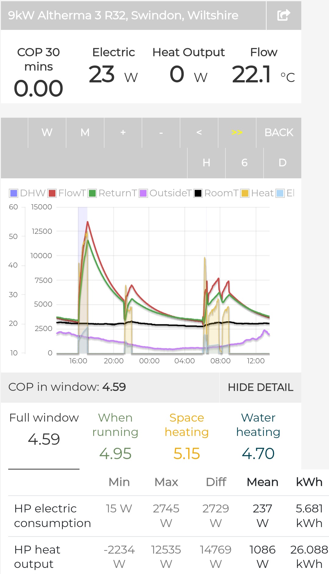

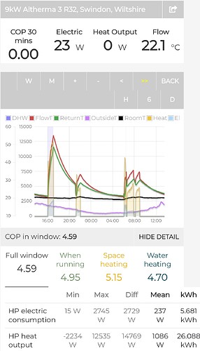

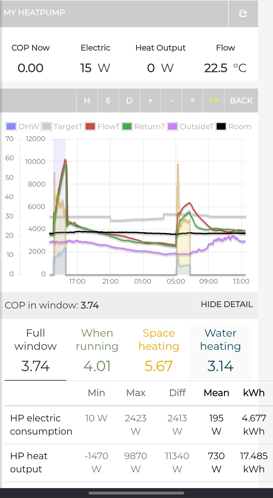

It is quite interesting to compare our data, you can see from below that my pump would have cycled like yours without my intervention from HA. It also looks like my homes heat demand/loss was less over the same period, with similar indoor temperatures and a slightly lower outside temperature in ipswich overnight, which is really interesting. We have bedroom windows open overnight too. What are your thoughts?

Looks like changing to Radiators with DT8 is caused the unit to cycle due to the overshoot, reducing efficiency. A direct result of the minimum modulation issue with the low heat demand.
Not a very big window of operation, so in colder weather it might work better.

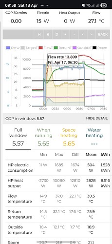

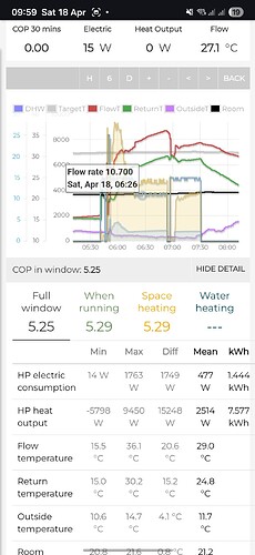

Yesterday UFH DT5:
Toady RAD DT8:
Reduced efficiency, but also reduced energy consumption, which one do you really care about?
You also had a ‘large’ defrost cycle shown on the second graph - this might be what you’re looking at rather than cycling as such.
Definitely both. The operation windows are too small to draw a conclusion, and not identical conditions, warmer internal and external temperatures today. This shows an 84w (0.84p) power saving but with 936w less heat output.
Ahh yes, thank you. It looked like a cycle on the graph. Odd that a defrost was needed when outdoor temperature is higher than yesterday.
