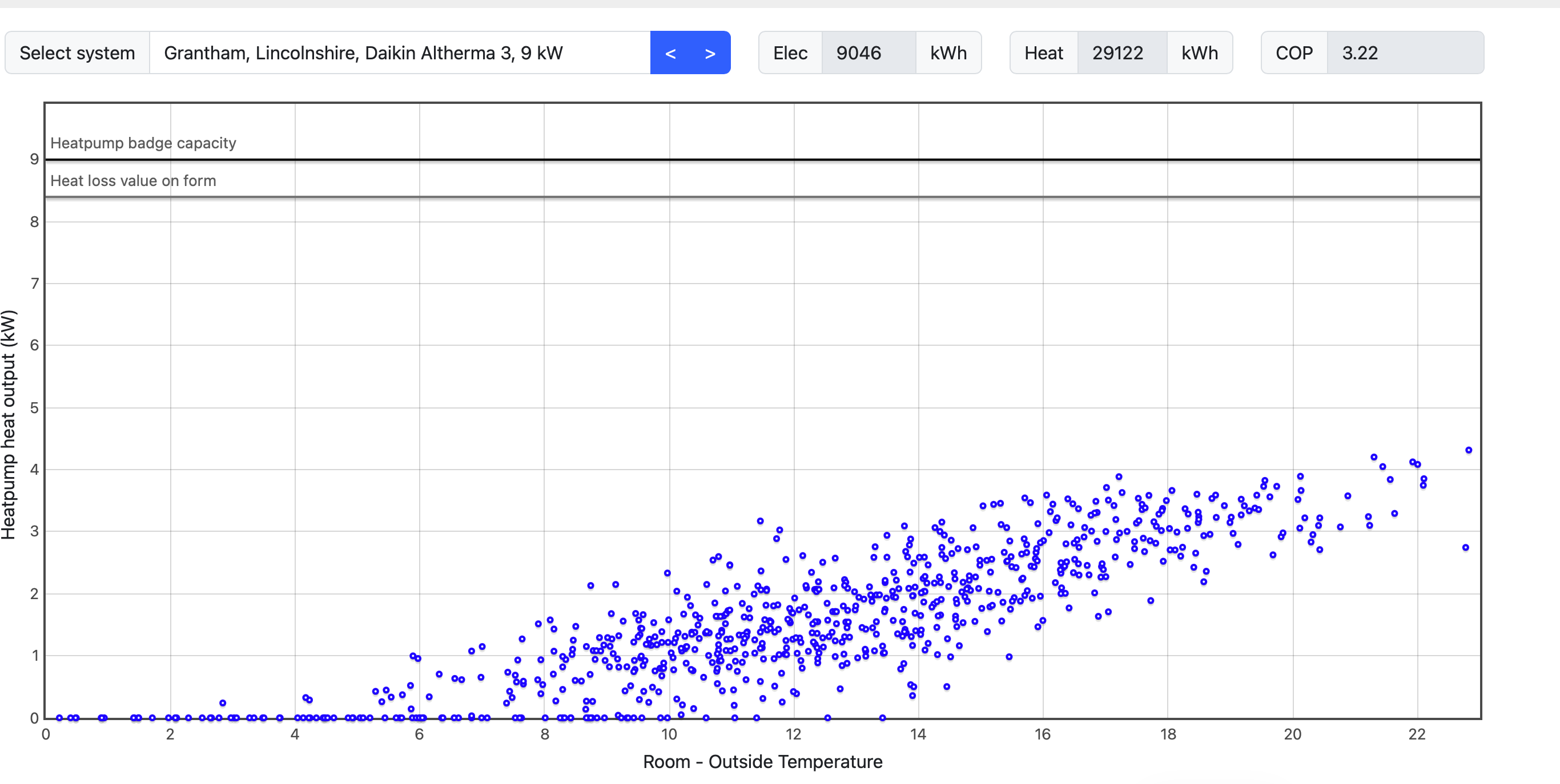

If I am looking at the heat demand tool right, it looks like my heat loss is far less than calculated?
I need some definitive proof to show Octopus. I did a heat Punk survey which calculates the heat loss at 7.1kw. They calculated it at 8.2
Even at 7.1kW Octopus wouldn’t install the 8kW as they say that figure doesn’t take into account defrosts. I’d be surprised if they went with a swap unless you demonstrated a significant different between your heat loss and their calculation.
However, if I’m using the heat loss calculation tool properly, it appears to show your actual heat demand to be 5.67kW. Though you really need a full seasons worth of data here and you only have data for March and April.

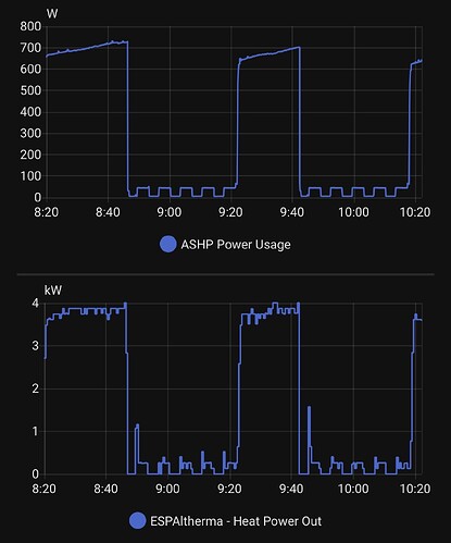

How accurate is your power monitor? Your data shows a steady minimum input of about 846W whereas other 9kW devices are around 900W. Could it be under reporting?
Good luck with your Battle. I have a 9kW Daikin fitted by Octopus and have been trying to get it changed for 2 years. I have had an independent survey that shows the pump is oversized, also Daikin say it is oversized. Currently have a complaint lodged with Napit so awaiting the result of this. My advice is to you is to gather as much data as you can to prove your claim.
I am using a Shelly emPro. I think the lower power consumption is due to the pump speed limit I have enforced, it prevents the system getting saturated on startup when the pump is normally ramped up to full speed and it chucks a load of heat into the house unnecessarily.

My HA yaml to decrease cycling when using LWT

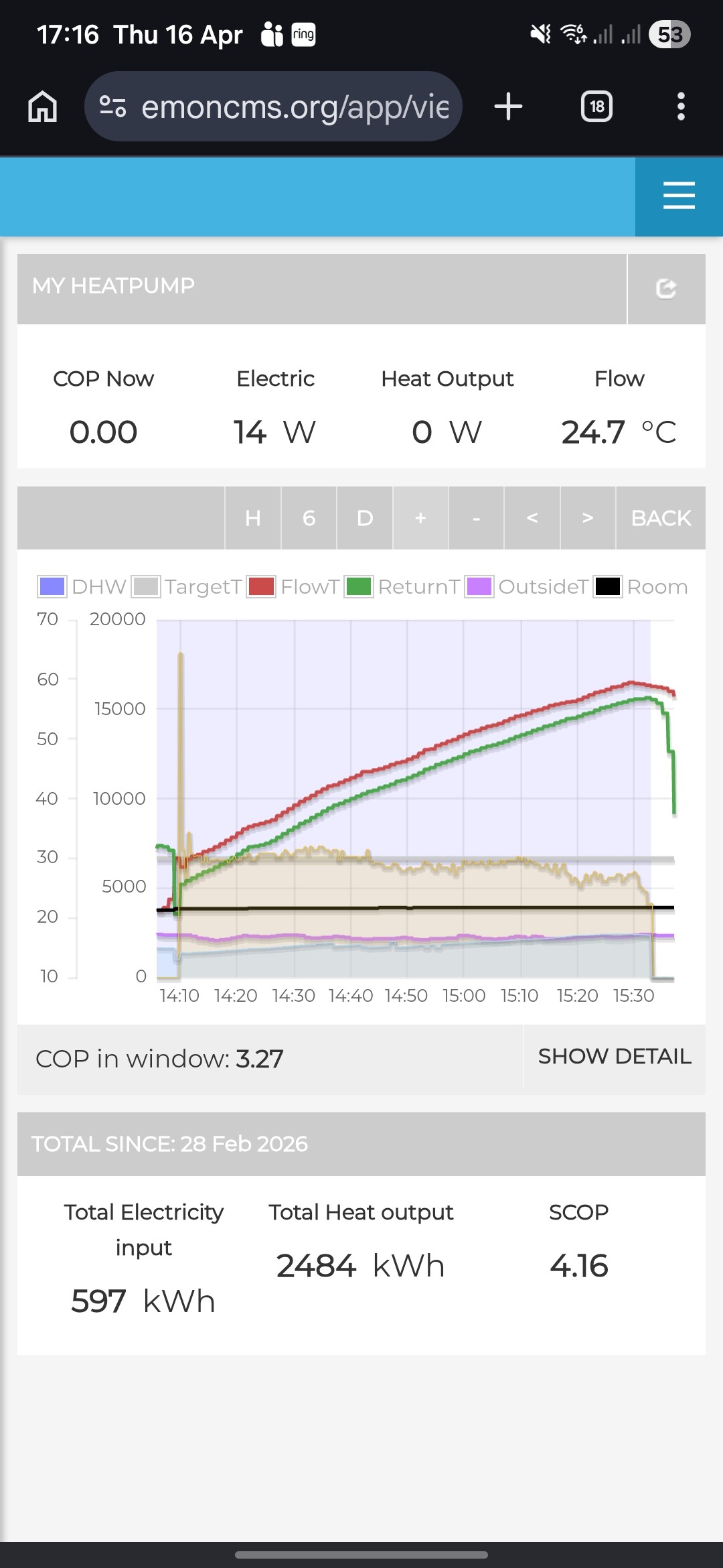

Our 9k Daikin was installed just over a year ago so I now have a full years data (via emonCMS and HA) and have just put a full report together showing a measured heat loss demand of less than 6kW.
I began pushing back on the install in April/May last year but only had minimal data of course. In July, I agreed to run through the winter to explore more but of course, as with everyone else with the 9k, the cycling continued.
I’m waiting for a response currently.
Incidentally, from a host of threads here and elsewhere, I found the best settings for our situation has been:

My independent survey show heat loss at 5.56kW. This is my graph from HeatPumpMonitor.
Thanks, I suspect I will need to get some solid winter performance data before I can put together a solid case.
I can’t see how Octopus can argue with your data. I am starting to think that there is enough people having the same issues with oversizing and minimum modulation that a group case/legal action could be put together. MCS should be taking action on this.
This is really interesting. What COP are you getting with these settings?
I take it you have the revised firmware with the input power being that low?
I am waiting to hear back from Daikin on getting mine updated.
Heating sits around 4.5, DHW around 2.7

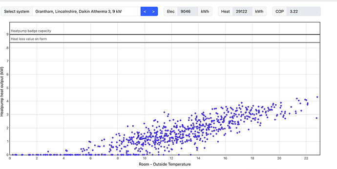

I have just looked at your data.
Apart from using EspAltherma (I assume?) I see no issues.
On what grounds do you think the heat pump should be replaced?
It heats your house adequately, the efficiency exceeds that required by the MCS and you haven’t had any really cold days yet.
You will not convince Octopus to swap on the basis that you could get a higher SCOP with a different heat pump.
