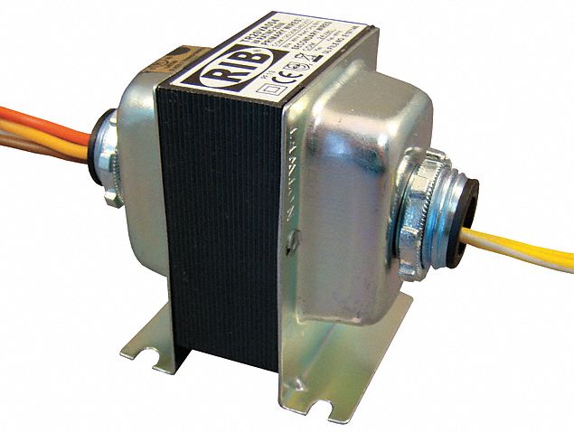

I am still not set on how to get 480 VAC in the US, connected in the circuit panel and brought out in a low AC voltage for the voltage sensing.
Hi Dave,
277 VAC to 24 VAC HVAC Control Transformers are readily available at reasonable cost. e.g.
or
Do you want 480 V, or 277 V? If you’re interested in the overall power, it doesn’t matter whether you use L-L voltage or L-N voltage. But if you’re treating each leg as a single-phase system, then you want the L-N voltage of 277 V, otherwise, you’ve got a nasty phase shift between current and voltage to make life difficult.

line voltage (line to neutral) would be 277VAC
phase to phase voltage on a 3-phase system would need to be 480
since one board would reference on voltage and ( I assume ) would act as if it were measuring a single phase, then the 277VAC transformer is perfect.

I could install a new box to house the 3 transformers and then have the output sent to the enclosure with the data monitoring.
I do like the idea of separate enclosures. or, possibly putting the transformers on the case of the load center (breaker panel) and keeping all the higher voltages separate from the lower voltages.

Where you put the transformers is really a matter of convenience. As long as the low voltage side is fused appropriately to protect the transformers against cable damage, the current draw is negligible so the wires can be long and thin with no ill effect. But beware of interference and pick-up, so you might want conduit or screened cable if it’s a long run and/or there are interfering sources close by.
