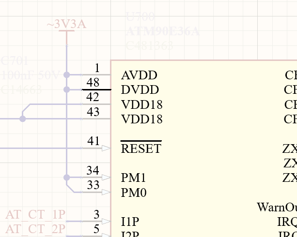

Hi, I am using this IC (ATM90E36A) in my Energy Meter Device. The device is attached to a 3P4W system , where an induction motor is connected. The chip works fine initially, i have an isolated smps for it along with a isolator on the communication line. However, I am facing a challenge these days where the VDD and GND of the IC gets shorted out internally and I am unable to find the reason till now.
In my Hardware, just by replacing the chip, the hardware starts working fine but again chip gets damage, sometimes after 1 day, sometimes 1 week.

Have you looked for application notes giving details of how to apply this i.c. in practical situations, particularly with regard to transient voltage suppression? This should be your starting point. You need to look particularly at how to protect the i.c. from high voltage spikes, because my suspicion is; when you switch the induction motor, an extremely high voltage spike is generated (I’m thinking maybe several kV) containing enough energy to get into the i.c. and destroy it.
Not knowing exactly what you are doing means I can’t speculate how the spike is getting in to the i.c., nor offer any more details about what you need to do, but from experience I’m reasonably certain this is the area where you need to look. Also check your SMPS supplying it, the spikes may well be getting through this.

After de-soldering the IC,I came to know only AVDD is short with Neutral, while DVDD is fine, no short. The datasheet says to connect both the pins AVDD and DVDD together thats why on the hardware, both were giving continuity with neutral
