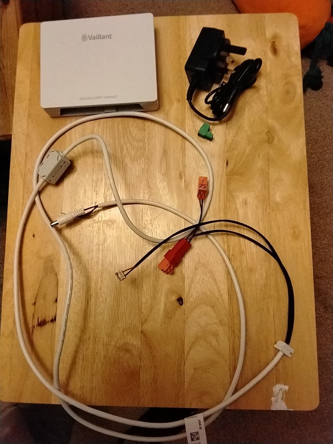

The gateway must be powered via a 5V DC adapter, or USB to DC barrel cable.
Thanks. It’s confusing as reading around i was led to believe i needed it. I have the gateway, DC power adaprer and cabl. They aren’t clear on hooking it up.
Not sure what the cable in your photo is for; it may be a way of powering the device via a 5V header inside the VWZ AI controller or VR 71 wiring centre? I’ve not seen one before.
My gateway is connected to an ebus header in my wiring centre using standard 2-core 1.5mm cable, with the gateway end terminated using the small green connector in your photo.
I understand now, this is what came with. What i need is where to buy the correct cable to connect the gateway to the bus connector. I’m finding vaillant really frustrating in this regard not making it easy to get the correct parts. Speaking to Vaillant tech support i need a cable that connects into the bus connector on the VWZ AI, and takes the bus input from the heatpump, and that connects to the gateway.

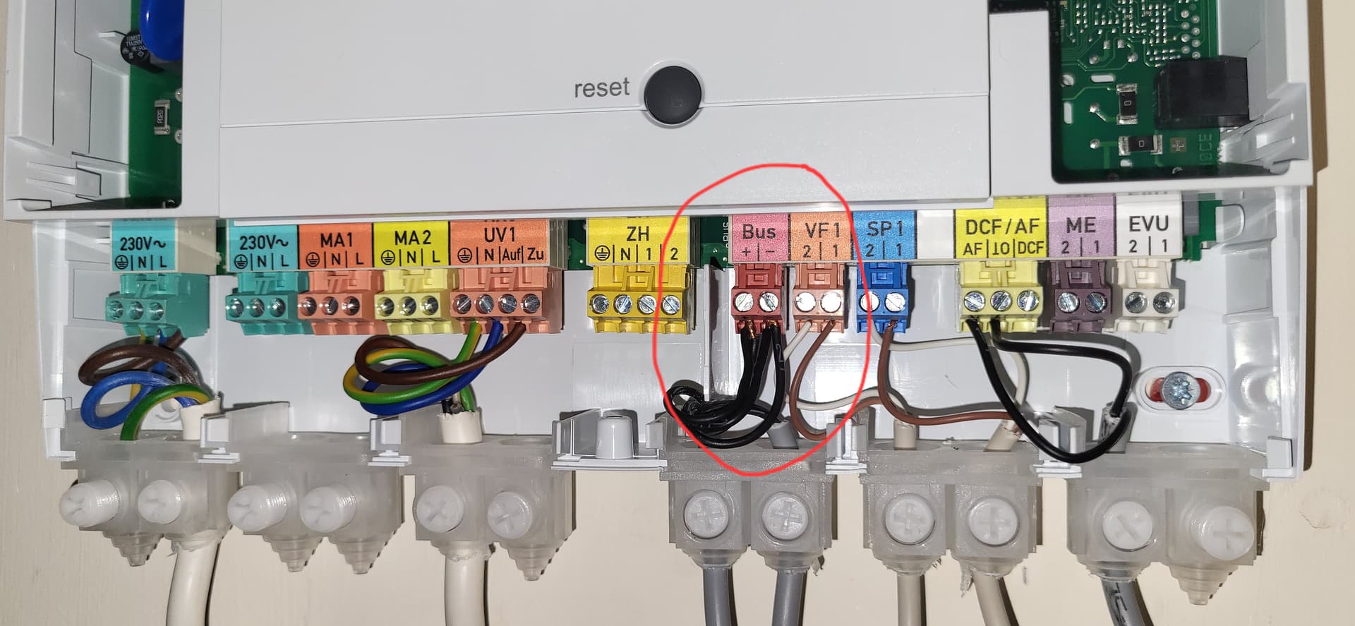

Going into the bus connector I have 2 off 2 core cables, 2 cores into positive, two cores into the negative. To connect my gateway i can just wire in my additional cores from the gateway cable into that? I don’t like doubling up on terminals, i think the tech support guy was suggesting there’s a splitter cable available to plug in from the gateway and the heatpump.
That photo is maybe old, but it shows VF1 still connected… (unless you have reconnected prior to engineer visit)
Old photo VF1 is disconnected now. So is it just a case of connecting the gateway cable cores into the same terminal block connected to ebus?
Yes, just connect it to the ebus terminal. I have a junction box on the wall where all units ebus cables are joined together. Polarity does not matter.
Sorry for double checking! Yes ebus line can be conntected anywhere you have ebus, either existing terminals or an external junction box
Cool, Wagos it is then. They will fit in the interface unit. Appreciated

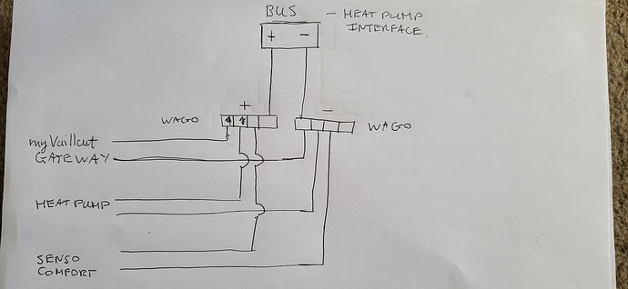

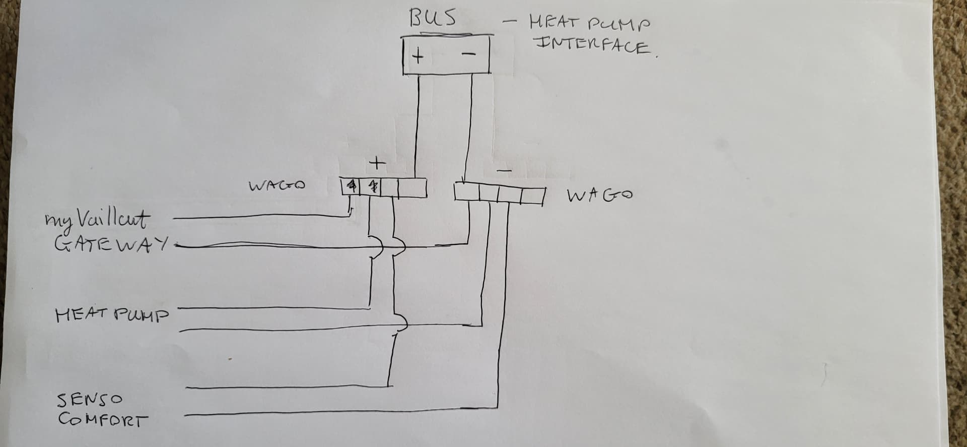

Just to check, this is how I’m going to wire it up.
Once my junction box and wagos arrive. Also will update after the Vaillant engineer has been in case anyone else has similar issues
Looking good!
